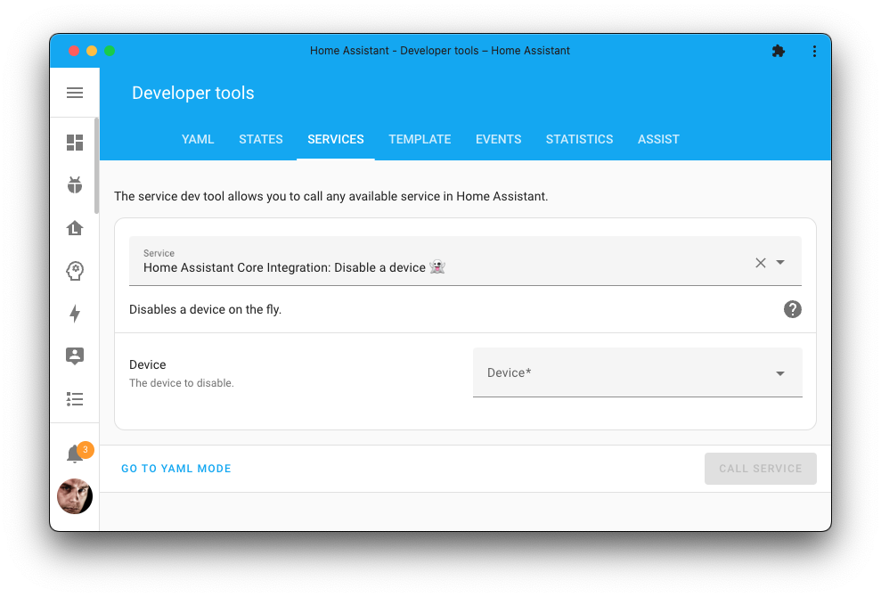

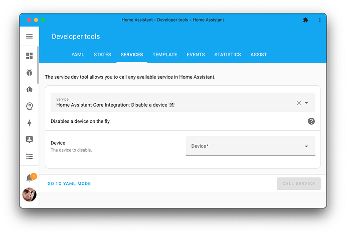

As for your actions, the third party integration Spook has actions to do this.
e.g.
actions:
  - action: homeassistant.disable_device
      device_id: "dc23e666e6100f184e642a0ac345d3eb"
  - delay: 1
  - action: homeassistant.enable_device
