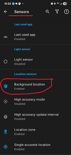

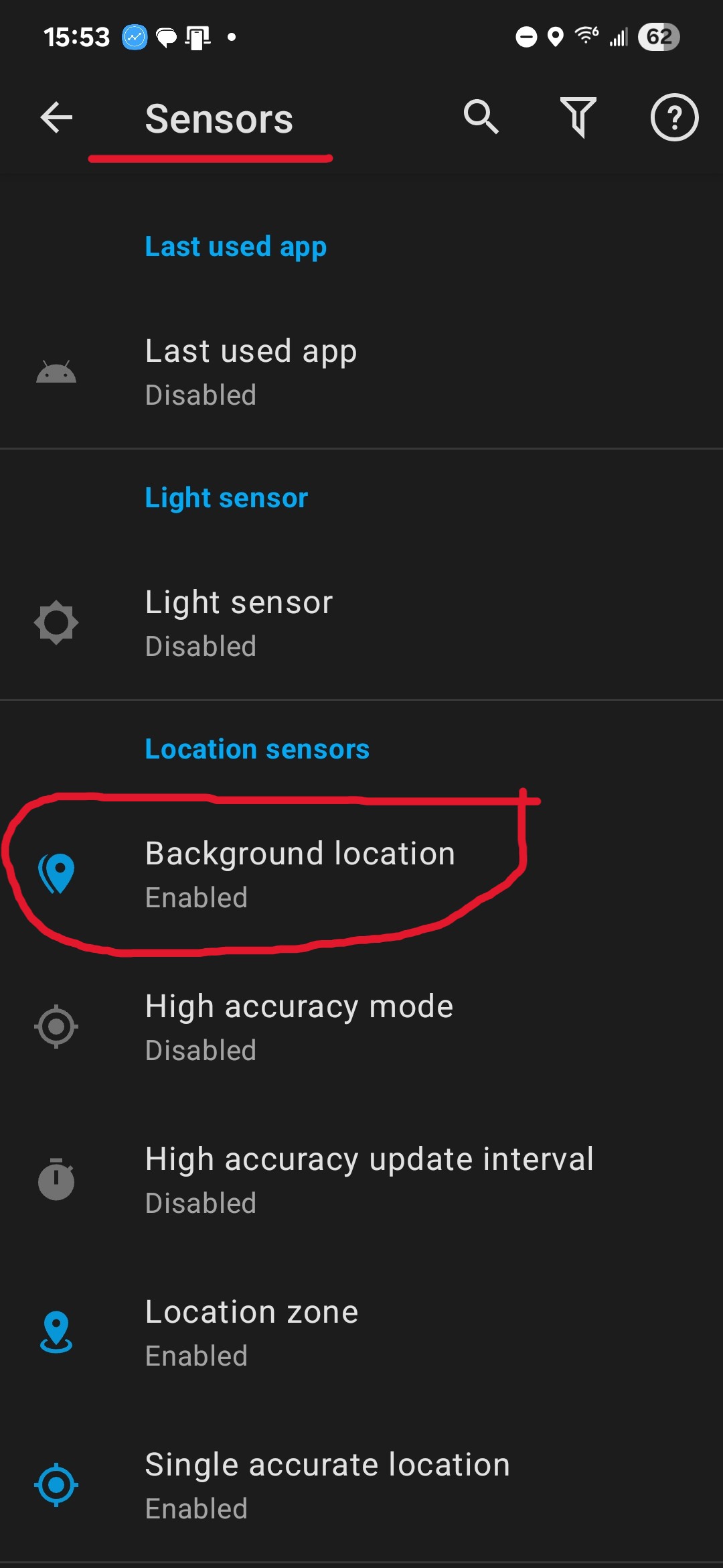

I also had a hard time to find it, but here it is on Android.
On the mobile app, Settings → Companion app → (Under Sensors) Manage Sensors → (Under Location sensors) Background location → At the bottom of the page there is an option called Location sent, tap on it and change to Zone name only.
Not available on iOS. Thanks.
