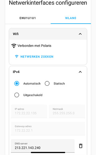

I have HA OS on a rpi3 installed and connected both with ethernet and wifi.
But I want to delete the wifi connection or remove the wifi details.
In the UI doesnt work an nmcli also doesnt work in the community ssl addon
