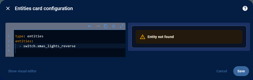

Then you have not disabled the entity correctly.
This is what I see in an entities card for a disabled entity:

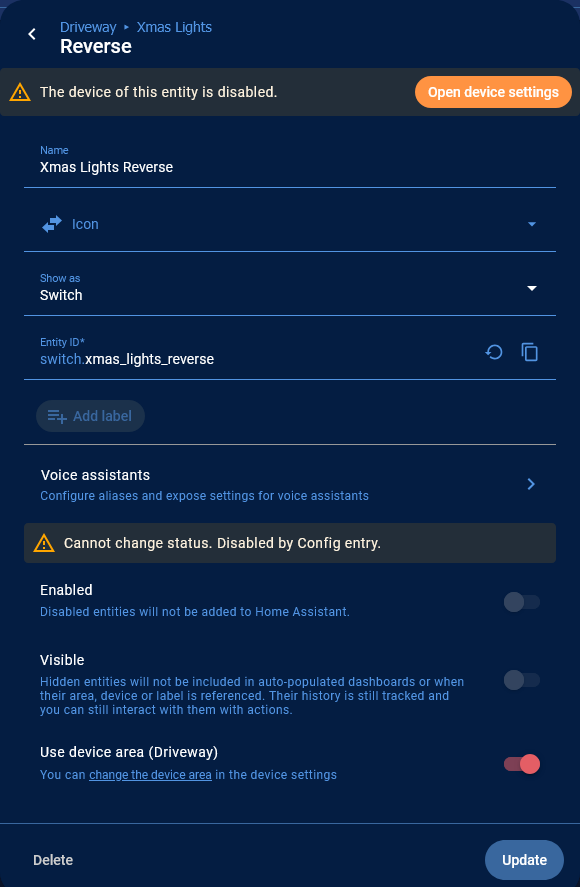

I have used switch on the entity card.
I cannot do it better.

It does not matter. It has always worked the way I have shown, for any domain, switch or otherwise.
If you are seeing anything other than what I have shown then you have not disabled the entity.
