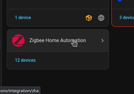

Remove the integration
Open your Home Assistant instance and show your integrations.

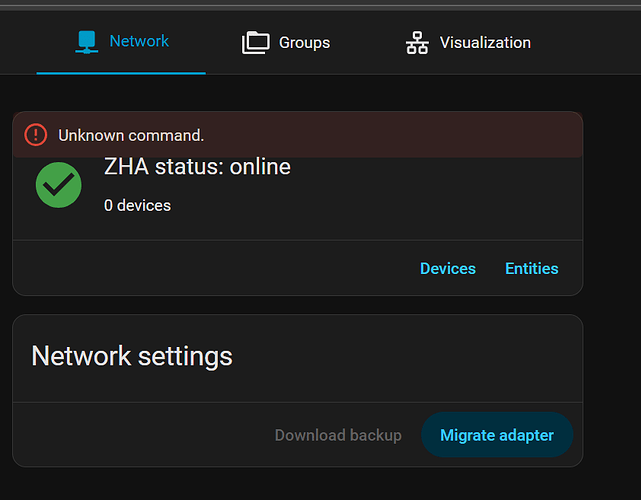

So it wasn’t there, I had it set to “ignore” in my settings. I enabled it again and deleted it. Still in the new settings area Zigbee appears, I thought Z2M isn’t compatible with it and it should be an indication that somehow ZHA is still there.

Still it’s very irritating to see ZHA as “online” without having it configured

I’m not 100% sure if it’s the exact same cause for you, but I recently dealt with this after migrating from ZHA to Z2M.
Even after deleting the integration, the ZHA icon wouldn’t disappear from my HA Settings.
It turns out I had some “ghost” configuration leftovers in my configuration.yaml file.
If you’re facing this, double-check your config for the zha: block:

The fix: Delete/comment the entire zha: block, save, and restart Home Assistant.
The icon should finally be gone!
Hope this helps!
THANKS, that did the trick :slight_smile:
So maybe the developers should think about an option to remove the configuration from the configuration.yaml when the ZHA integration is removed. Maybe after asking :wink:
