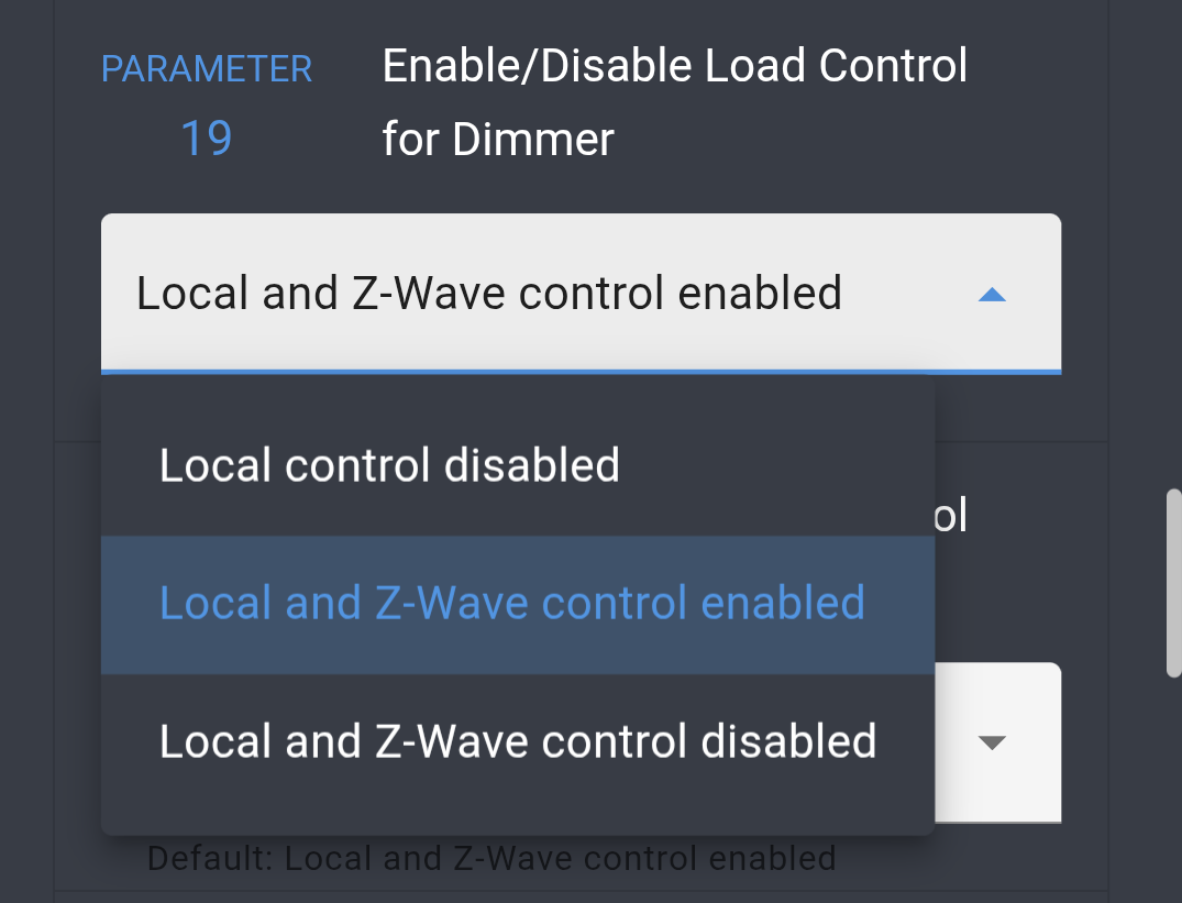

It’s a Zooz ZEN30 Z-Wave Plus S2 Double Switch.
Looks like it has it but Parameter 19
So how would i go about setting this up in hassio?
For example, how can i create an automation where the switch is disabled if my Denon avr is on?
media_player.denon_avr_x3800h is on.
How do i access this setting via code:
Ok i think I’ve found it:
