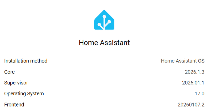

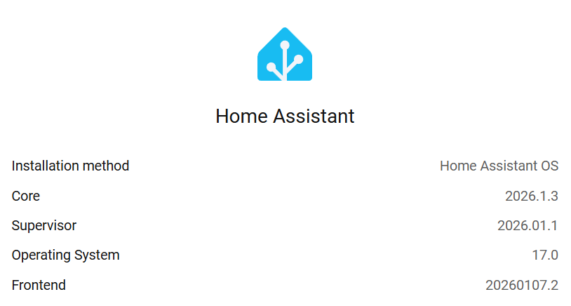

I forget to add the version numbers of my HA setup:
Thanks!
