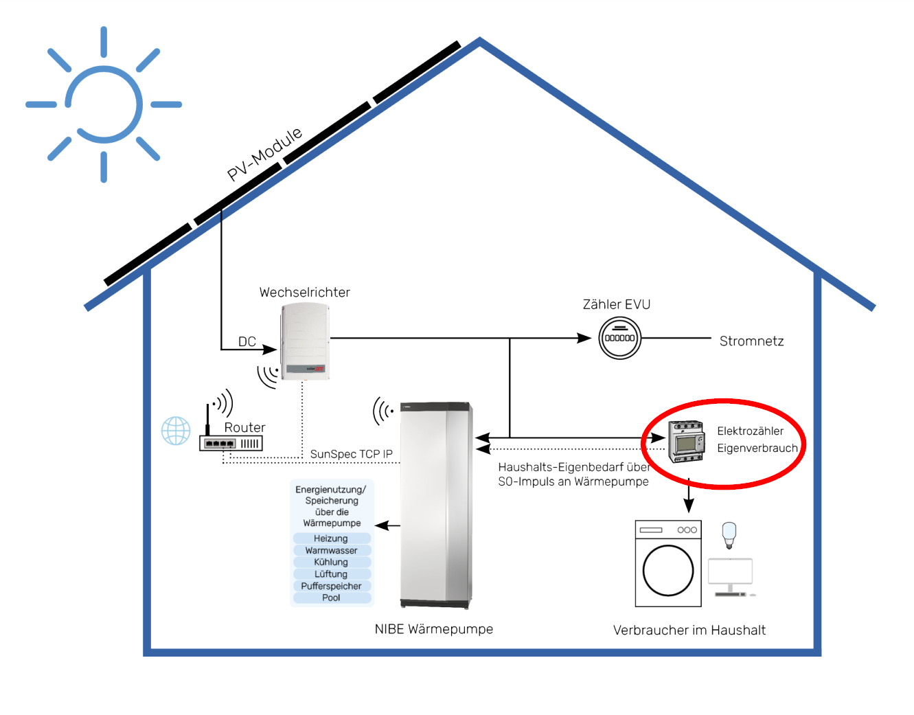

Hi, I have a SMA Smart Energy Inverter working with my NIBE S1255. The Heat pump gets the current solar production directly from the inverter and the grid feed via S0 from the grid meter. If there is more production than consumption the heating and hot water temperatures are raised.
There is documentation on how to do this on the German Nibe Homepage but I can’t seem to find it on the english page.
Installationshilfen PV Smart
I see there is also a separate application note for the solar edge inverter there.
I think these may be documents created by the German support team.

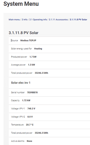

This seems to have worked perfectly. I just had to turn on modbus via the SolarEdge inverter. Thank you! :slight_smile: I don’t have a grid feed meter that I can connect to the S325 however it doesn’t seem to need one as I can see it using the solar power…unless it’s using the Load Monitor connected in BE1/2/3? I use Tibbers Pulse meter which communicates via WiFi. I wonder if I can get the S325 to read that via modbus…or maybe that isn’t even needed? I may have found an answer here: KNV S1155/S1255 Modbus TCP - erste Schritte - Seite 36 | Heizungstechnikforum auf energiesparhaus.at

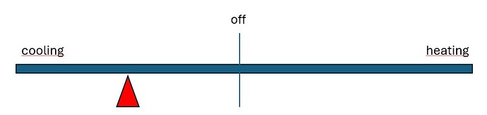

Hi everyone. I am looking for a visualisation where I can track the behavior of the Nibe heatpump. I am looking for a kind of bar indicating the level of warming - off - cooling and a pointer indicating the current situation. Similar to this visualisation. Does anybody came across such a dashboard element?

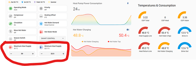

I can set the minimum supply temp and max supply temp as well as heating offset.
