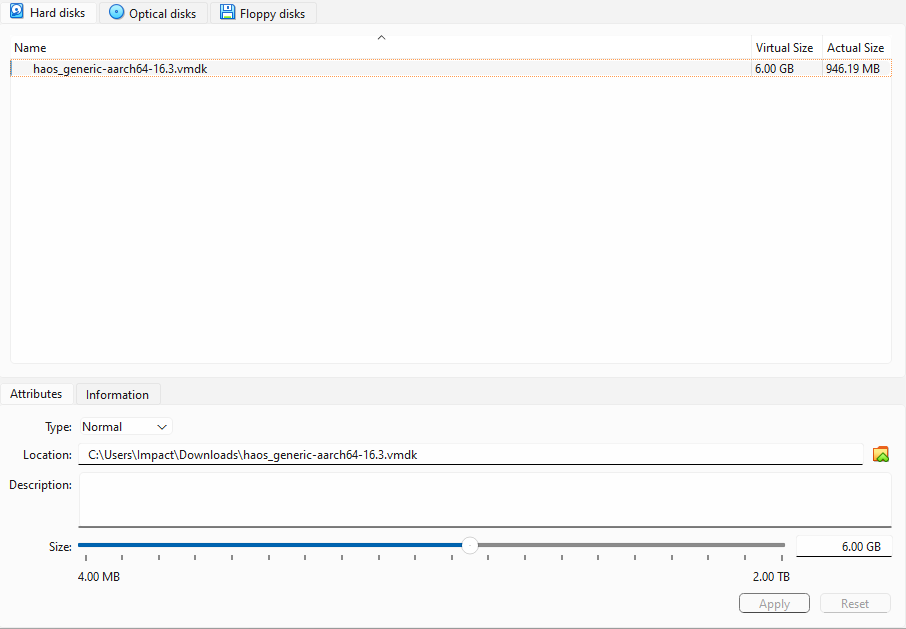

Virtualbox’s interface isn’t the most intuitive but here’s how it works.
Stop the VM and on the left side go to Media
Then go to Hard disks, select your disk and resize it at the bottom
HAOS will grow its partition and filesystem itself on boot.
