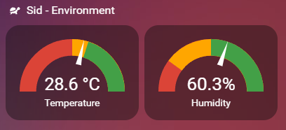

We have a vivarium with a Red Footed Tortoise. I currently use a temperature and humidity sensor to display a basic gauge as per the photo.
The tortoise has different temperature requirements for different times of day as follows:
  • Basking Area Temp 32-35 degrees celcius
  • Ambient/cool zone 24-29 degrees celcius
  • Nighttime Temperature 20-23 degrees celcius
The ambient/cool zone needs a seperate sensor as I’ve just realised, but how can I display the temperature range for different temperatures at night?
I also really dislike the design of the built-in colour scale as it has no gradient and looks too ‘in your face’. Is there a nicer design with a gradient colour scale I can use?

Sorry, just to add - humidity is always the same so this could be shown as a dual needle on one of the gauges maybe?

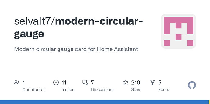

There are custom cards that allow gradients like:
These both allow stacking multiple arcs, so you could have basking, ambient, and or nightime combined in whatever way you want. I don’t know of any that allows templating the segment object. Your best best might be to use conditional cards to determine what is displayed at any given time.
