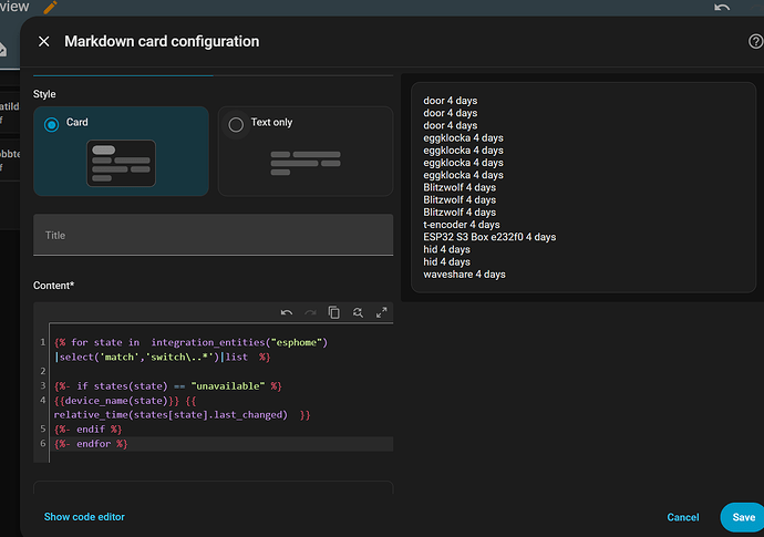

I use this card to figure out what ESL tags are offline in a markdown card.
Try it first in the template tools.
Not sure if the integration is called athom or not, I don’t have any such devices.
{% for state in  integration_entities("athom") |select('match','switch\..*')|list  %}
{%- if states(state) == "unavailable" %}
{{device_name(state)}} {{ relative_time(states[state].last_changed)  }}
{%- endif %}
{%- endfor %}
If it fails then just see if this is correct.
{{ integration_entities("athom") |select('match','switch\..*') | list }}
It should give you a list of all switches.

Thanks, after messing around for an hour, (I did not even know what a template was or that it existed) I realised that the integration name must be lower case ‘esphome’ not ‘ESPHome’. Do you have an example of how to use this in a card? Unfortunately the ‘Templates’ docs don’t mention cards, and the ‘Cards’ docs don’t seem to have a generic type that does not need an entity or similar, so I am having troubles combining them.
I tried a conditional card but just got errors. Note that I only have a basic understanding of the syntax, but anything you have might help.
Oh… so it’s ESP-Home devices.
Well just add a markdown card and add the template:

Thx, Markdown card worked like a charm. Think I’ll play around and see if I can make this more generic for all devices.
