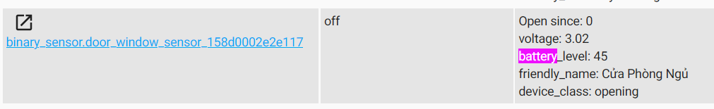

Display Xiaomi Zigbee door sensor battery level lovelace?
I try to use monster card to display the battery level. But it just show me the state of the door sensor only.
My code is:
      - type: custom:monster-card
        show_empty: false
        card:
          type: glance
          title: Batteries
        filter:
          include:
            - entity_id: binary_sensor.door_window_sensor_158d0002e2e117
              attributes:
                battery_level: "< 100"
Could someone show me something wrong here?
Thanks so much for reading.
