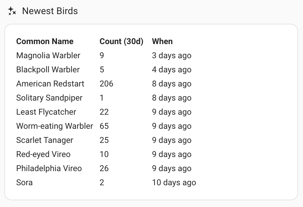

Has anyone managed to pull in data like # of unique species? And perhaps list last 10 unique species and date of detection or something, similarly to the markdown cards in the thread for daily detections?
Sure. I have one of those too.
I also have a filtered variant that shows only specific birds of interest, but I’ll likely post that one later as I’m trying to round up a bunch of the scripts, alerts, and cards I’ve made and include them all in a single blog post. I’m still dogfooding them before I share them out.
So this card I show above uses the /api/v2/analytics/species/summary api endpoint for your BirdNET-Go. It lists a summary of all unique species detected so far in your BirdNET-Go instance.
Make sure you’re using one of the latest nightlies for this one. As of right now, it works for Nightly Build 20250508. So this could change on earlier or later versions.
First you’ll need a new command_line sensor that fetches this data. I put mine in a command_line.yaml file, which is linked in my configuration.yaml. So my sensor looks like this:
- sensor:
    name: "BirdNET Species Summary"
    unique_id: "birdnet_species_summary"
    # Uses jq to check input type and provide a default empty list
    command: >
      curl -s 'http://<YOUR_BIRDNET_ENDPOINT>/api/v2/analytics/species/summary' |
      jq 'if type == "array" then {species_list: .} else {species_list: []} end'
    # Value_template calculates the number of species in the list
    value_template: >
      {% if value_json is defined and value_json.species_list is iterable and value_json.species_list is not string %}
        {{ value_json.species_list | length }}
      {% else %}
        0 {# Default to 0 if structure is unexpected #}
      {% endif %}
    unit_of_measurement: "species"
    json_attributes:
      - species_list
    scan_interval: 60 # Or adjust as needed
    command_timeout: 25
Also, I recommend ignoring this one with the recorder or you’re going to start getting warnings/errors since it’s a bit too large to store.
recorder:
  exclude:
    entities:
      - sensor.birdnet_species_summary
Next we’ll access is with this Markdown card. This is the whole raw markdown card:
type: markdown
content: "{% set species_data = state_attr('sensor.birdnet_species_summary', 'species_list') %} {% if species_data and species_data | count > 0 %}\nLatest Detections | &nbsp;&nbsp;&nbsp;When \n:-- | :-- {% for bird in (species_data | sort(attribute='last_heard', reverse=true))[0:11] %}\n  {%- set time = bird.last_heard -%}\n  {%- set name = bird.common_name -%}\n  {%- set species_code = bird.species_code %}\n  {%- set ebird_url = \"https://ebird.org/species/\" ~ species_code %}\n\_ {%- set last_heard_datetime = strptime(time, '%Y-%m-%d %H:%M:%S') %}\n[{{ name }}]({{ ebird_url }}) | &nbsp;&nbsp;&nbsp;{{ relative_time(last_heard_datetime) }} ago {% endfor %}\n{% else %} No recent bird data available. {% endif %}"
But this one is a bit easier to read if you paste it into the markdown content in the UI:
  {%- set ebird_url = "https://ebird.org/species/" ~ species_code %}
That’s pretty much it. Change the array numbers if you want more or less. I liked having it show the relative time on the card (making it easier to quickly know when that bird last appeared without needing to check the clock every time).

Last, a markdown card to go with the command_line sensor.
type: markdown
content: "{% set species_data = state_attr('sensor.birdnet_new_bird_detections_list', 'birds') %} {% if species_data and species_data | count > 0 %}\nCommon Name | &nbsp;&nbsp;Count (30d) | &nbsp;&nbsp;&nbsp;When \n:-- | :-- | :-- {% for bird in (species_data | sort(attribute='first_heard_date', reverse=true))[0:10] %}\n  {%- set time = bird.first_heard_date -%}\n  {%- set name = bird.common_name -%}\n  {%- set count = bird.count_in_period -%}\n\_ {%- set first_heard = strptime(time, '%Y-%m-%d') %}\n{{ name }} | &nbsp;&nbsp;{{count}} | &nbsp;&nbsp;&nbsp;{{ relative_time(first_heard) }} ago {% endfor %}\n{% else %} No recent bird data available. {% endif %}"
or if you want a more readable one, this is the yaml content of the markdown card:
Hehe. Thanks! Will read the blog post anyway. Will try it out!
Amazing, I’ve got it working, thanks so much. Looking forward to the blog post!
Can confirm that the new species automation in Displaying Birdnet-go detections - #84 by Kyle is working just fine.
