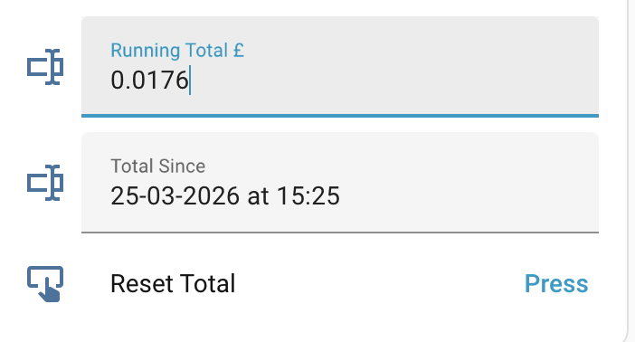

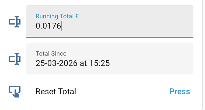

That works fantastic for the running total, thanks for that info.
Would it also show an input like my total since field or would that need to be two sensors??

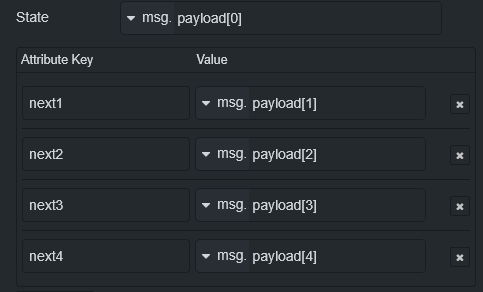

You can add attributes in the config of the sensor node. You will need to calculate the value and send it to the node in the message name.
Result

Does this help?
[{"id":"b7ae30e6226efbbd","type":"inject","z":"8e6ef4f6cbb13d83","name":"","props":[{"p":"payload"},{"p":"some_value","v":"200.65","vt":"num"},{"p":"some_name","v":"test run","vt":"str"}],"repeat":"","crontab":"","once":false,"onceDelay":0.1,"topic":"","payload":"10","payloadType":"num","x":840,"y":210,"wires":[["7ca92eaca84d6a41"]]},{"id":"7ca92eaca84d6a41","type":"ha-sensor","z":"8e6ef4f6cbb13d83","name":"","entityConfig":"578b426f39e767d6","version":0,"state":"payload","stateType":"msg","attributes":[{"property":"some_value","value":"some_value","valueType":"msg"},{"property":"some_name","value":"some_name","valueType":"msg"}],"inputOverride":"allow","outputProperties":[],"x":1040,"y":210,"wires":[[]]},{"id":"578b426f39e767d6","type":"ha-entity-config","server":"6b1110b5.183a4","deviceConfig":"","name":"another test","version":6,"entityType":"sensor","haConfig":[{"property":"name","value":"Another test"},{"property":"icon","value":""},{"property":"entity_picture","value":""},{"property":"entity_category","value":""},{"property":"device_class","value":""},{"property":"unit_of_measurement","value":""},{"property":"state_class","value":""}],"resend":true,"debugEnabled":false},{"id":"6b1110b5.183a4","type":"server","name":"Home Assistant","version":6,"addon":true,"rejectUnauthorizedCerts":true,"ha_boolean":["y","yes","true","on","home","open"],"connectionDelay":true,"cacheJson":true,"heartbeat":false,"heartbeatInterval":"30","areaSelector":"friendlyName","deviceSelector":"friendlyName","entitySelector":"id","statusSeparator":"at: ","statusYear":"hidden","statusMonth":"short","statusDay":"numeric","statusHourCycle":"h23","statusTimeFormat":"h:m","enableGlobalContextStore":true},{"id":"68710a2ef481b7c0","type":"global-config","env":[],"modules":{"node-red-contrib-home-assistant-websocket":"0.80.3"}}]

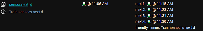

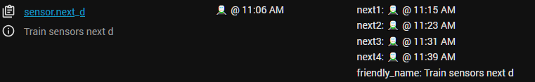

I have that set now but can’t figure out how I add the attributes to my HA dashboard?
I can get the main entity easily but the two extra attributes do not show up??

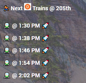

It will depend on the card. Some cards can display attributes. I use a markdown card but there are others.
  - type: markdown
    content: >-
      ##  🏃 Next ![Image](http://192.168.0.101:8123/local/dtrain25.jpg) Trains
      @ 205th
      ##  {{ states('sensor.next_d') }} 🚀
      ## {{ state_attr('sensor.next_d', 'next1') }} 🚀
      ## {{ state_attr('sensor.next_d', 'next2') }} 🚀
      ## {{ state_attr('sensor.next_d', 'next3') }} 🚀
      ## {{ state_attr('sensor.next_d', 'next4') }} 🚀
Gives me
Great, thanks
