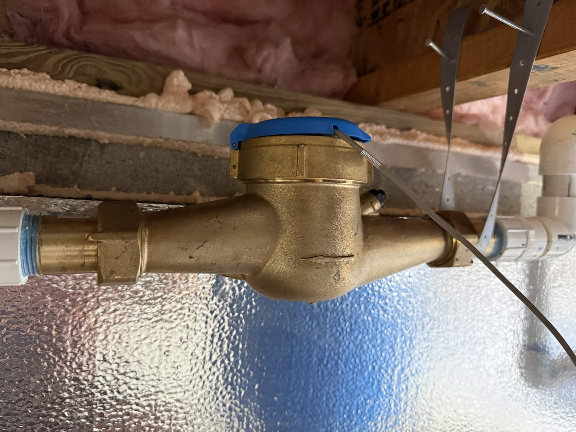

I put together a really simple and easy ESPHome setup using a pulse-output water meter DAE MJ-100a and a DS18B20 Digital Temperature Sensor Thread Probe

  • The MJ-100a is just a dry contact pulse output, so it wires straight into a GPIO + GND

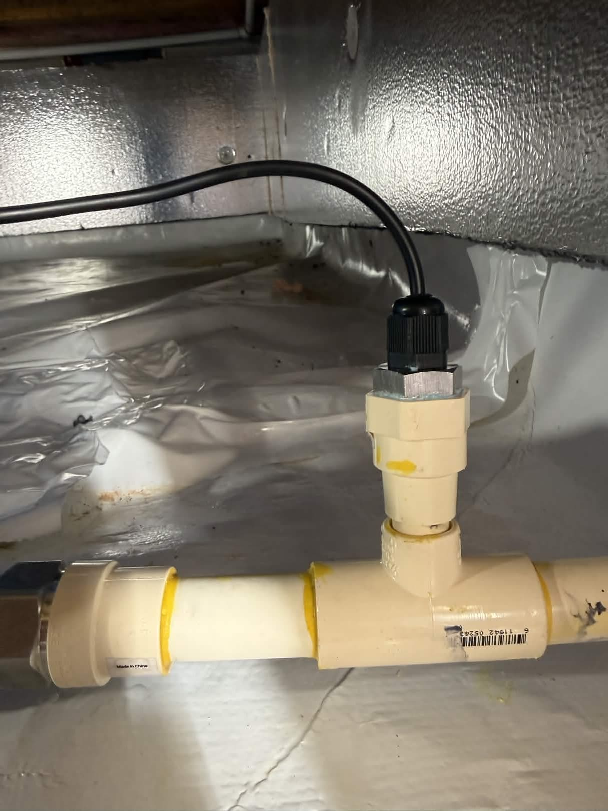

  • The DS18B20 is on GPIO42, mainly because it’s physically close to 3V3/GND on my board for putting a 4.7k resistor between the GPIO and 3V3

  • The MJ-100a I’m using outputs 1 pulse per 0.1 gallon, so everything is multiplied by 0.1

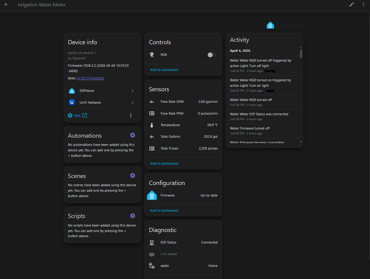

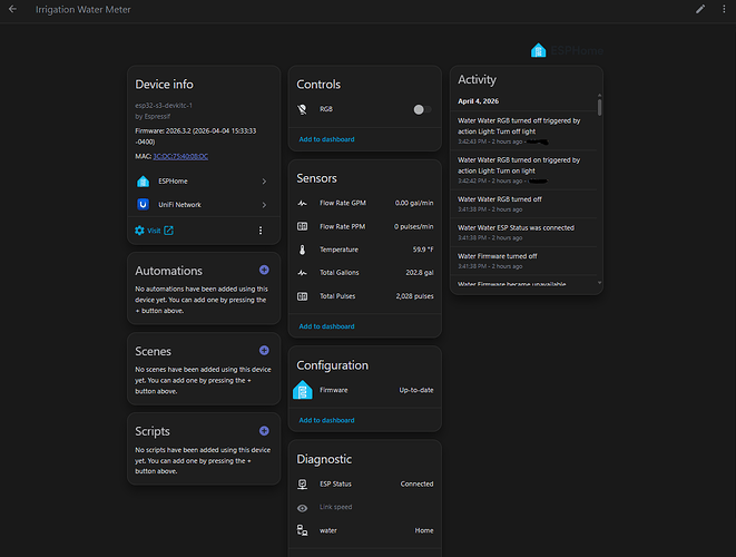

From this setup I now have:
  • Real-time flow rate (GPM)
  • Total gallons used
  • Raw pulse count (for verification/debugging)
  • Water temperature at the pipe
  • Daily / weekly / monthly irrigation usage (via utility_meter)
Which is way more visibility than I had before, especially for irrigation.
