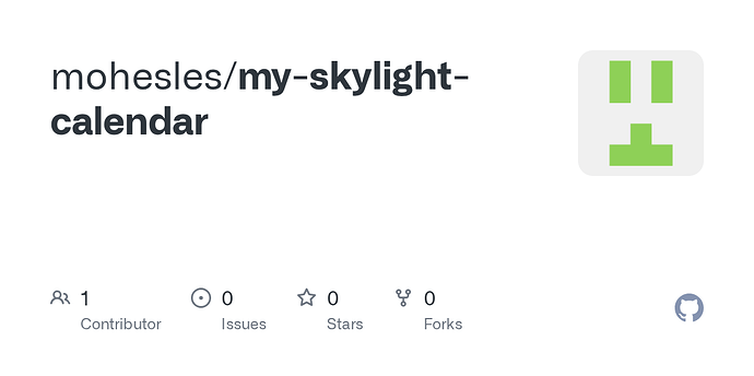

Its been 9 months can we please get a github repo of this? I’m having a lot of trouble getting the filters and creating events to work

wish granted
Sorry about the initial language. Hopefully the LLM generated description and steps available in the github repo make more sense

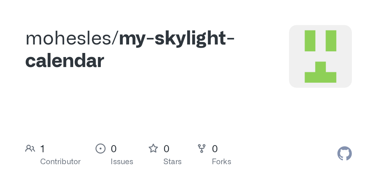

This is awesome but tried to follow your step by step in the GitHub post but ran into 2 issues
  1. there’s no homeassistant: in my configurration.yaml. I tried to create it with the packages line but get error “patternWarning”
  2. When trying to paste the dashboard.yaml into the editor I get “Unable to parse YAML: YAMLException: bad indentation of a mapping entry (3:3) 1 | views: 2 | - title: Home 3 | type: sections -------^ 4 | max_columns: 10 5 | title: Family Calendar”
Any help with these issues? I’m a beginner when it comes to yaml :frowning:
When you create a new dashboard, click the edit button, then the 3dot menu and choose Raw Configuration Editor.
That is where you paste that full yaml.
That’s what I did but didn’t work >_<. What you have in your github is everything that would be needed in the dashboard? I don’t have an option anymore to create a section dashboard unless I missed it.
Does your YAML for the newly created Dashboard still have views: at the very top before you paste the YAML provided? You need to maintain this for the provided code to work. If you look at your main dashboard’s YAML you should see this formatting present. I hope this helps!
Sounds like an issue with indentation. Make sure youre pasting at the right level.
In your dashboard, click on edit (pencil), then you shuld be able to see the views (tabs below the title). You want to paste the code at this level, so click add, or edit to open the “View configuration” popup; click the 3 dots at the top right, select edit in yaml and paste it at this level
