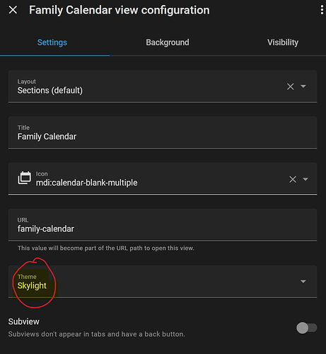

Is it possible to use the Skylight theme without theming my whole HA instance? I set the theme in the Dashboard view settings but that doesn’t have any effect:

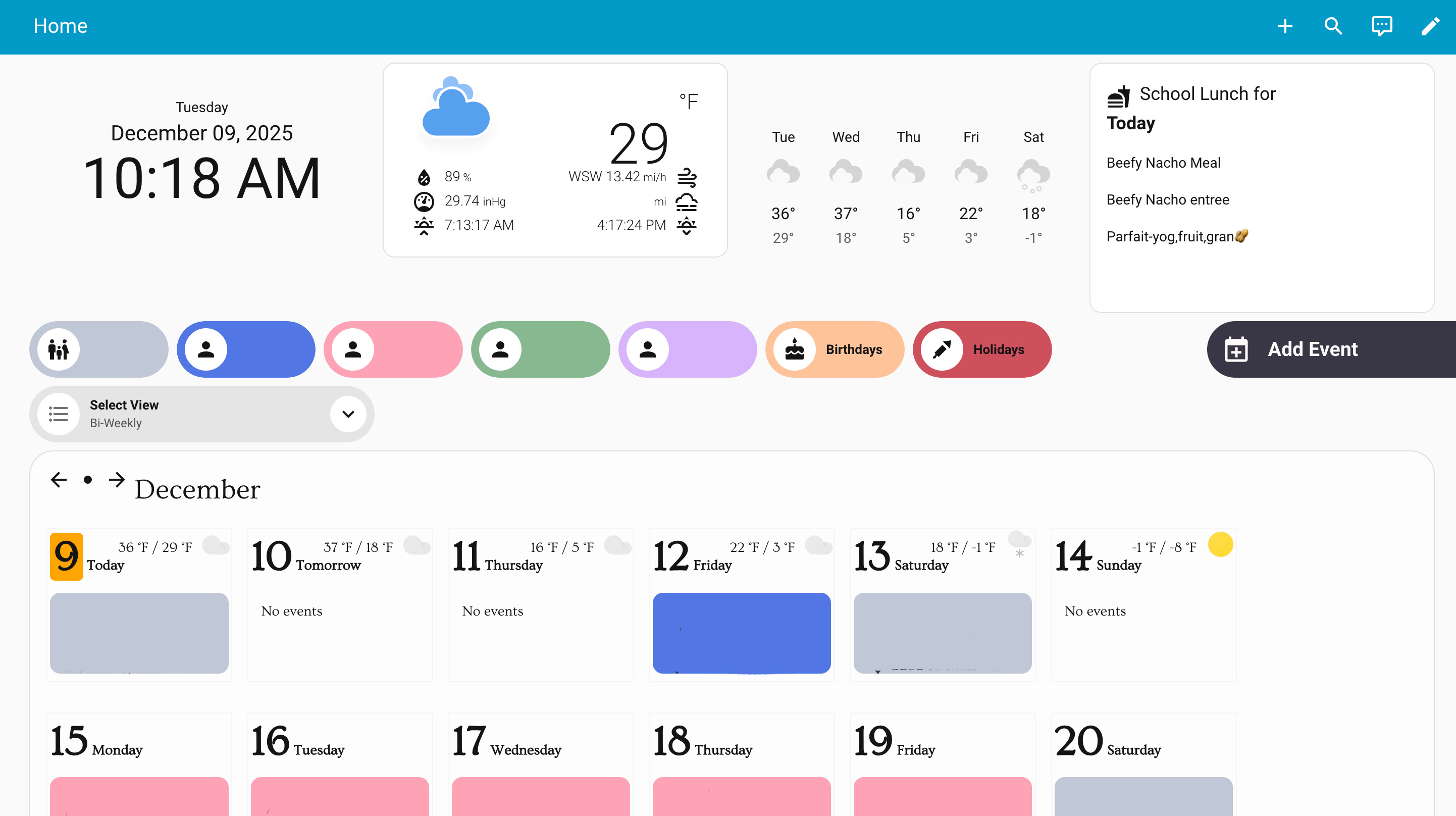

I am pretty happy with my look so far, thanks @mohesles1! However, it’s amazing to me that there is no action to delete or edit a calendar event. it is hard to make it easy to manage from the dashboard. Most of my calendars are google imports, I don’t know why we can’t edit/delete.
Does anyone have a solution for this?
As a suggestion, it would be nice to be able to scroll individual days with a lot of events, so that the calendar could be made to fit the screen and then the days would scroll instead of having to scroll the entire calendar. I tried for a while to figure out how to do this but couldn’t figure it out.
