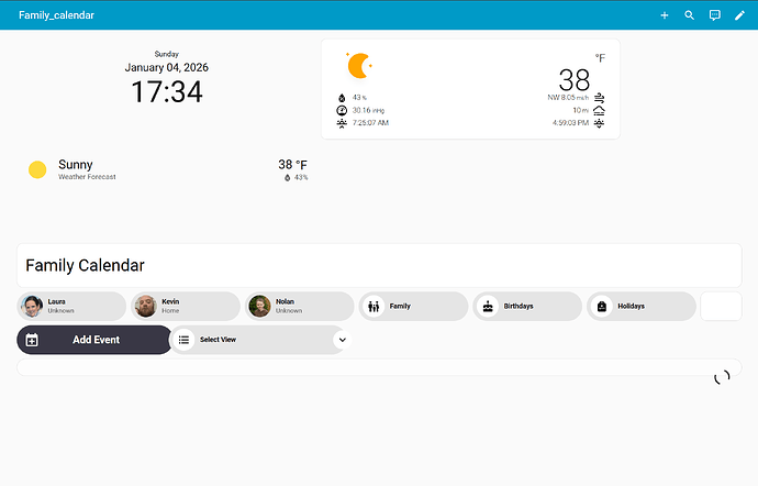

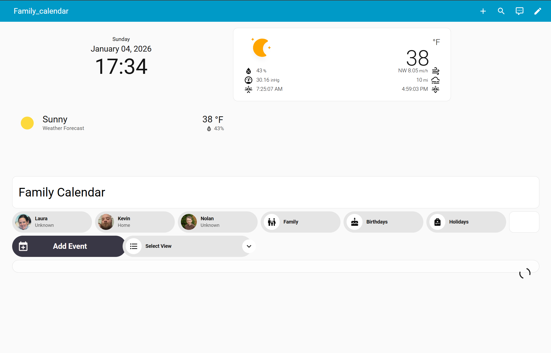

Really struggling to understand what I am doing wrong, here. I ended up just removing the whole logic for the dashboard for the weather display for each individual day because I could not find the entity that was incorrect for the weather, but even still, the buttons for selecting a calendar view don’t do anything so I’m only ever displaying a 3 day view, and even then, when Laura’s calendar shows that there is an event, nothing actually shows in the calendar view section.
I’d be happy to copy the code itself for my dashboard.yaml file, but I can’t locate the file on the server and the raw code from the page is over the text limit, so I’d have to private message it to anyone who is willing to help me fix it.

Yours is showing weather.owings. Assuming that is correct, without typos, I’m not sure what else to check.
Are all the calendar entities correct? I noticed that you changed the ALICAL, etc references so perhaps double-check all those. I left those alone since they don’t affect anything that gets displayed.
weather.owings is correct; that gets me the weather for my nearest National Weather Service data as shown in the top bar and I used a replace all function to replace weather.home in the dashboard.yaml with weather.owings to get that.
That said, maybe that part is part of the problem: I was doing more than necessary and replacing Alison with Laura, Bob with Kevin, Charlie with Nolan, and then all the references to Daisy, and I missed one or more references, thus the Entities errors when I see the add calendar events? Something to try for tomorrow.
Thanks for confirming. Will try going back and just starting back from scratch and editing the specific entities called out…

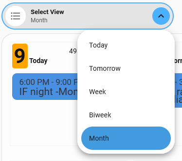

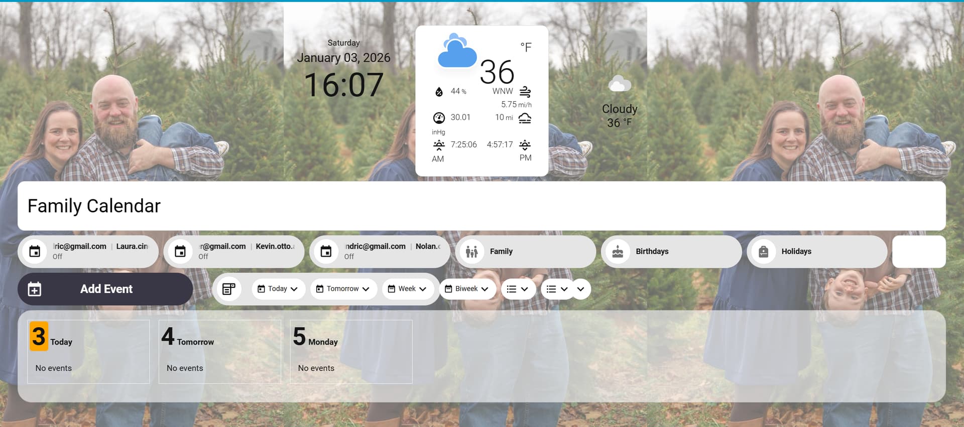

So, I did that like you suggested, but that still only shows me the 3 days, because something is still broken with respect to my calendar view buttons and I’m not sure what I’m doing wrong. It’s so frustrating that I’m tempted to just get rid of the family_calendar.yaml and the dashboard.yaml and start my own dashboard view from scratch, because I don’t understand what I’m seeing with most of this code from either of the yaml files.
What happens when you select different views in the dropdown? Still just 3 days? I assume you’ve cleared cache and everything. Share the latest screenshot of your dashboard.

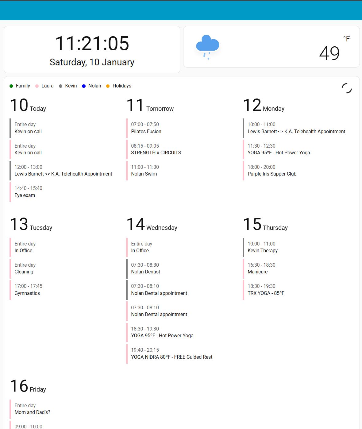

This is what it should look like and the quantity of days should respond accordingly:
Nothing displays in that view. What I ended up doing is trying to recreate the same kind of configuration (without much of the filtering and optional view changing options) in another, similar dashboard, and I was able to get the preview for one calendar to show for 7 days, but now I can’t figure out why I can’t get the data to show for all of the calendars.
