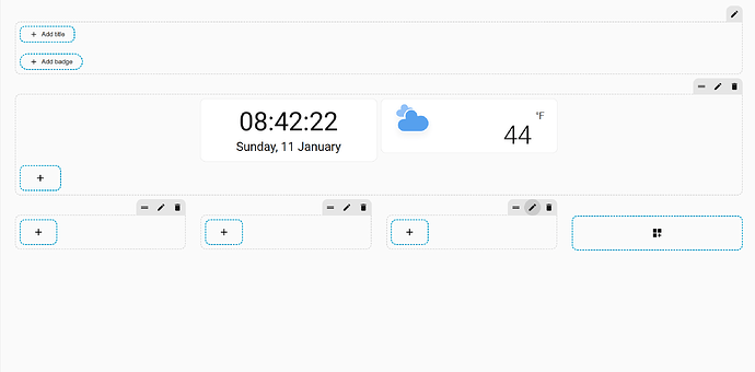

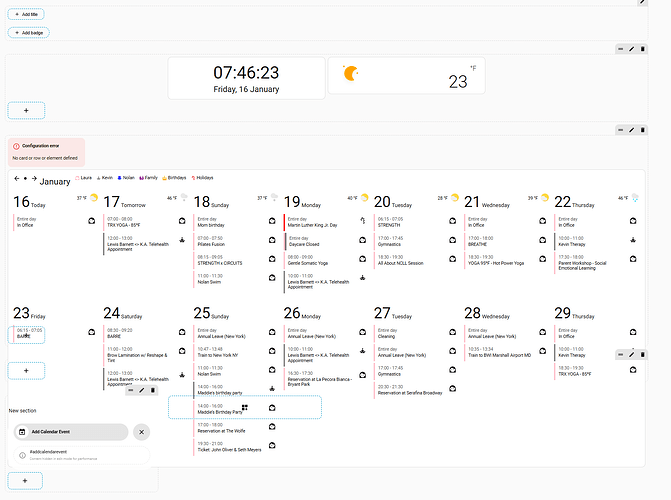

The only thing that I can think of is you need to edit family_calendar.yaml BEFORE you place it in the /packages folder and restart HA.
This file is what creates the text helpers and scripts which allow the different calendars to be filtered on and off. If you install this first, restart and then edit it, the helpers and scripts will be wrong.

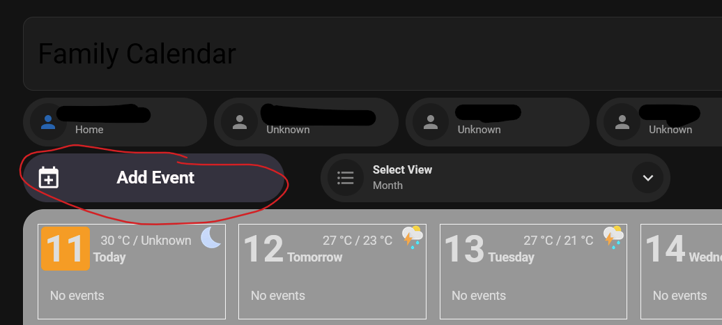

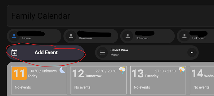

Your screen shot appears to be missing a big add event button that the family package has at the top, and the pop up option. One issue with manually copying and pasting eveything from the repo is you’re likely to end up missing something.

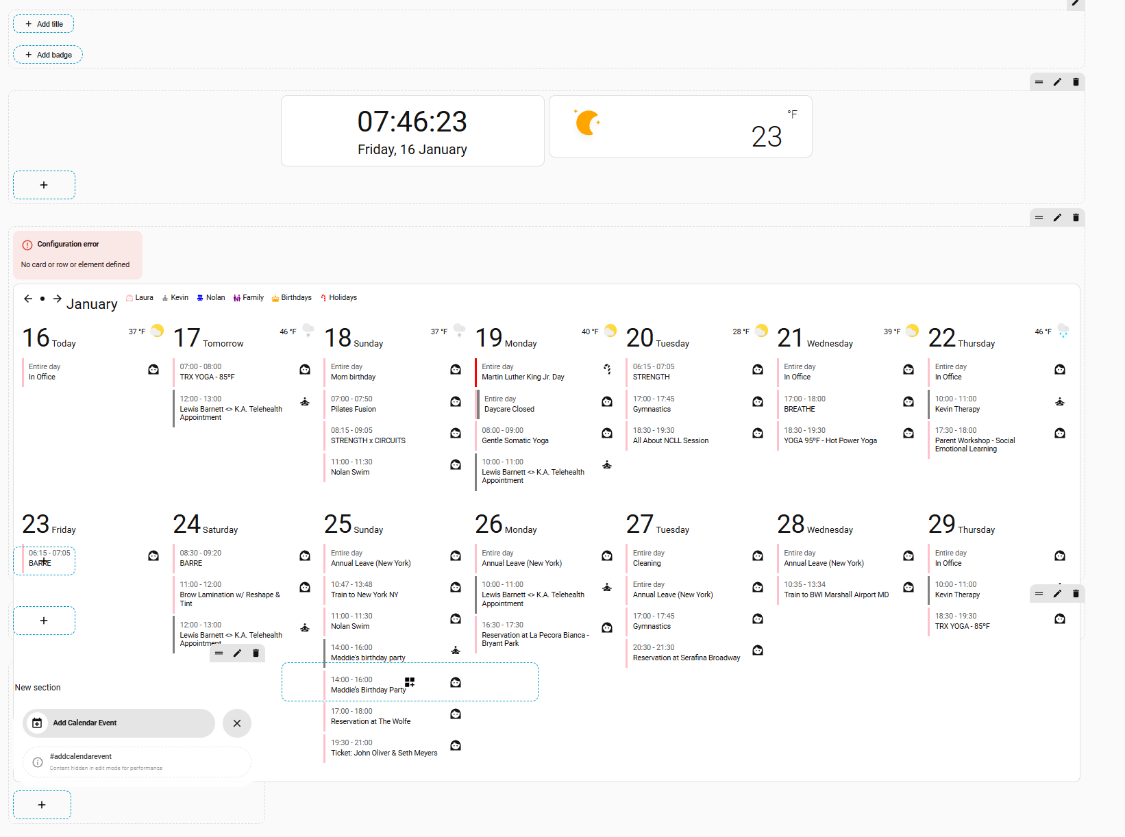

If you go to edit dashboard, is there some red box saying config error? You need the card mod, browser mod 2 and bubble card additions to your HA instance

That’s a good point. In the stock layout, it looks like this:
Ignore the dark theme, I just don’t use the Skylight theme on my desktop. This dashboard is destined for use on a wall-mounted tablet.
I built the dashboard from scratch by creating a card with the weekly planner card, and I didn’t do the add event buttons cards but I couldn’t figure out how to do the display for the events in the calendar to show correctly, so I went back and forth between doing this manually and copy pasting from my local file. Where I am now, I have tried copy-pasting the family_calendar helpers and scripts to a text file, modified it so I have every single reference to the people in Bob’s family to my family, including the names of the input filters, etc, and then I did the same thing for the dashboard, and copy-pasted the part that builds the calendar select view thing, AND the calendar, but both sections are completely blank, even in the preview.
If I could figure out the syntax for the helpers and the script(s) in the family_calendar.yaml that would allow me to progress further. Right now, my HA instance has no helpers at all, despite what I added via the family_calendar.yaml.

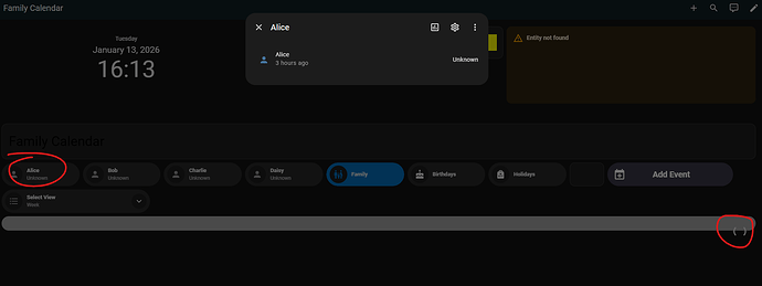

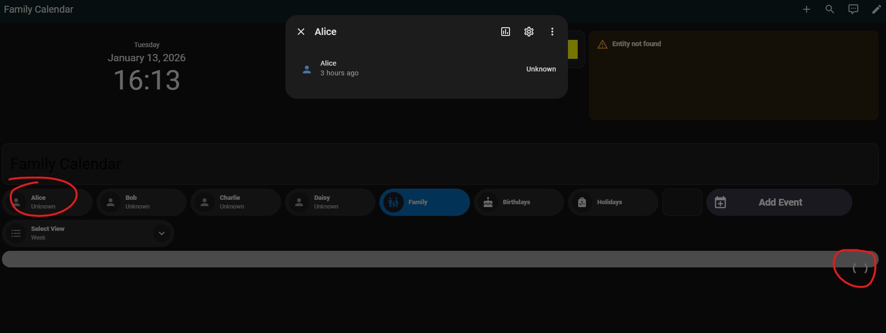

I do encounter two issues:
  1. The Calendar doesnt seems to be loading even though I had created individual local calendar for alice, bob, charlie and daisy.
  2. I created a new Person each for Alice and when I click on it, it shows unknown?
That spinning circle in the bottom right indicates that you possibly did not update all the weather entities. There is one in the calendar itself that you should check.
Oh my… thanks for this. I didn’t catch the one in Calendar itself.
Wow! Got it working!

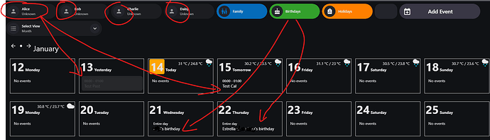

I am using Black background, need some advise on how to utilise Black Background for Skylight.
Once I changed the black background RGBA, the following don’t really display out.
Alice, Bob, Charlie, Daisy’s colour and events doesn’t seems to work.
Birthday button works but Birthday Events do not show the colour.

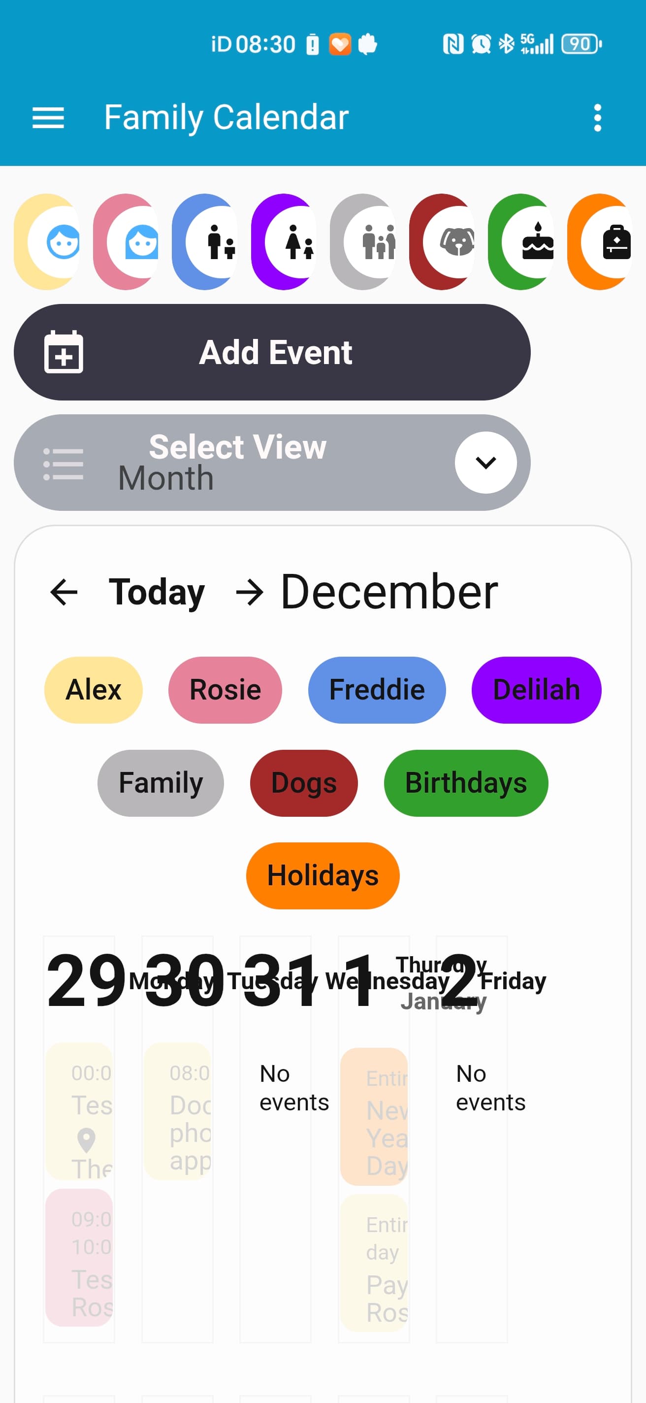

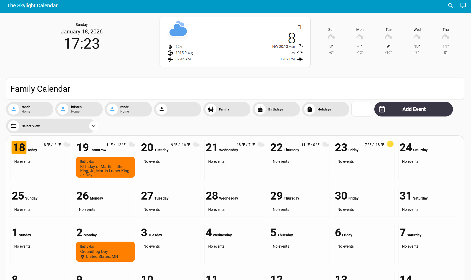

This is what my current view looks like for me; just in 50% view so you can see it in a single screenshot.

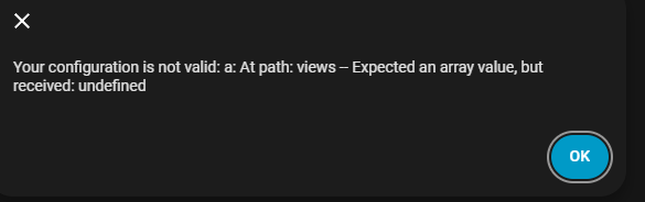

Am i only one where default dashboard.yaml dont work at all? it errors
I am usually good at this stuff but not having any luck here from first step :slight_smile:
I did get another version working but want to use one from github
Nope, this was the very first thing that I had going wrong. I forget what I had to do to fix it other than clearing the yaml from the section and removing the view piece from that section and then trying to readd the yaml configs for that section again without the view.
hows yours looking? can you share the working dashboard code? Mine is working but not code from github
Figuring it all out… seems documentation is somewhat outdated? indent everything in dashboard code and add this to top. title: My Skylight Calendar
views:
  • type: sections
    anyways will keep playing with it as this seems like a wonderful project! thanks to @mohesles1 if anyone has anymore documentation that would be great. here is where im at currently:
