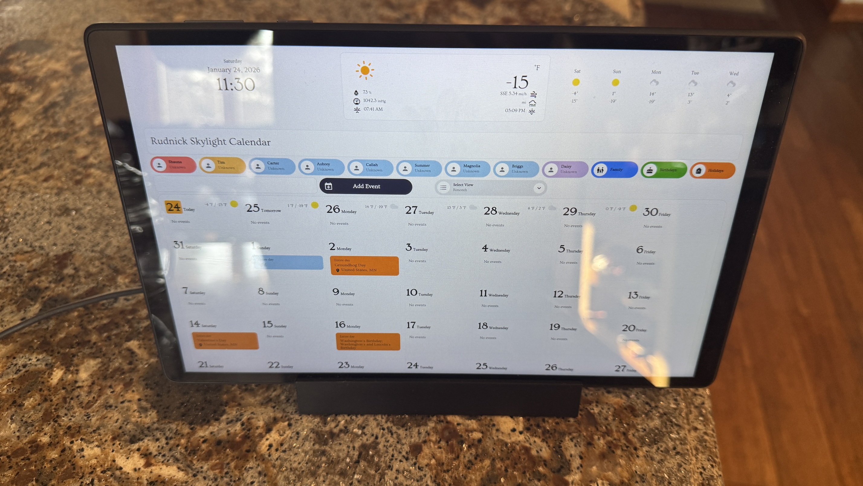

I’m just using 11” tablet for testing and works fine, but agreed bigger would be better

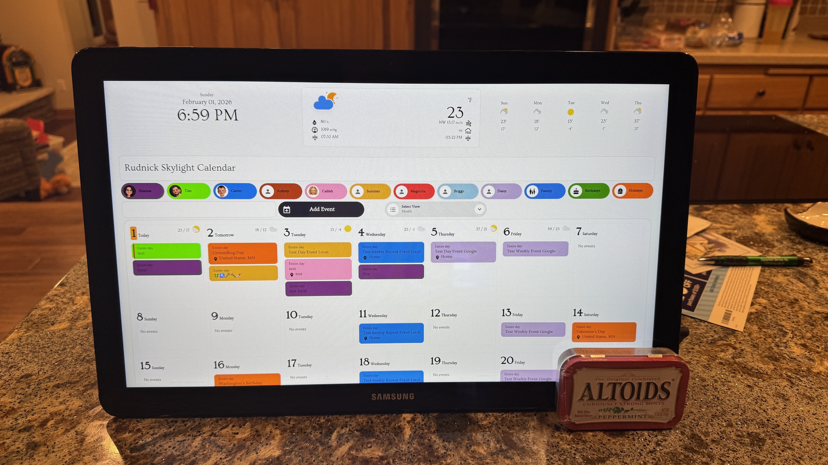

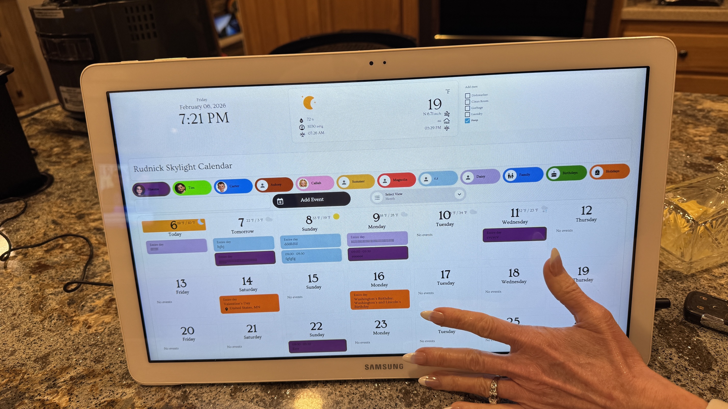

I got a sm-T670 with 18.4” screen for $150 installed lineage OS on it and works great. I got one in black and one in white for my daughters house.picture with altoids box for scale
Awesome, really nice work…Wife must be proud
Nice device! Can’t find it anywhere to buy. I found 24” touch but don’t know if these are supported by default with installation of android on pi4. Bit of a gamble to just buy tbh.
Which Android OS version is this? Or more importantly, which WebView or WebView2 version? I mean, Google say it was announced in 2015… so does it run everything you want it to run?
I installed custom os (Lineage 15.1)so it’s running current web view and yes it works fine for everything. front camera not working with lineageos but thats not a huge deal and i think i could get it working if i wanted to.
