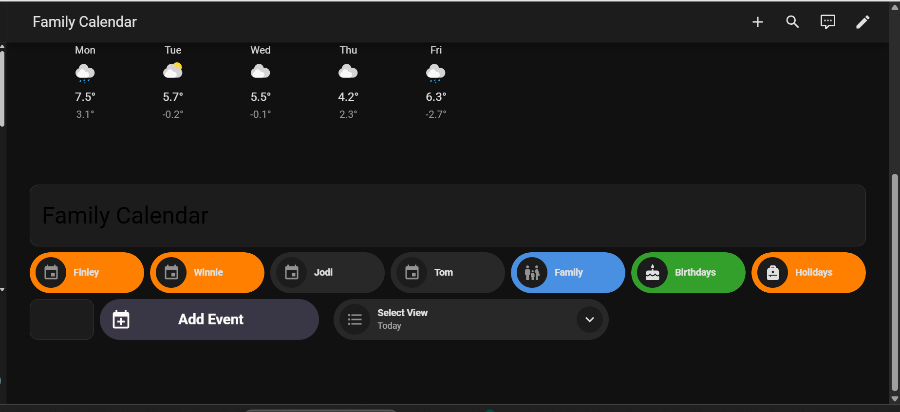

Hi
Can anyone help me I’m pulling my hair out.
This is my dashboard code but i cannot see the actual weeks planner section.
I’ve tried all sorts but keep getting to a dead end. I’ve even tried gemeni to help me out but no luck
views:
  - type: sections
    max_columns: 10
    title: Family Calendar
    path: family-calendar
    theme: Skylight
    sections:
      - type: grid
        cards:
          - type: custom:better-moment-card
            parentStyle: |
              line-height:normal;
            moment:
              - parentStyle: |
                  font-size:1em; text-align:center; margin-top:5px;
                templateRaw: |
                  {{moment format=cccc}}
              - parentStyle: |
                  font-size:1.5em; text-align:center; margin-top:5px;
                templateRaw: |
                  {{moment format=LLLL dd, yyyy}}
              - parentStyle: |
                  font-size:4em;  text-align:center; font-weight:400;
                templateRaw: |
                  {{moment format=HH:mm}}
            grid_options:
              columns: 20
            card_mod:
              style: |
                ha-card {
                  background: transparent !important;
                  box-shadow: none !important;
                  border: none !important;
          - type: custom:weather-card
            entity: weather.forecast_home
            current: true
            details: true
            forecast: false
            grid_options:
              columns: 20
              rows: 3
          - type: weather-forecast
            show_current: false
            show_forecast: true
            forecast_type: daily
            grid_options:
              columns: 20
              rows: 3
            card_mod:
              style: |
                ha-card {
        column_span: 10
      - type: grid
        cards:
          - type: vertical-stack
            cards:
              - type: markdown
                content: ' '
                card_mod:
                  style: >
                    ha-card { background: none; box-shadow: none; border: none;
                grid_options:
                  columns: 18
                  rows: auto
            grid_options:
              columns: 120
              rows: auto
            cards:
              - type: markdown
                content: <font color="Black" size="6">Family Calendar</font>
                grid_options:
                  columns: 18
                  rows: auto
            grid_options:
              columns: 120
              rows: auto
          - type: horizontal-stack
            cards:
              - type: custom:bubble-card
                card_type: button
                button_type: name
                entity: calendar.finley
                show_icon: true
                show_name: true
                tap_action:
                  action: perform-action
                  perform_action: script.calendar1_calendar_visible_filter
                styles: |
                  .bubble-button-background {
                    opacity: 1 !important;
                    background-color: ${hass.states['input_text.calendar1_calendar_filter'].state === '.*' ? 'light-grey' : '#ff7f00'} !important;
                sub_button:
                  main: []
                  bottom: []
                slider_fill_orientation: left
                slider_value_position: right
                card_type: button
                button_type: name
                entity: calendar.winnie
                show_icon: true
                show_name: true
                tap_action:
                  perform_action: script.calendar2_calendar_visible_filter
                styles: |
                    background-color: ${hass.states['input_text.calendar2_calendar_filter'].state === '.*' ? 'light-grey' : '#ff7f00'} !important;
                sub_button:
                  main: []
                  bottom: []
                card_type: button
                button_type: name
                entity: calendar.jodi
                show_icon: true
                show_name: true
                tap_action:
                  perform_action: script.calendar3_calendar_visible_filter
                  target: {}
                styles: |
                    background-color: ${hass.states['input_text.calendar4_calendar_filter'].state === '.*' ? 'light-grey' : 'var(--calendar4-default-primary-color)'} !important;
                sub_button:
                  main: []
                  bottom: []
                card_type: button
                button_type: name
                entity: calendar.tom
                show_icon: true
                show_name: true
                tap_action:
                  perform_action: script.calendar4_calendar_visible_filter
                styles: |
                sub_button:
                  main: []
                  bottom: []
                card_type: button
                button_type: switch
                icon: mdi:human-male-female-child
                show_icon: true
                show_name: true
                tap_action:
                  perform_action: script.family_calendar_visible_filter
                styles: |
                    background-color: ${hass.states['input_text.family_calendar_filter'].state === '.*' ? 'light-grey' : '#4A90E2'} !important;
                entity: input_boolean.family_calendar_show
                card_type: button
                button_type: name
                icon: mdi:cake-variant
                show_icon: true
                show_name: true
                tap_action:
                  perform_action: script.birthdays_calendar_visible_filter
                styles: |
                    background-color: ${hass.states['input_text.birthdays_calendar_filter'].state === '.*' ? 'light-grey' : '#33a02c'} !important;
                card_type: button
                button_type: name
                icon: mdi:bag-personal
                show_icon: true
                show_name: true
                tap_action:
                  perform_action: script.holidays_calendar_visible_filter
                styles: |
                    background-color: ${hass.states['input_text.holidays_calendar_filter'].state === '.*' ? 'light-grey' : '#ff7f00'} !important;
                sub_button:
                  main: []
                  bottom: []
            grid_options:
              columns: 45
              rows: auto
          - type: markdown
            content: ' '
            grid_options:
              columns: 3
              rows: auto
            card_type: button
            button_type: name
            card_layout: large
            icon: mdi:calendar-plus
            tap_action:
              action: navigate
              navigation_path: '#addcalendarevent'
            styles: >
              * { font-size: 1.05em !important; }
              ha-card { --bubble-main-background-color: #393745 !important;
              width: 300px; }
              .bubble-icon { --mdc-icon-size: 30px !important; color: snow
              !important; opacity: 1; }
              .bubble-icon-container { background: #393745 !important; display:
              flex; }
              .bubble-name { color: snow !important; opacity: 1; display: flex;
              line-height: 18px; flex-direction: row; justify-content: center;
              flex-grow: 1; margin: 0 40px 0 0; pointer-events: none; position:
              relative; overflow: hidden; }
            grid_options:
              columns: 10
              rows: 1
            card_type: select
            entity: input_select.calendar_view
            show_name: true
            show_state: true
            show_last_changed: false
            show_attribute: false
        column_span: 10
      - type: grid
        cards:
          - type: custom:config-template-card
            entities:
              - input_text.calendar1_calendar_filter
              - input_text.calendar2_calendar_filter
              - input_text.calendar3_calendar_filter
              - input_text.calendar4_calendar_filter
              - input_text.family_calendar_filter
              - input_text.holidays_calendar_filter
              - input_text.birthdays_calendar_filter
              - input_select.calendar_view
            variables:
              CAL1CAL: states['input_text.calendar1_calendar_filter']?.state
              CAL2CAL: states['input_text.calendar2_calendar_filter']?.state
              CAL3CAL: states['input_text.calendar3_calendar_filter']?.state
              CAL4CAL: states['input_text.calendar4_calendar_filter']?.state
              FAMCAL: states['input_text.family_calendar_filter']?.state
              HOLCAL: states['input_text.holidays_calendar_filter']?.state
              BIRCAL: states['input_text.birthdays_calendar_filter']?.state
              VIEW: states['input_select.calendar_view']?.state
              STARTDAY: |
                  const calendarView = states['input_select.calendar_view']?.state;
                  if (calendarView === 'Today') return 'today';
                  if (calendarView === 'Tomorrow') return 'tomorrow';
                  // Fallback
                  return 'monday'; # <--- UPDATE THIS IF NEEDED, valid values are: monday, tuesday, wednesday, thursday, friday, saturday, sunday
              DAYS: |
                  if (calendarView === 'Today') return 1;
                  if (calendarView === 'Tomorrow') return 2;
                  if (calendarView === 'Week') return 7;
                  if (calendarView === 'Biweek') return 14;
                  // else return "month"
                  return "month";
            card:
              type: custom:week-planner-card
              calendars:
                - entity: calendar.calendar1
                  color: var(--calendar1-default-primary-color)
                  filter: ${ CAL1CAL }
                - entity: calendar.calendar2
                  color: var(--calendar2-default-primary-color)
                  filter: ${ CAL2CAL }
                - entity: calendar.calendar3
                  color: var(--calendar3-default-primary-color)

This is what I see
Im just trying to get everything fixed before i worry about sizing and themes
THanks
Replace this line
with this and it will start working
return 'monday'; // <--- UPDATE THIS IF NEEDED, valid values are: monday, tuesday, wednesday, thursday, friday, saturday, sunday
Omg a8t last why is that soncomplex
Now I just have a dam spinning circle
Any ideas
