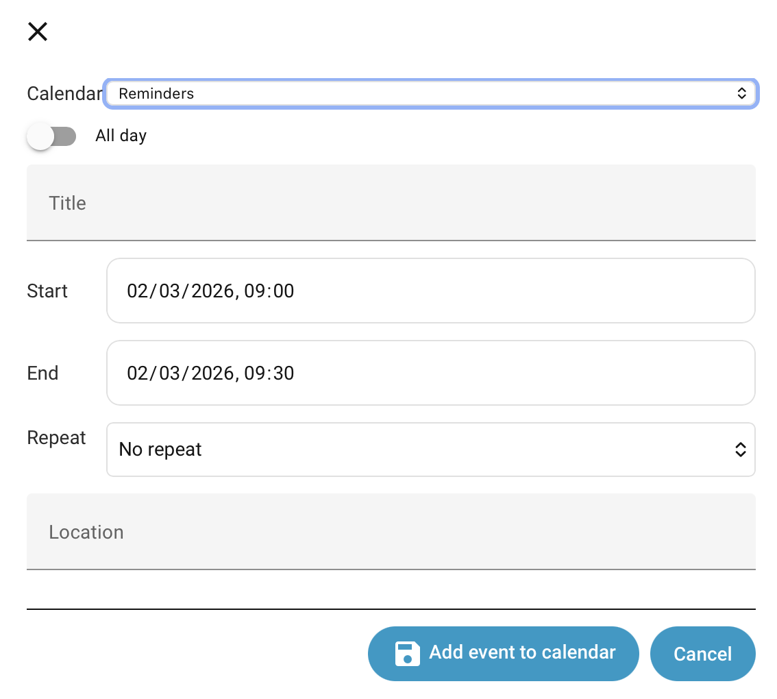

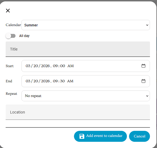

@randr Thanks for the “plus” model of the calendar. Used HAC’s and added “-plus” to the end of the template in my dashboard and 2 new lines of config later and its all working smoothly.
Took about 5 minutes tops, very nice.
Couple of things I wondered if you could help with though please? And apologies if I missed it, but I dont think it was covered elsewhere in this thread:
  1. Is it possible to edit the style sheet of the popup prompt for adding calendar events. For some reason the very top element “Calendar” both the title and the drop down seem very slim compared to the other fields
  2. Is it possible to remove the “edit” element from the pop up that appears when you click on an existing event. I only ask because im using google calendars and it doesnt allow it, and then brings up an error.
Many thanks in advance

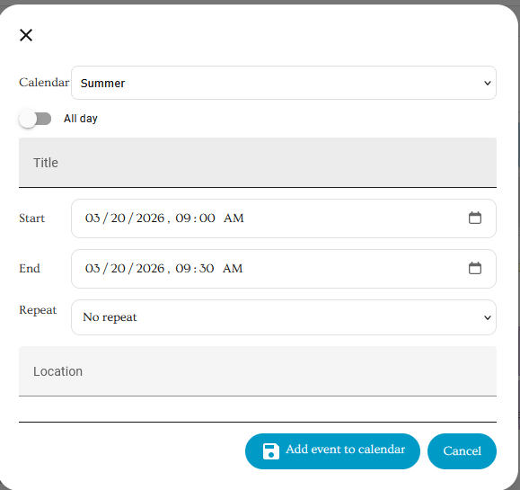

I’ll check but mine is fine. Maybe some update changed it? I will look and report back. As for the edit I know it don’t work on Google but it should warn you and we all know it works for local. I’ll see if I can remove it when you click Google event that should be doable

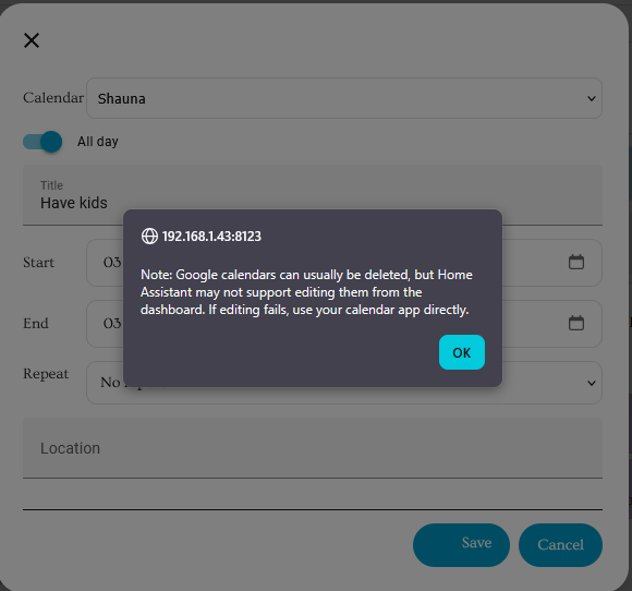

not seeing issues here and do you not get this warning clicking edit on google event?
I reloaded HA and the pop up warning is now appearing and the drop down calendar box appears to be the same as the others now.
Reboot for the win…after 18 years in IT you think I’d have tried that first face/palm
Next up, I’m going to try the chores package!
Thanks for checking though

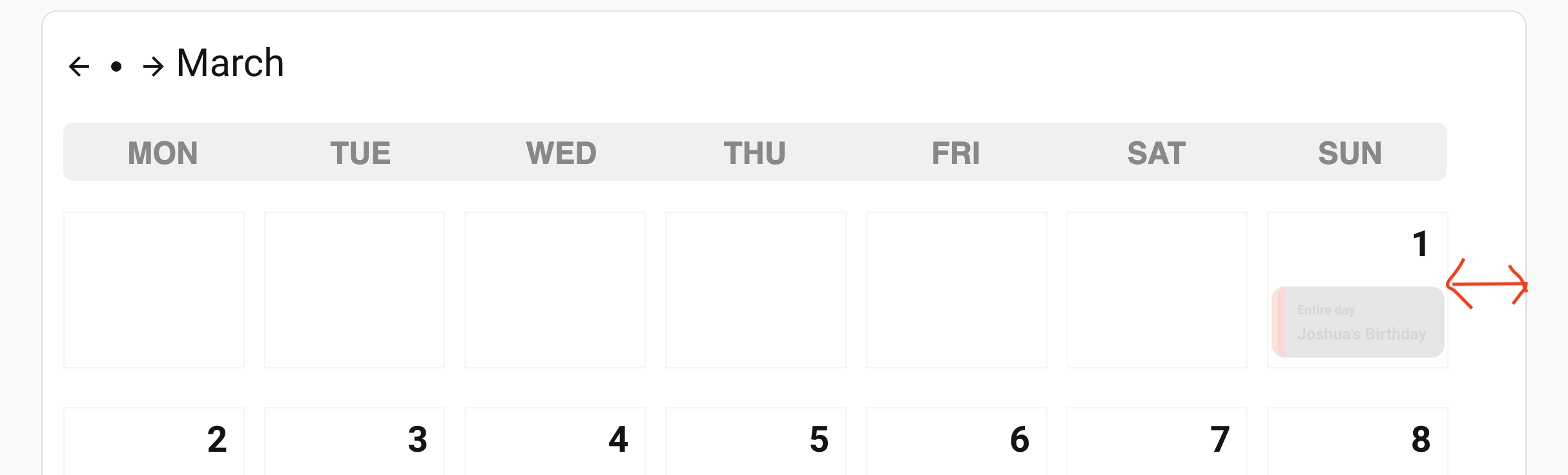

Does anybody know if there is a way to fix the calendar view so it:
  1. Only shows the days of the month you are in
  2. Always start the calendar on a Monday, even if the 1st is say a wednesday
By this I mean when I set the variables to the number of days if you choose “31” and there are only 30 days it brings the 1st day of the following month into view
Also if you set it to “month” it then means your rows of days are different every month
So I almost need April for instance to not show:
Wed 1, Thur 2, Fri 3, Sat 4, Sun 5, Mon 6, Tue 7
as the first row of 7 days but fr it to show
Mon (no day), Tue (no day), Wed 1, Thur 2, Fri 3, Sat 4, Sun 5
Mon 6, Tues, 7, Wed 8, Thur 9, Fri 10, Sat 11, Sun 12
Hope that makes sense, very difficult to explain
Sorry another question, just trying to figure out how to utilise the space to the far right. The days seem to start close to the edge on the left, but there is a wider gap.
Changing the width of the .day or .days from 12% to 14% doesnt seem to work. So im guessing there is another element I’ve over looked. I’ve tried playing with margins, padding, spacing and alignment on various elements like .container as well but cant for the life of me spot whats wrong.
Image to show what I mean:
The code is as follows in case anybody wouldnt mind taking a look please:
