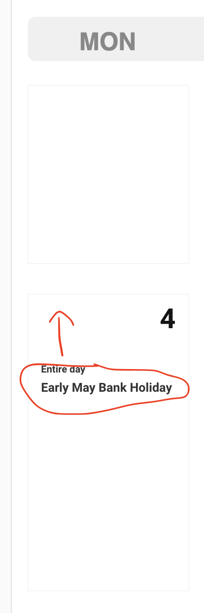

I was also wondering if it was possible to do the following:
  • I have holidays_in_the_united_kingdom as an out of the box calendar in google
  • So I’ve added:
- input_text.holidays_calendar_filter
HOLCAL: states['input_text.holidays_calendar_filter']?.state
- entity: calendar.holidays_in_the_united_kingdom
  color: clear
  filter: ${ HOLCAL }
I wanted to see if I could get HOLCAL to display in the header for the day, as opposed to the calendar portion.
Hopefully that makes sense: screenshot attached in case ive butchered the explanation

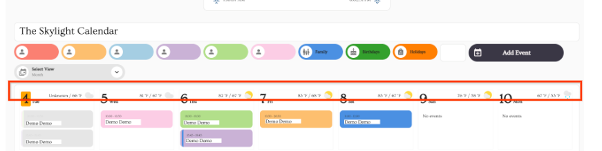

What would cause this alignment issue? The whole top row is slightly above box?
Are you expecting that weather to be separate from the calendar, or are you trying to get it to fit within the day header?
Its likely something like padding or margins from my experience, but im no expert.
It’s the alignment/padding of the row is off for some reason. Curious where to look as I know I haven’t changed anything for those things.
Has it just randomly happened after working for a while then? Could be related to an integration/HA update.
Have you updated anything today?
Not that I know off, its been like that since I first implemented it.

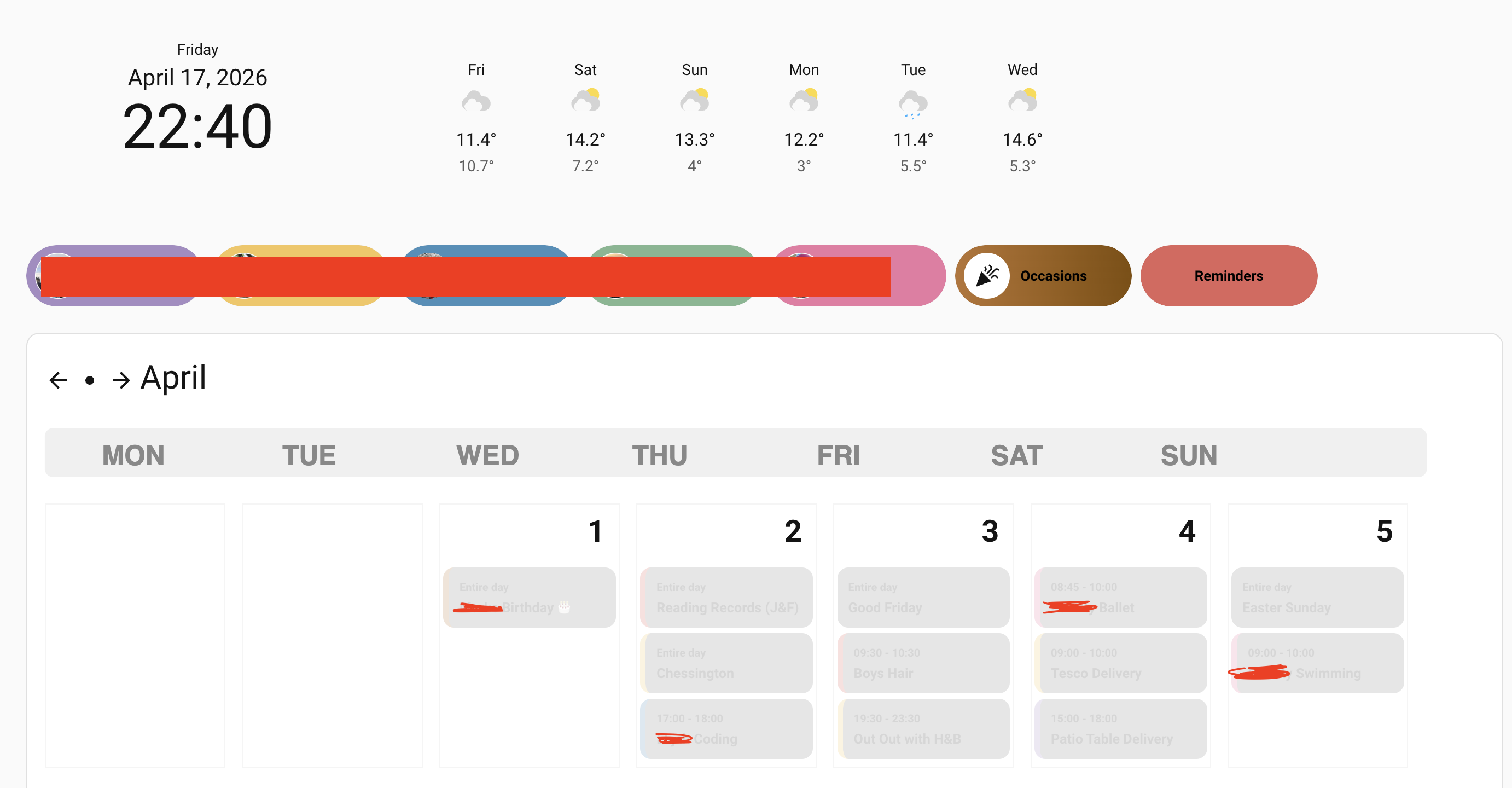

Out of curiosity do you want it on the calendar? You could take it out the calendar and into its own card.
I have the date/time and weather at the top.
Then filters
Then calendar
The spacing looks off in the screenshot because its from my laptop, but it aligns perfectly on my wall panel

This is from the repo
As you can see the spacing of the top row is great, versus mine. It would be great if I could pad down from the top a little bit.

To space mine out I used sections:
Section 1 (at the top) - Split into two half sections: Date/time and Weather
Section 2 (full width) - The filters
Section 3 (full width) - the calendar
I personally removed the “select view” capability as we wanted a whole month at a time. Instead I have arrows to toggle through the months.
If you dont want the “add event” button but the ability to click in the days and add, you can download/install randr’s package. then just change the card from “- type: custom: week-planner-card” to “- type: custom: week-planner-card-plus”
If you want stuff below it you can add another section.
I have the same as you, a large 32 inch touch screen in portrait. So you can end up with whitespace, so I think of something to pad it with.
You could create some google task lists and add those below for shopping lists and todo lists…I did that at first, but we have so many lists it warranted its own dashboard :slight_smile:
