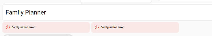

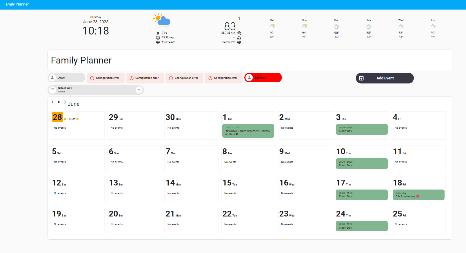

why am i getting this config error?
almost there just missing a few things and I cant seem to figure them out.

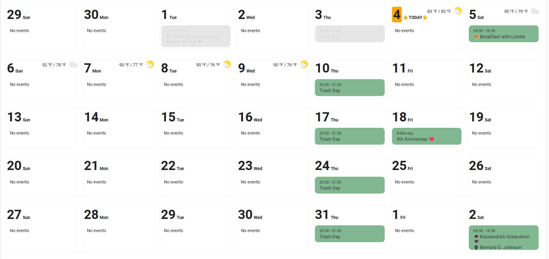

  1. I cant get the weather to show on the calendar in each individual square.
  2. When I click on birthdays and a person I get the error ā€œAction script.birthdays_calendar_visible_filter not foundā€
  3. Not sure why I keep getting the config error on the left of birthdays
  4. The bubble that say Jesus I cant change that to another color only stays grey.
Can someone explain what im doing wrong. I am attaching the YAML code

So you ā€˜person.jesus’ as well as ā€˜script.jesus_calendar_visible_filter’ as the perform_action.
Then you have others namely ā€˜person.person2’ with a ā€˜script.person2_…’
and so on.
However lower down you have a number of input_text. entries. The first one being:
" - input_text.person1_calendar_filter"
with a corresponding variable below:
"PERSONCAL: states[ā€˜input_text.person1_calendar_filter’]?.state
All the bits that say person1 should be replaced with ā€œjesusā€.
Can you try this and let me know how it goes.
If you want the weather icons/temp to show on each day in the calendar you need to add that section in. I didnt want it, for me it was too much and I felt it cluttered the view. But its personal choice.
Within the calendar section where it says ā€œweather: nullā€ you need to add additional elements:
      weather:
        showCondition: true
        showTemperature: true
        showLowTemperature: true
        useTwiceDaily: false
as an example

Also, for those that keep asking about how to show the entire current month like a normal calendar, you swap out the days and startingDays from the above configs with the following:
days: month
startingDay: month

Yeah I had this originally, effectively it sets ā€œdays:ā€ to ā€œ31ā€.
So on months that have 30 days, it wraps round and includes day 1 from the next month.
It works well other than that. I dont suppose anybody has made it so the extra day/s dont appear from the following month have they?
