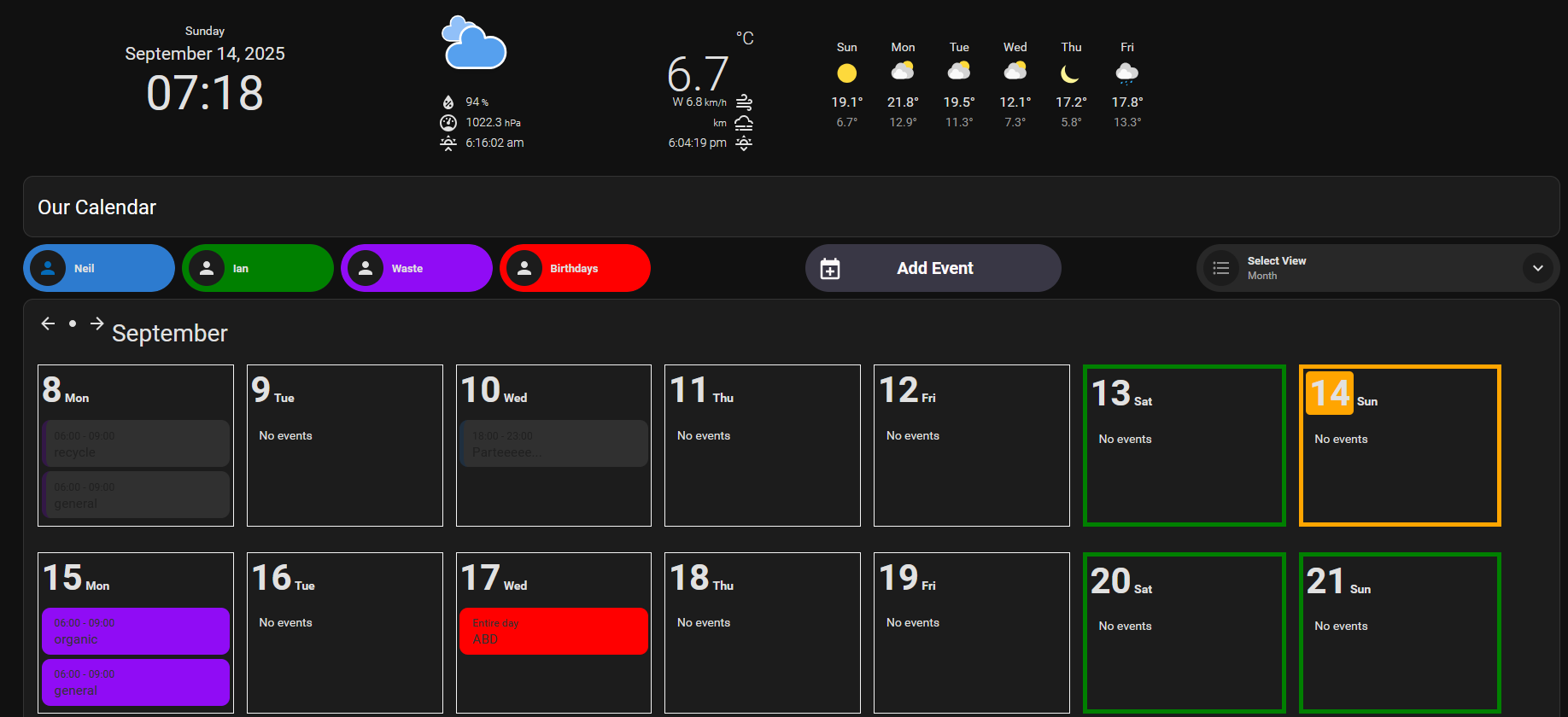

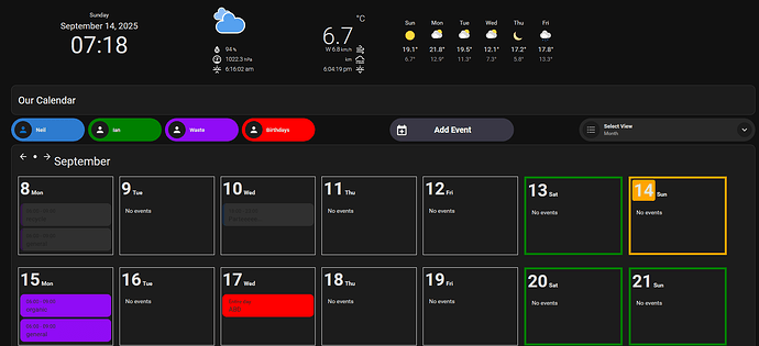

Just wanted to say thanks for this project, I started with google integration but now I’m just using the HA calendar in the background. I changed a few things with styling and the event pop-up, also kept the rows to be Monday to Sunday unless you choose less than 7 days.
The layout looks a little weird because its designed for a tablet.
Looks nice! You should put yours in a github repo or write up how you made yours. The more guides out there, the more it helps the community.
Looks nice, can you please share your code?
How did you get the rows to be Monday to Sunday?

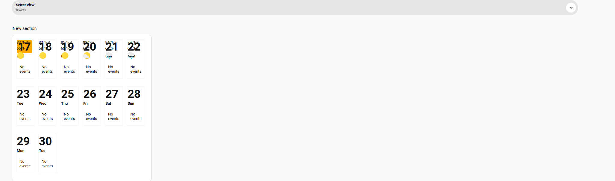

I have had moderate success with setting this up. I am still trying to set up the person bubble cards to toggle what calendar events show up in the week planner card. I can get it to work, but as soon as I wrap the week planner card in the custom-config-card to enable the entities and variables it seems to limit the week planner to only 1 column width so I can’t view the calendar across the entire screen.
Take what I’m gonna say with a grain of salt as I’m a newbie but I solved it by putting the calendar in an horizontal stack by itself. Then you can set the width you want including the full width.
