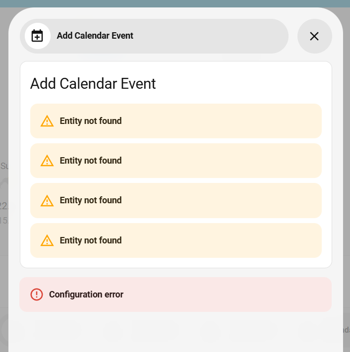

Can someone point me in the direction I should look to see why I get “Configuration error” in the popup box when I click add event. I’ve redone the calendar a couple of times with all the helpers etc, but I get the same error.

I struggled with this. The fix for me was to install “button-card” from Hacs.
