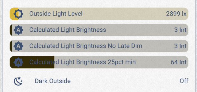

I just finished a quick LUX Sensor project that I thought I’d share. Inexpensive parts, easy assembly, no 3D printing, and it has been working well for me.
It is meant for monitoring outdoor LUX values while the unit itself remains indoors. It’s an ESPHome based project.

Currently I am using the LUX Sensor to manage my home’s exterior lighting. Nothing complex, I just wanted my exterior lighting to be responsive to the light level outdoors (sunset, sunrise, storm clouds etc.)
Having a LUX Sensor that sits in a window sill looking outward solved the issues of making an outdoor LUX Sensor waterproof and getting power to it outdoors. So far it is working very well.
