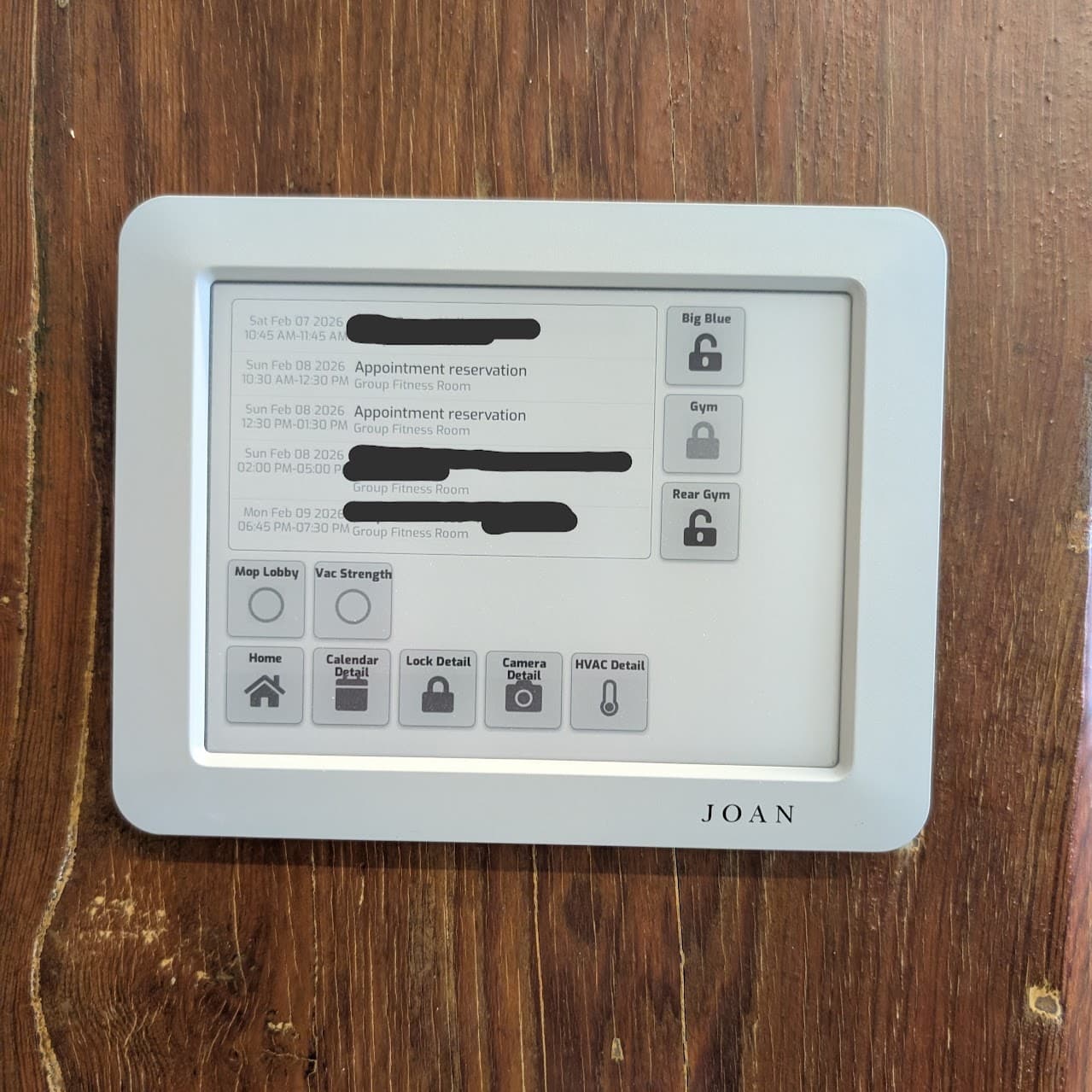

I sat down with my now-defunct Joan devices and finally figured out how to make them useful with HA, without paying extra fees.
You will need:
  • Home Assistant
  • Joan eInk devices
  • A docker container running Visionect Server 7.6.5 or earlier - before they required per-device subscription fees
  • Some sort of kiosk mode add-on for HA. I used AppDaemon.
Use the Joan Configurator tool to update the server URL on each device to point to your locally running instance of Visionect. Then change the content of the device to whatever the URL of your HA kiosk page is.
