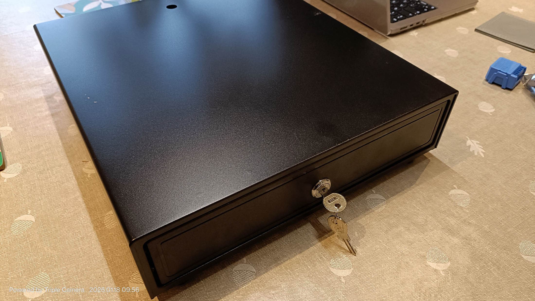

I wanted a key (and cash) safe that’s easy to access as we’re likely to be in and out of it a lot, so connecting it to Home Assistant would mean I can unlock it from the dashboard or voice control. I looked at various off-the-shelf options, everything from fingerprint-drawer locks to gun safes. But nothing quite hit the mark without costing a fortune.

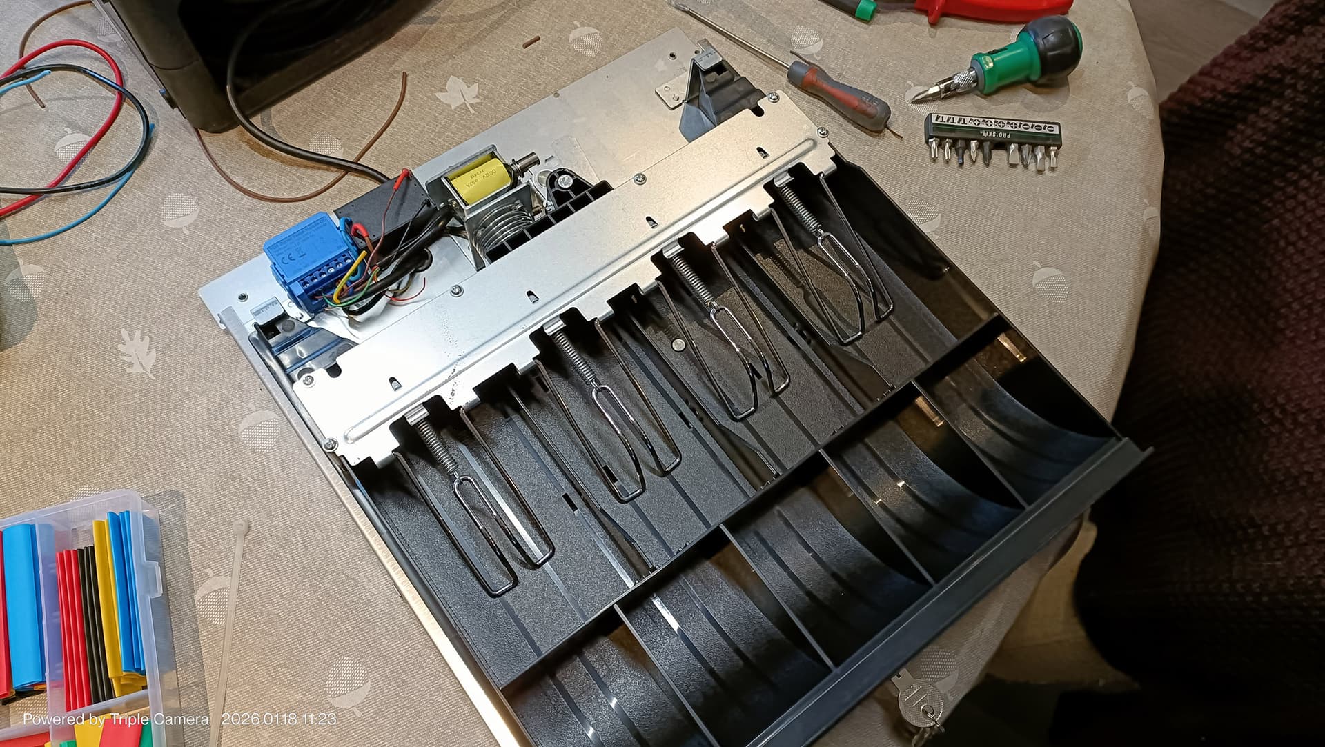

I eventually stumbled onto a locking cash register drawer on eBay. The kind you see under a till in a shop that pops open when they want to put money in or out. It makes an excellent key safe - secure, cheap (around £22 I think), it has a built-in solenoid that can be electronically triggered to open it, and there’s the backup option of a key override unlock on the front.

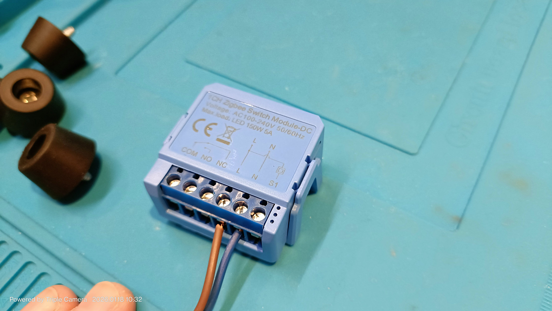

  • Tuya TS0001 Zigbee relay with dry contacts (AC powered, Aliexpress ~£3)

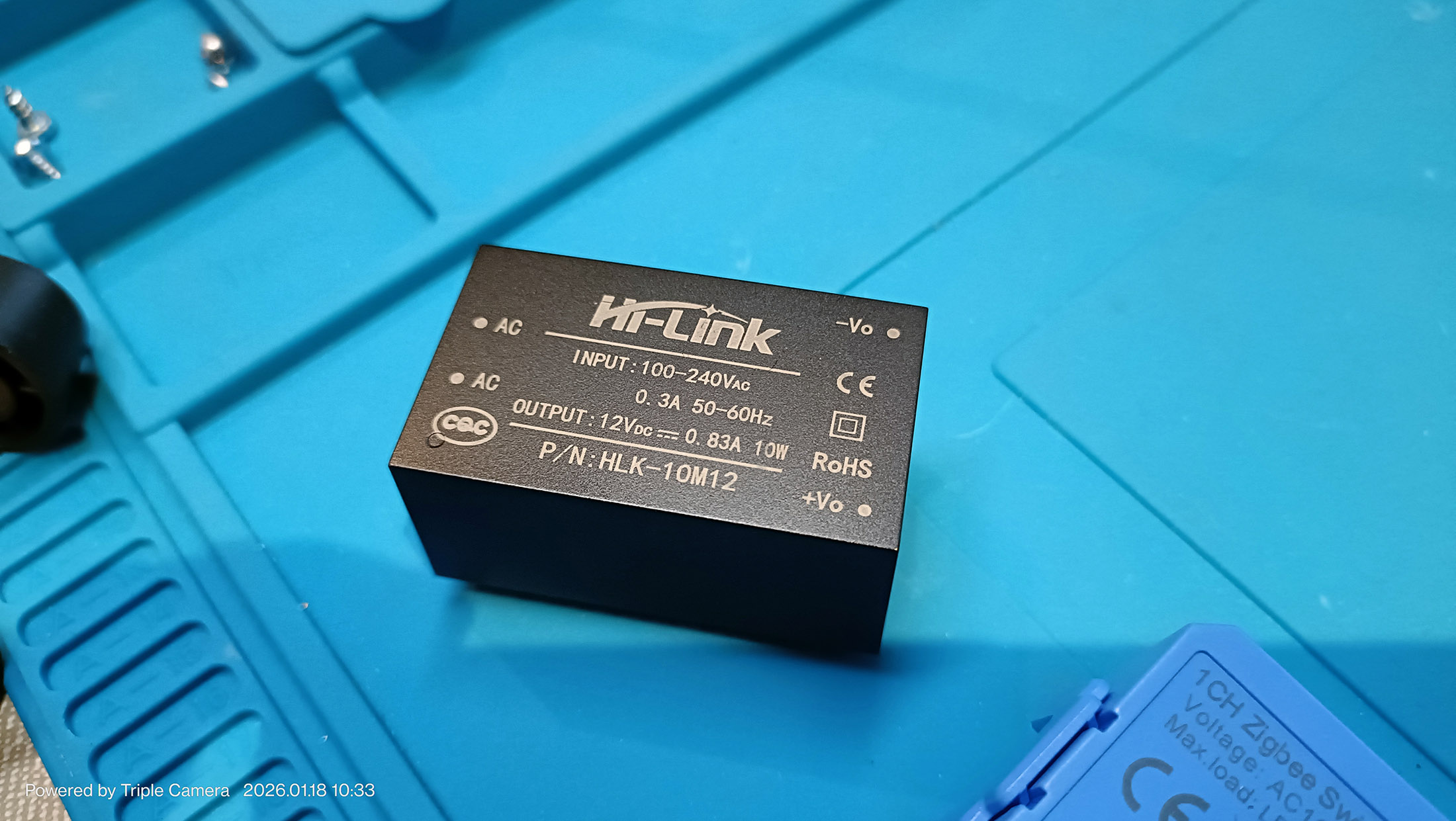

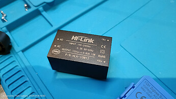

  • HLK-10M12 compact AC-DC converter (10W, 12V output, Aliexpress ~£3)

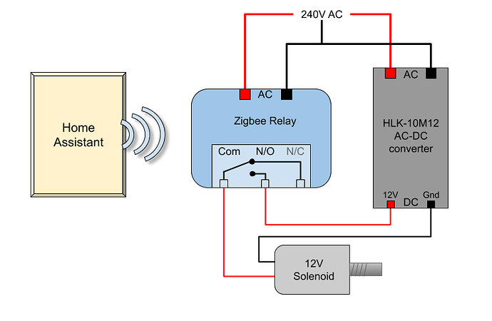

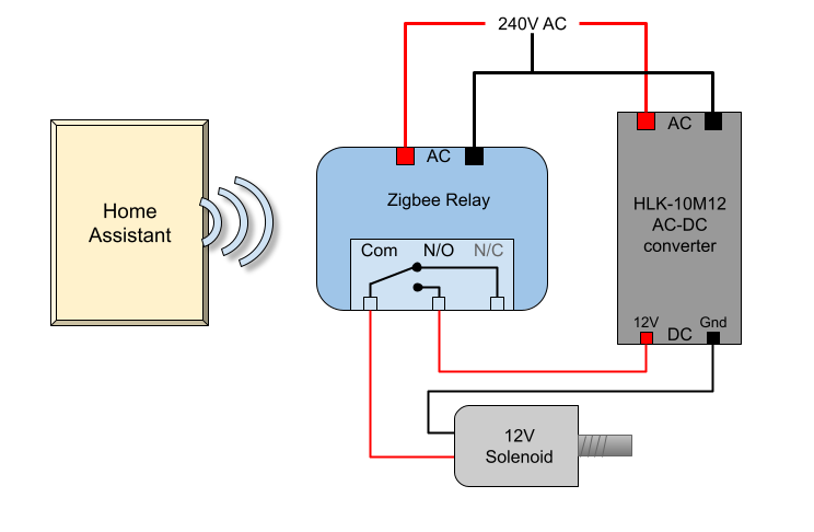

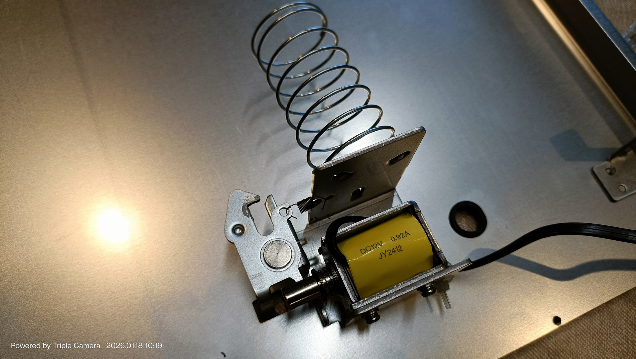

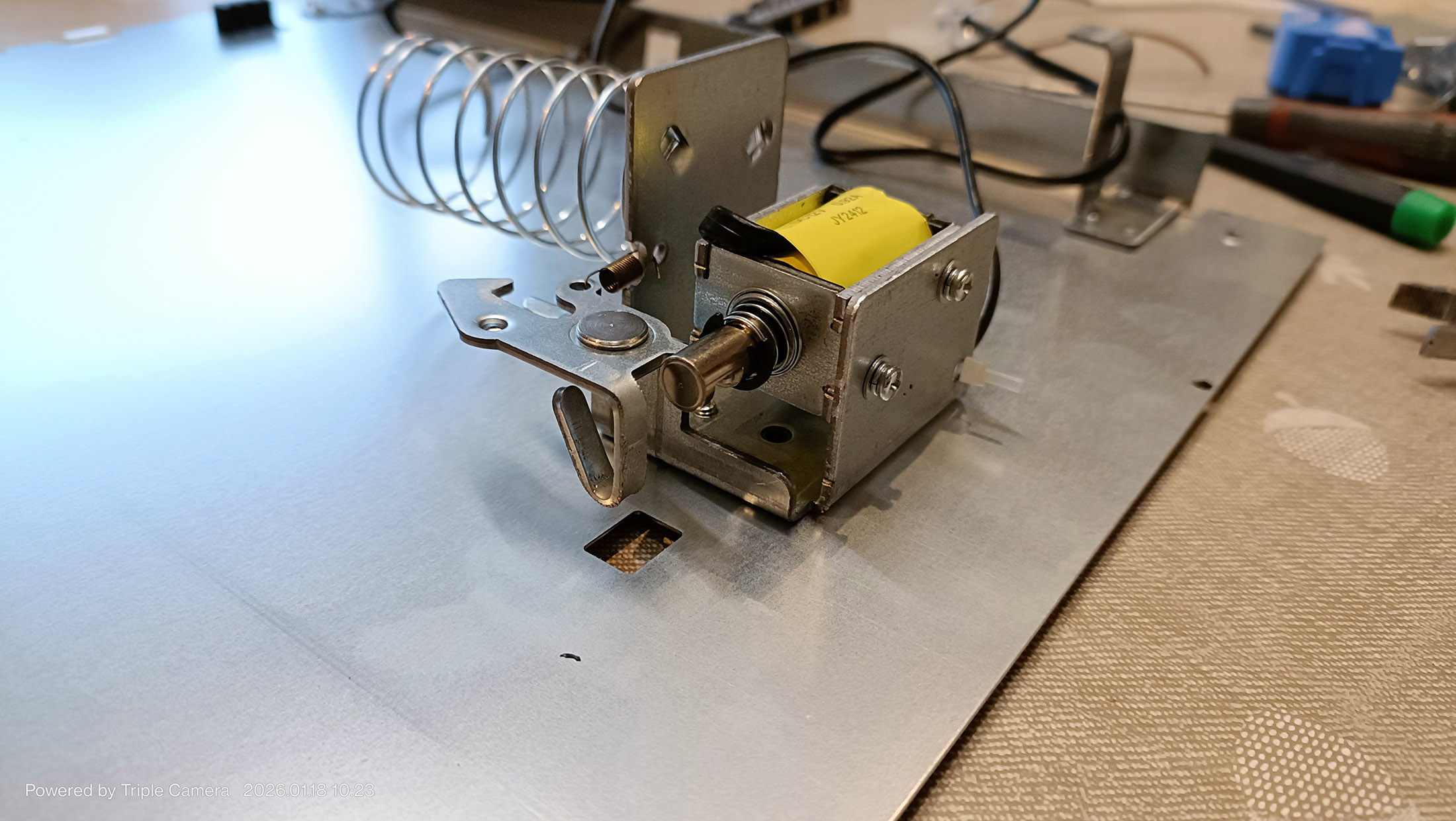

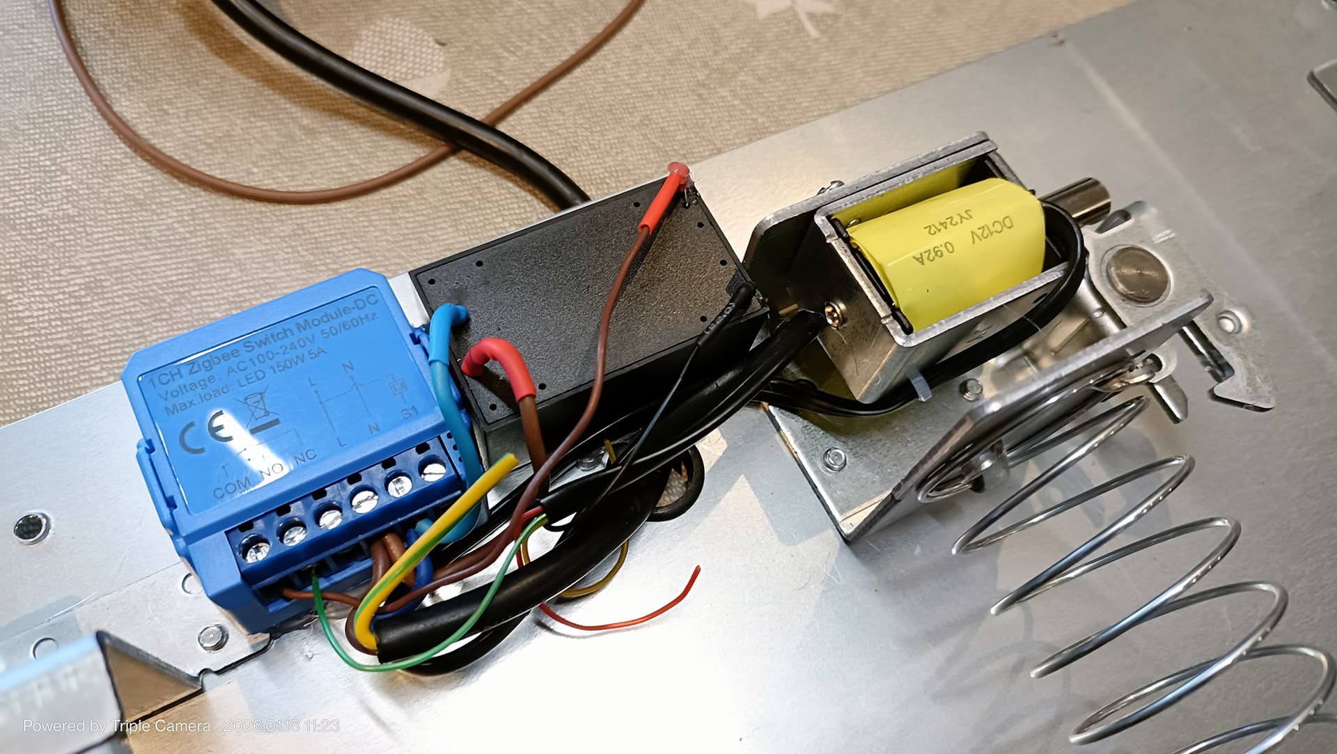

How It Works: The drawer’s solenoid normally connects to a till or receipt printer via an RJ11 cable, and expects a brief 12V pulse to open the drawer. So I just replaced the till with:
  1. HLK-10M12 converts mains AC to 12V DC
  2. Zigbee dry N/O relay switches 12V to the solenoid
  3. Home Assistant automation pulses the relay to briefly activate the solenoid = drawer pops open

  • Zigbee relay can live inside the drawer (signal penetrates thin metal frame - I tested first)
  • Compact Hi-Link module fits inside easily
  • 10W rating handles solenoid surge current (brief ~1-2A pulse)

The relay’s paired through Zigbee2MQTT. But this would work equally well with any other kind of remote relay unit; a wifi one, or even one that’s flashed with the likes Tasmota. All it needs is dry contacts to briefly supply 12V to the solenoid via remote control.
Some relays have an inching/momentary option, but this isn’t one of them. It’s either on or off. So I created an automation that watches the Zigbee relay and automatically turns it off after 150ms, regardless of how it was activated. This ensures the solenoid only ever gets a brief pulse, never continuous power.

  • Check your drawer’s solenoid voltage first (most are 12V, some are 24V)

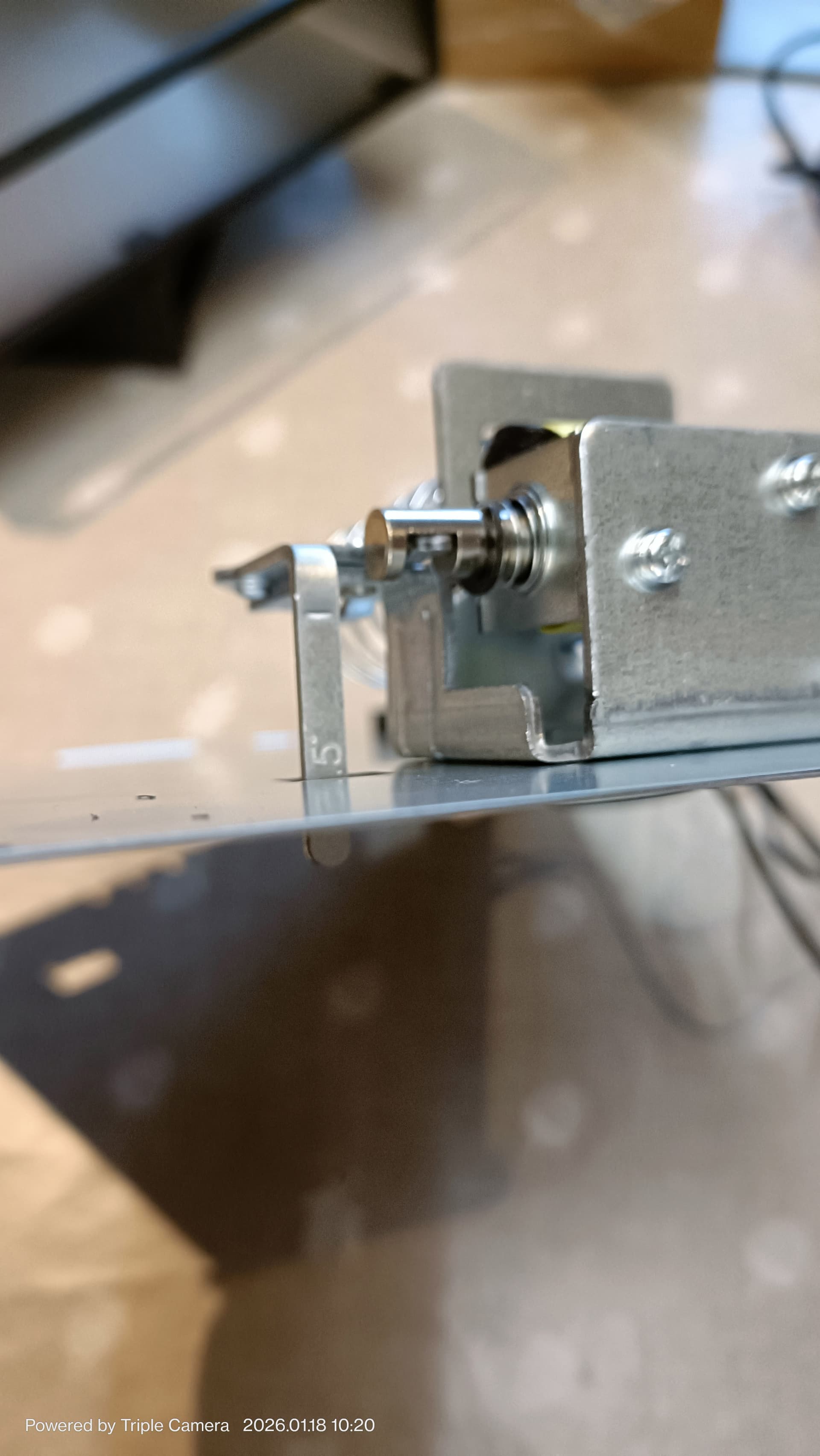

  • This drawer had a manual release lever under the solenoid. That seemed like it defeated the whole purpose as anyone could unlock it, so I bent the level back up inside the drawer housing to take it out of action. See below.

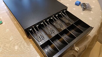

I was a bit surprised! Even the form factor and footprint turned out to be more useful than dedicated, purpose made, expensive options.
Great just as a way to make a slightly more secure home for any cash, cards, keys, passports, etc.
