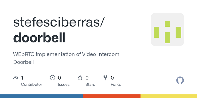

I have a similar goal. I have been trying for quite some time, but got stuck in the WEbRTC blackhole. Luckily with AI assistants (Deepseek and Claude), I have made more progress this month.
My setup:
Raspberry Pi 4, with camera and sound card
I am still not sure if to go with a webcam or with a GPIO cam, most likely the latter. I have configured for both. It will ultimately depend on the situation during installation.
MediaMTX server
This publishes the camera feed to RTSP, which is picked up by Frigate. That way, I can have more flexibility, including recording, Motion detection, etc. Frigate is on another Raspberry at the moment, but will be transferred to a Docker on HP eliteDesk
Janus gateway
Installed on a Docker so far, will be transferred to Proxmox after testing. I am using a videoroom plugin.
Raspberry Pi has a python script that captures the RTSP, and feeds into the Janus gateway. That way, I have used WebRTC to connect multiple clients in a browser.
One ringer is pressed, the python scripts connects to one client (intercom) to play a chime. This will be always on, on a tablet. Still to figure out details.
It also connects to HA through a webhook, to send a Critical message to phones. Once pressed, these will then launch a browser with the feed.
there are some security features. One time Tokens are used in the notification messages, so that even if some one has the link, they also have to have the token for the door to be opened.
I am around 85% there. Still to do:
  1. failure detection and notification if Janus server is down
  2. Doorbell control from browser.
  3. Door opening notifications
See it at:
