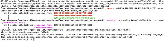

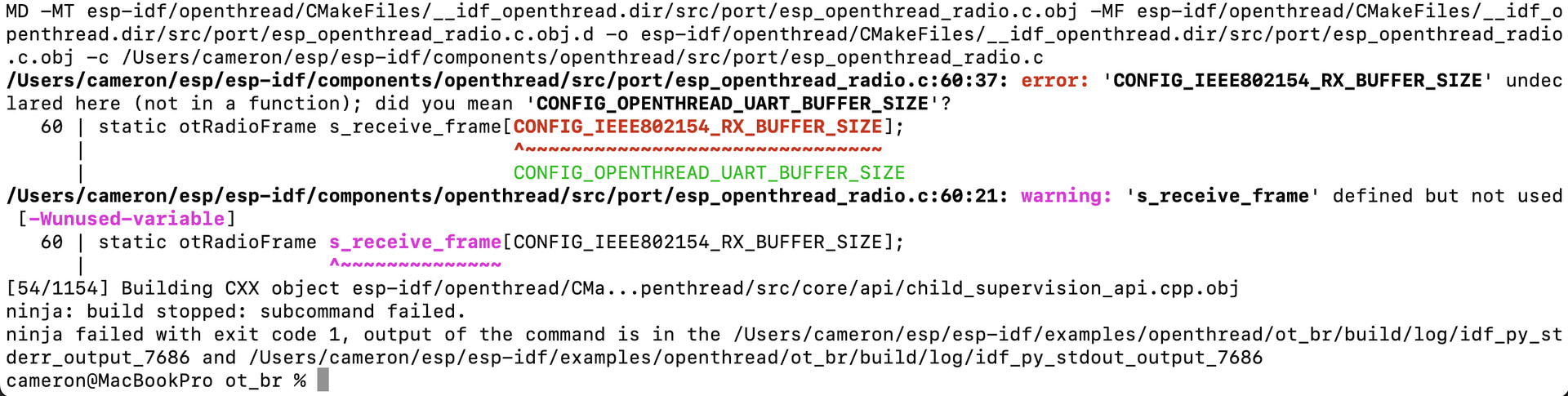

I got past this error on an Ubuntu 25.04 x86_64 machine by deleting the ~/esp/esp-idf/examples/openthread/ot_br/build directory.
Some of the options in menuconfig seem to have moved compared to the write-up above (I downloaded IDF v6.0), but I think I managed to find them and set them as required.
However, unfortunately, I am now running into an error when I build the firmware (idf.py build command - about PARTITION_TABLE_FILENAME). I might start a separate post for that if I can’t figure it out.

Well it worked so far and then this.
openthread_radio.c.obj.d -o esp-idf/openthread/CMakeFiles/__idf_openthread.dir/src/port/esp_openthread_radio.c.obj -c /Users/cameron/esp/esp-idf/components/openthread/src/port/esp_openthread_radio.c
/Users/cameron/esp/esp-idf/components/openthread/src/port/esp_openthread_radio.c:60:37: error: 'CONFIG_IEEE802154_RX_BUFFER_SIZE' undeclared here (not in a function); did you mean 'CONFIG_OPENTHREAD_UART_BUFFER_SIZE'?
   60 | static otRadioFrame s_receive_frame[CONFIG_IEEE802154_RX_BUFFER_SIZE];
/Users/cameron/esp/esp-idf/components/openthread/src/port/esp_openthread_radio.c:60:21: warning: 's_receive_frame' defined but not used [-Wunused-variable]
[54/1154] Building CXX object esp-idf/openthread/CMa...penthread/src/core/api/child_supervision_api.cpp.obj
ninja: build stopped: subcommand failed.
ninja failed with exit code 1, output of the command is in the /Users/cameron/esp/esp-idf/examples/openthread/ot_br/build/log/idf_py_stderr_output_7686 and /Users/cameron/esp/esp-idf/examples/openthread/ot_br/build/log/idf_py_stdout_output_7686
