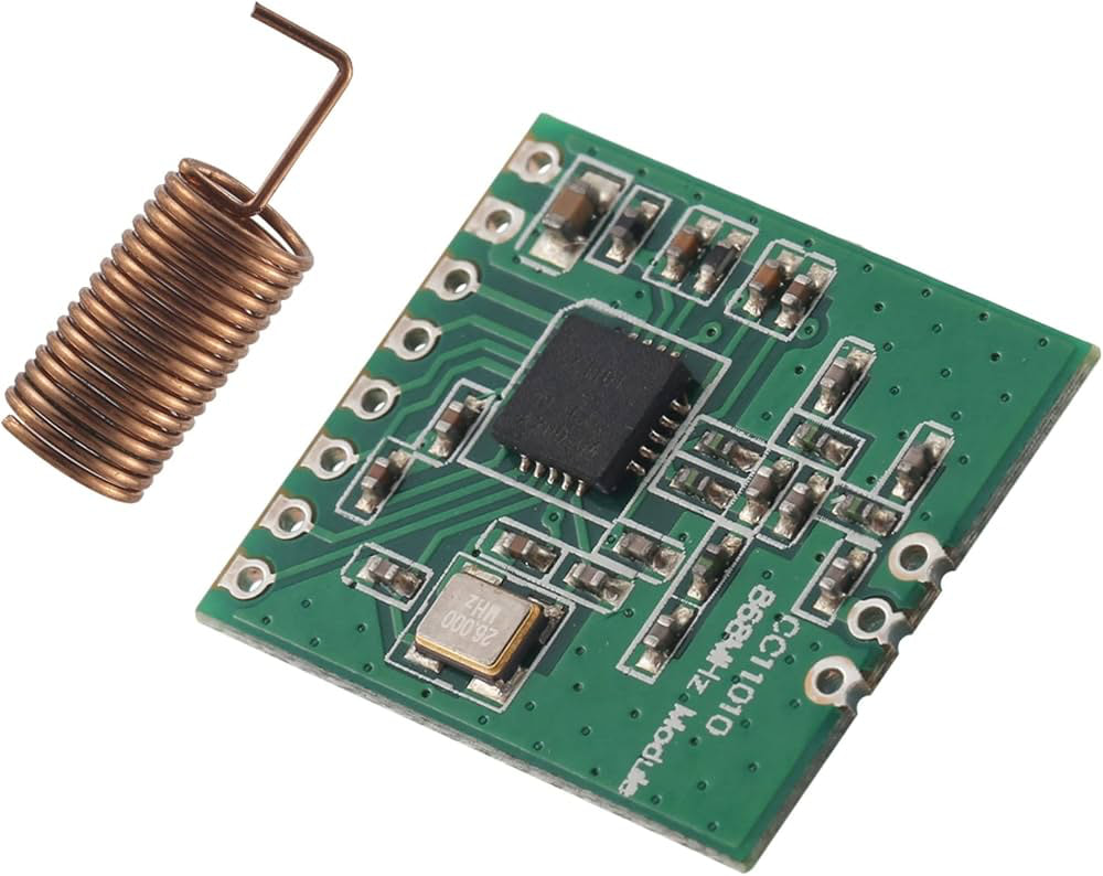

Instead, I bought a 868MHz CC1101 module and connected it to an ESP32 running ESPHome to try to intercept and decode the RF signals sent by the station. You will need to solder the antenna and wires to this module and the ESP32.

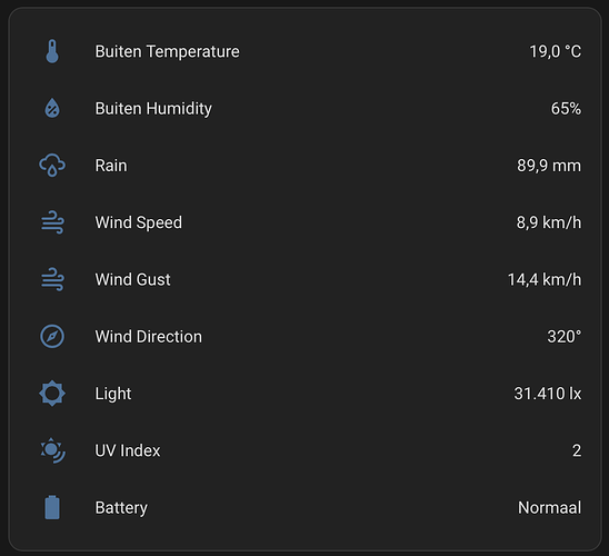

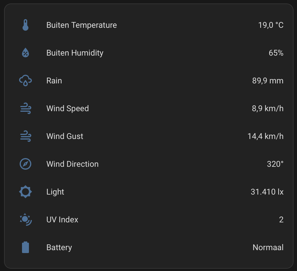

After some time, I got the decoder working, thanks to examples from the rtl_433 community. To get it into Home Assistant, I created an ESPHome external component: GitHub - parrel/esphome-vevor-7in1 · GitHub
It’s reporting the values every 20 seconds. It’s been running fine now for 3 months, so I’m ready to share it with the community!
And with some minor tweaks, you can build the same cool rain graphs as done in ☔ DIY Zigbee rain gauge.
