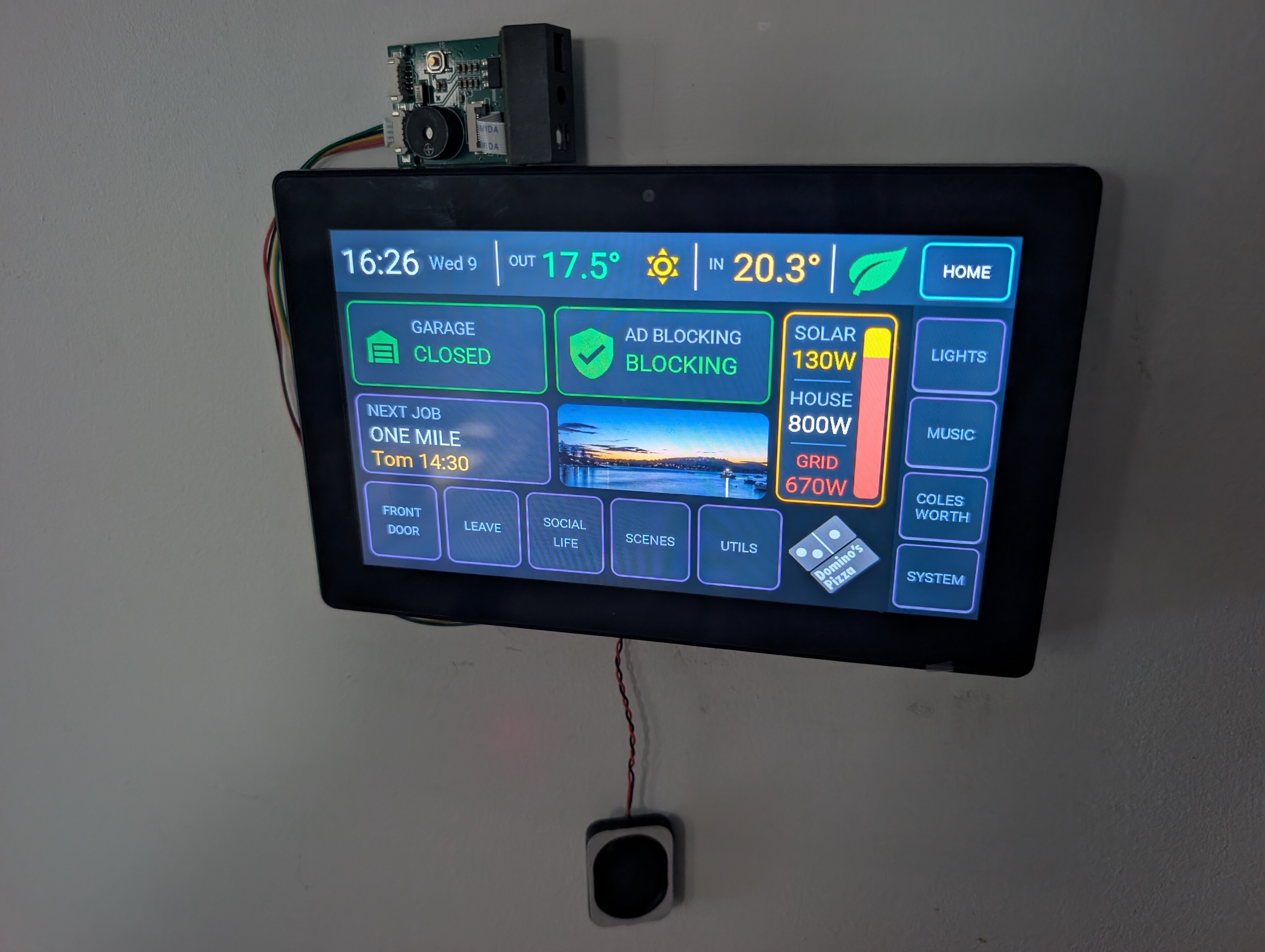

Home Page – Garage status and control, Pi-hole control, work commute time-to-leave based on that day’s suburb, live doorbell camera, HA scenes, social calendar upcoming events, which bin goes out next, as well as nav buttons for climate, aircon, solar/grid, grocery and mealie stuff, lights, and music.

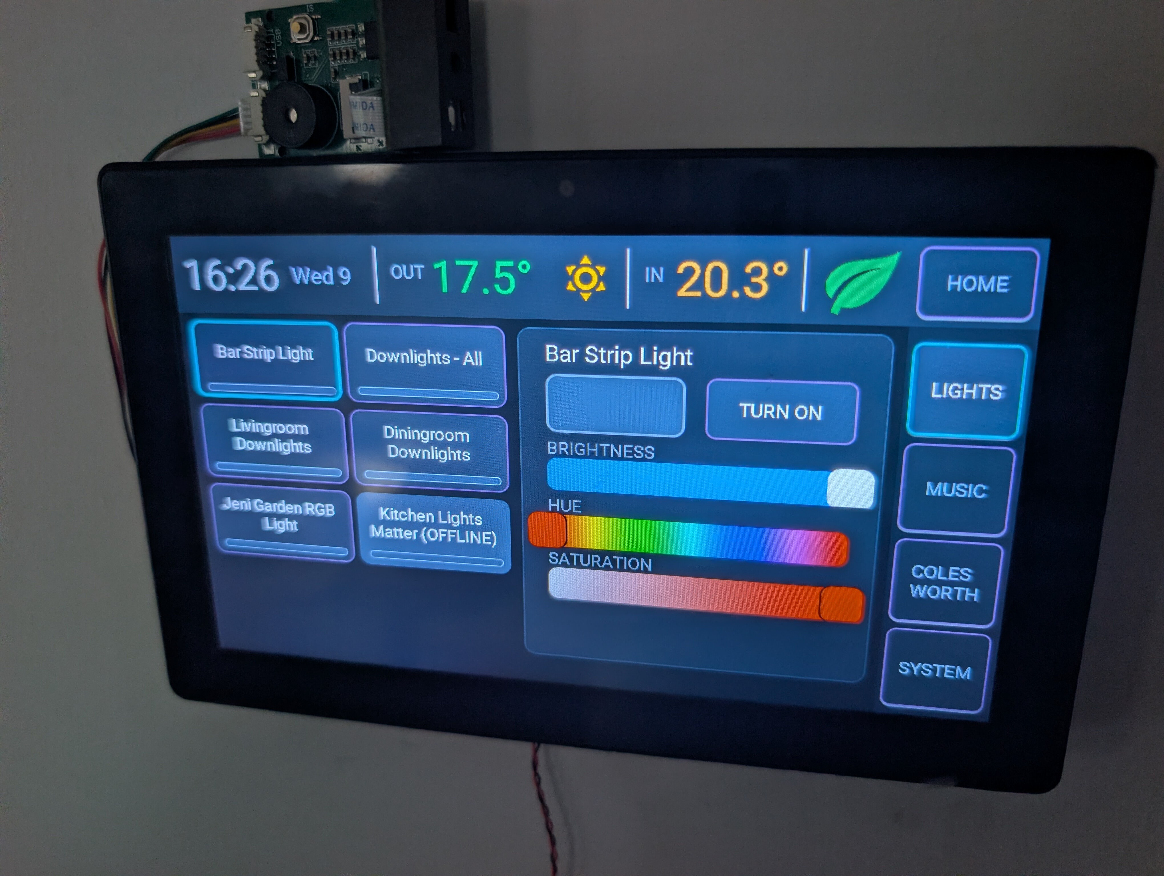

Lights – Dynamic tiles from a HA light group with power, brightness, colour, and temp as applicable for each light.

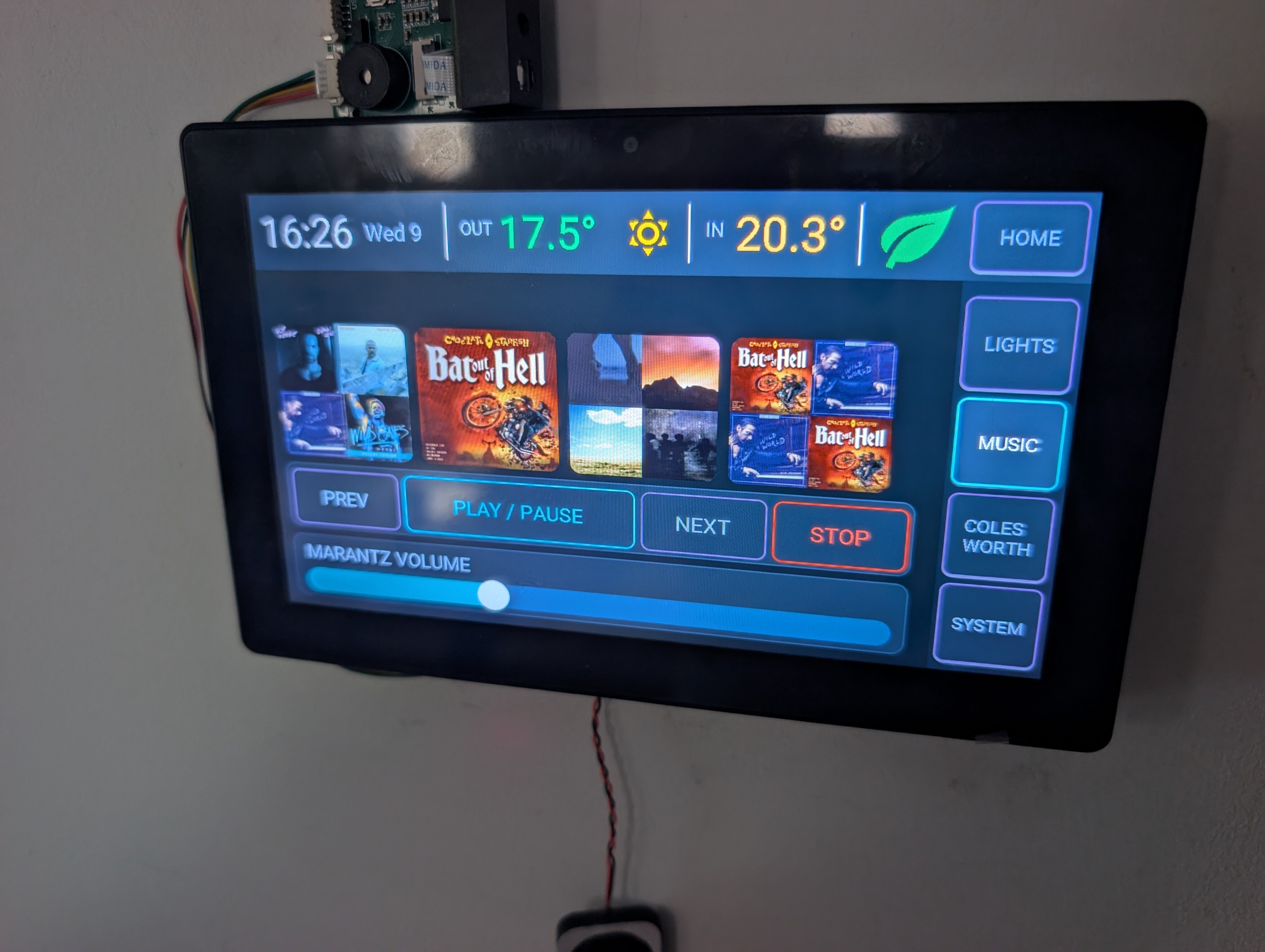

Music – Paged Plex playlists with playlist art, using Music Assistant for audio / Cast for Video, amp volume and transport controls.

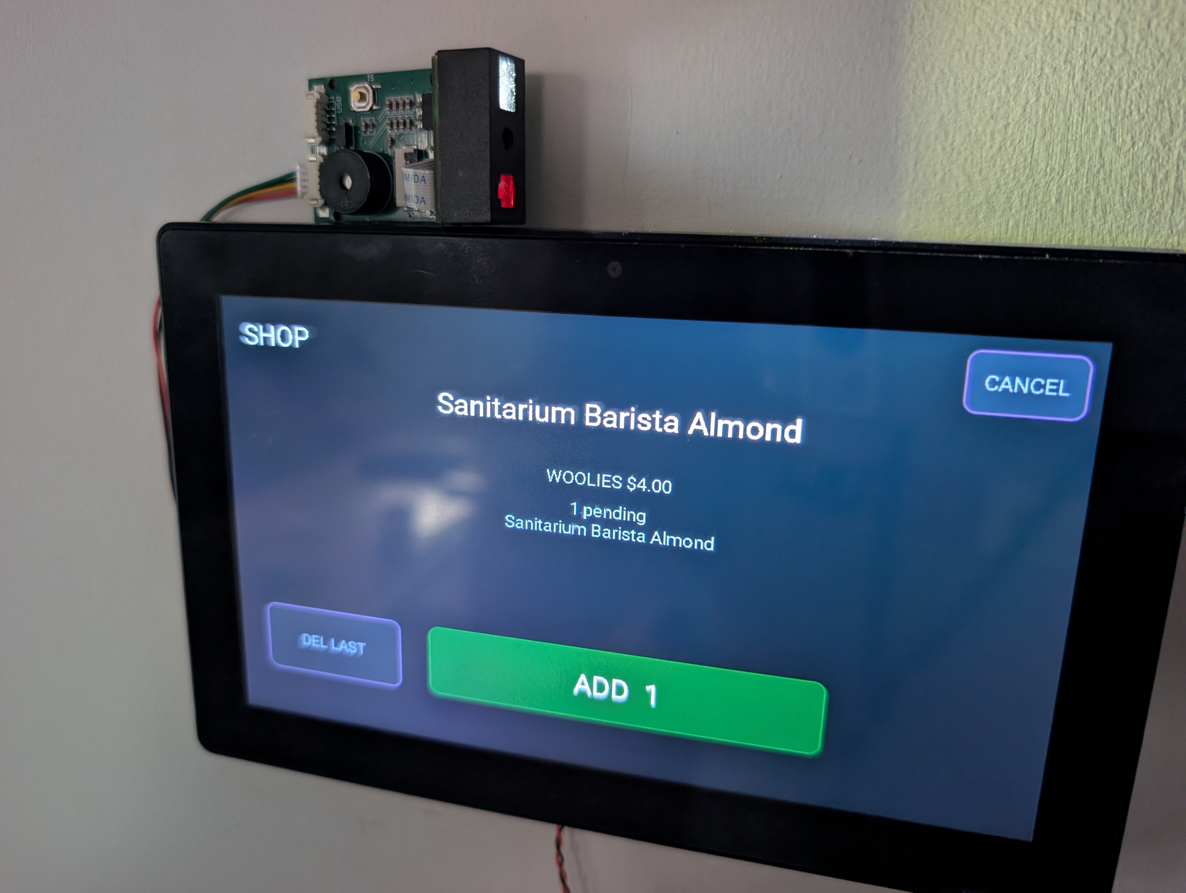

Barcode Scanning – GM67 scanner for groceries with lookup using Open Food Facts. Populates shopping list, use-by date tracking for notifications* and does local price lookup.
