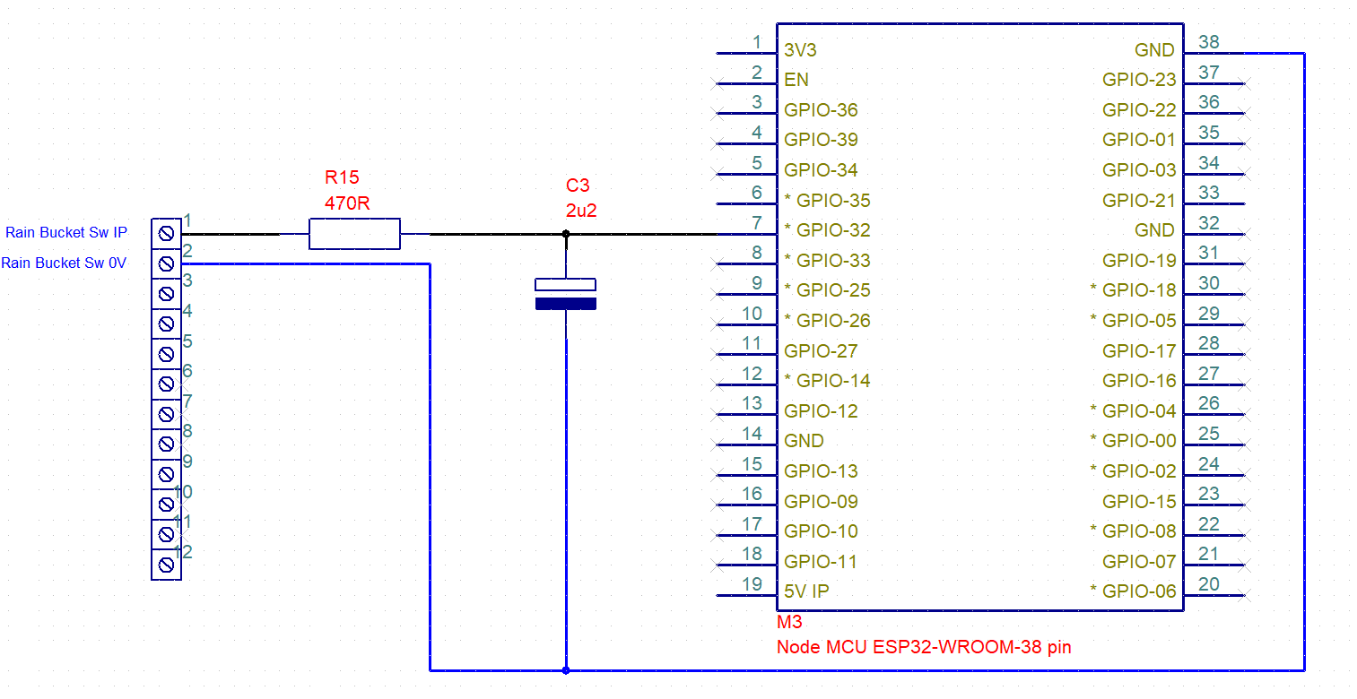

Using the rain gauge into ESPHOME using an ESP32 I have found that the pulse from the reed switch is too short to be detected by the ESP32.
I don’t believe there are interrupts available? So I just added a simple RC circuit.
The reed switch quickly discharges the 2u2 Capacitor making the input to the ESP32 low. But the cap takes a short while to charge via the weak internal pull up resistor. Thus extending the pulse. The 470R limits the current through the reed switch to a max of 7mA.
Just posting to help others
You can use interrupts with the GPIO Binary Sensor.
Thanks, I was misinformed on another thread, I will add that, remove the capacitor and give it a try and report back.

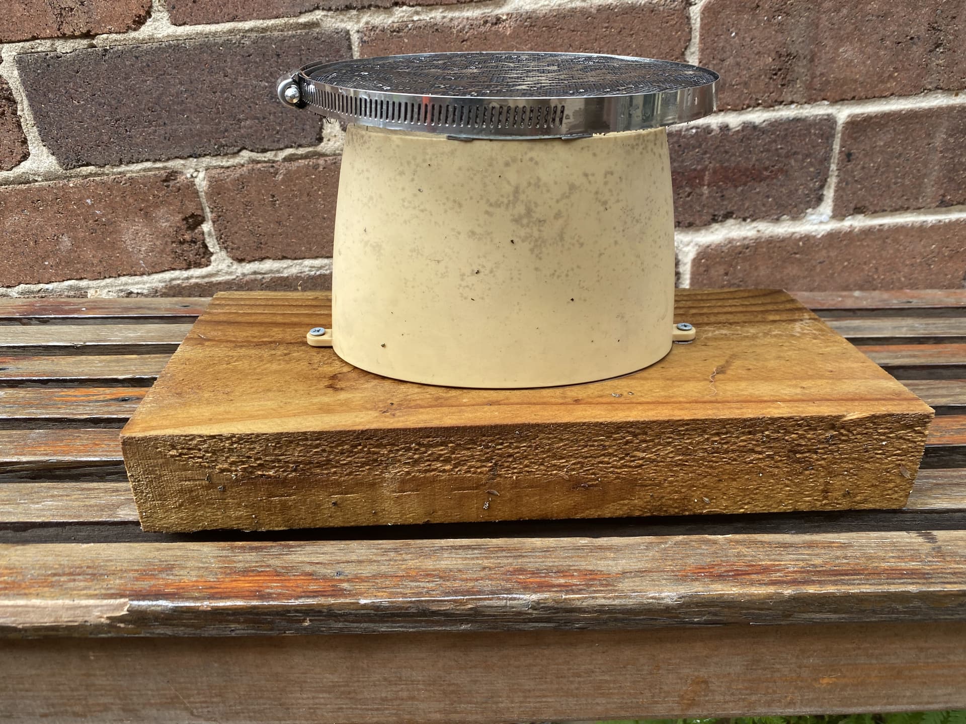

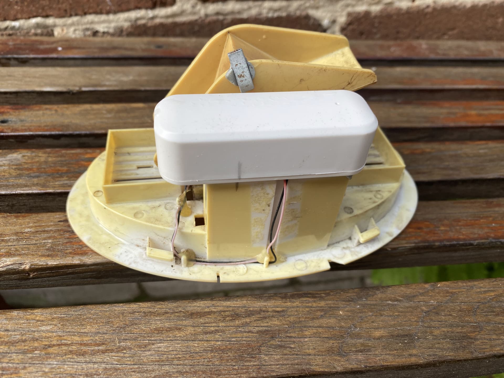

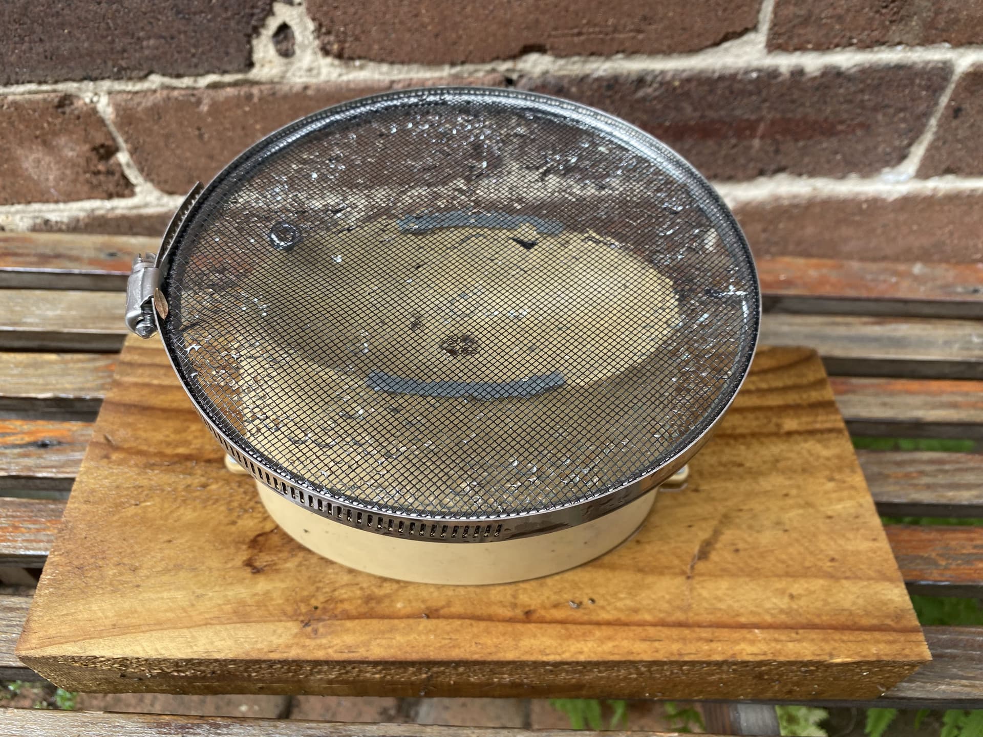

Great lateral thinking! My version is using an old / recovered oval collector that had failed years ago. A small magnet was added to the other side of the bucket to provide better clearance for the new $5 AA-powered Zigbee sensor which then fitted without modification. [I’ll replace the Blu-tak with glue once proven reliable!]
I wasn’t happy with the resolution (one tip per mm) so I increased the collection area: wanting something UV-stable I landed on a $5 17cm glass saucepan lid, knob removed and fixed with double-sided tape. Flyscreen was added to keep the drain clear and reduce any losses from drop splatter.
