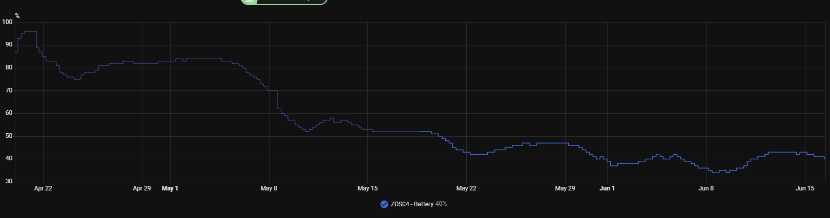

I'm also finding rapid battery drain on some CR2032 powered units. The supplied battery lasted less than a week in two units I bought! This chart is with a replacement quality-brand battery, which won't last much longer...

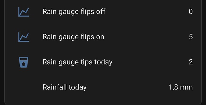

Ok this is strange. It did definitely NOT rain today. And I got on-flips but no off flips…
Check history of the binary sensor

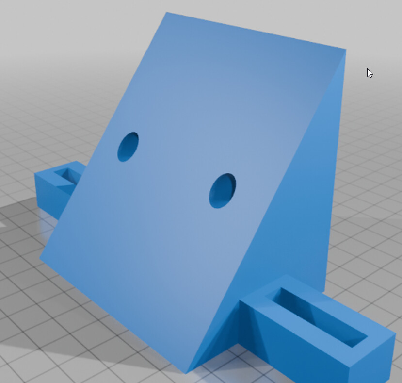

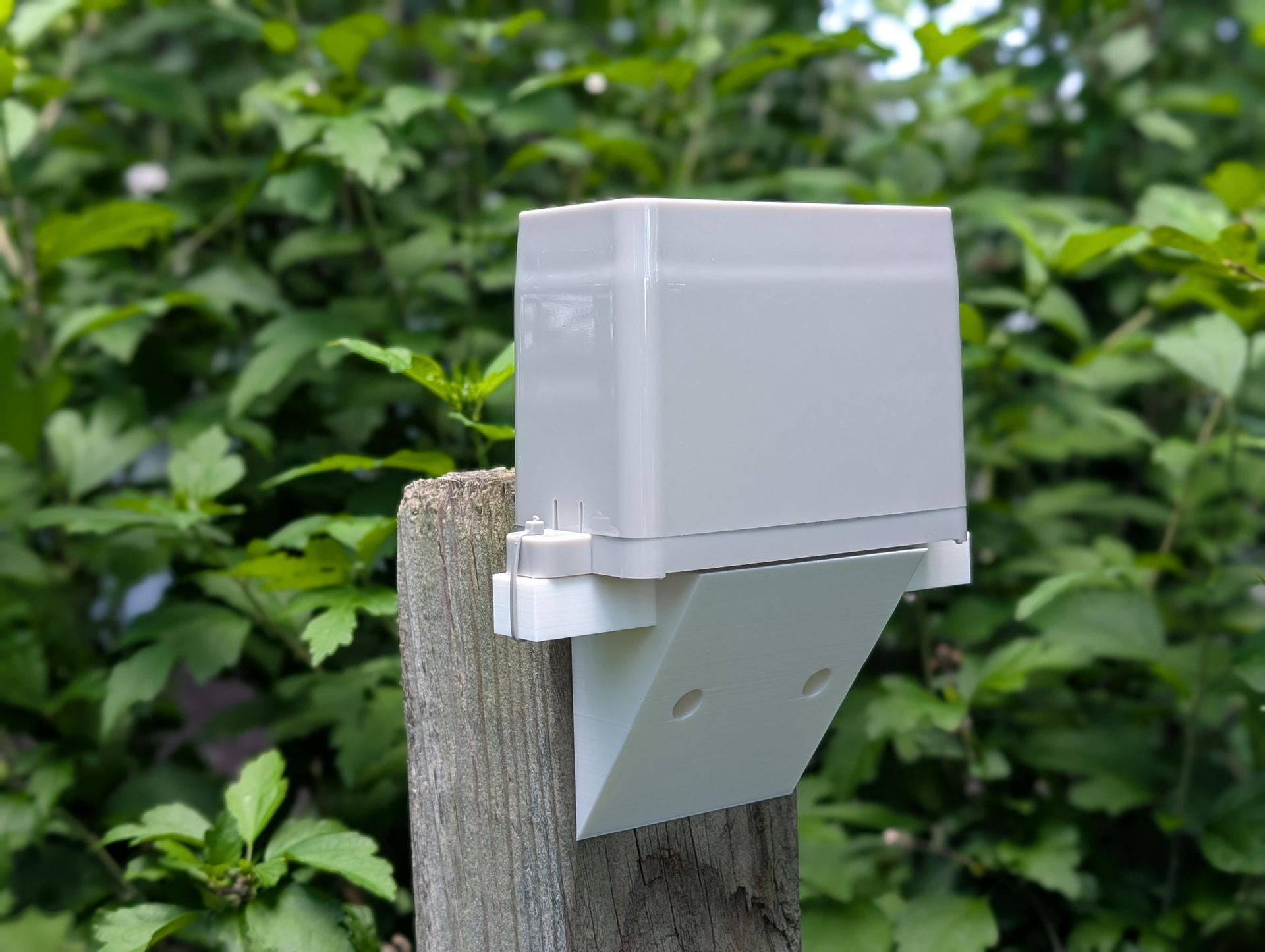

I made a mount for anyone who would like to attach this to a post or other compatible surface. You’ll just need a couple screws and zip ties.
Available here: Misol Rain Gauge Post Mount by roelbj - Thingiverse
