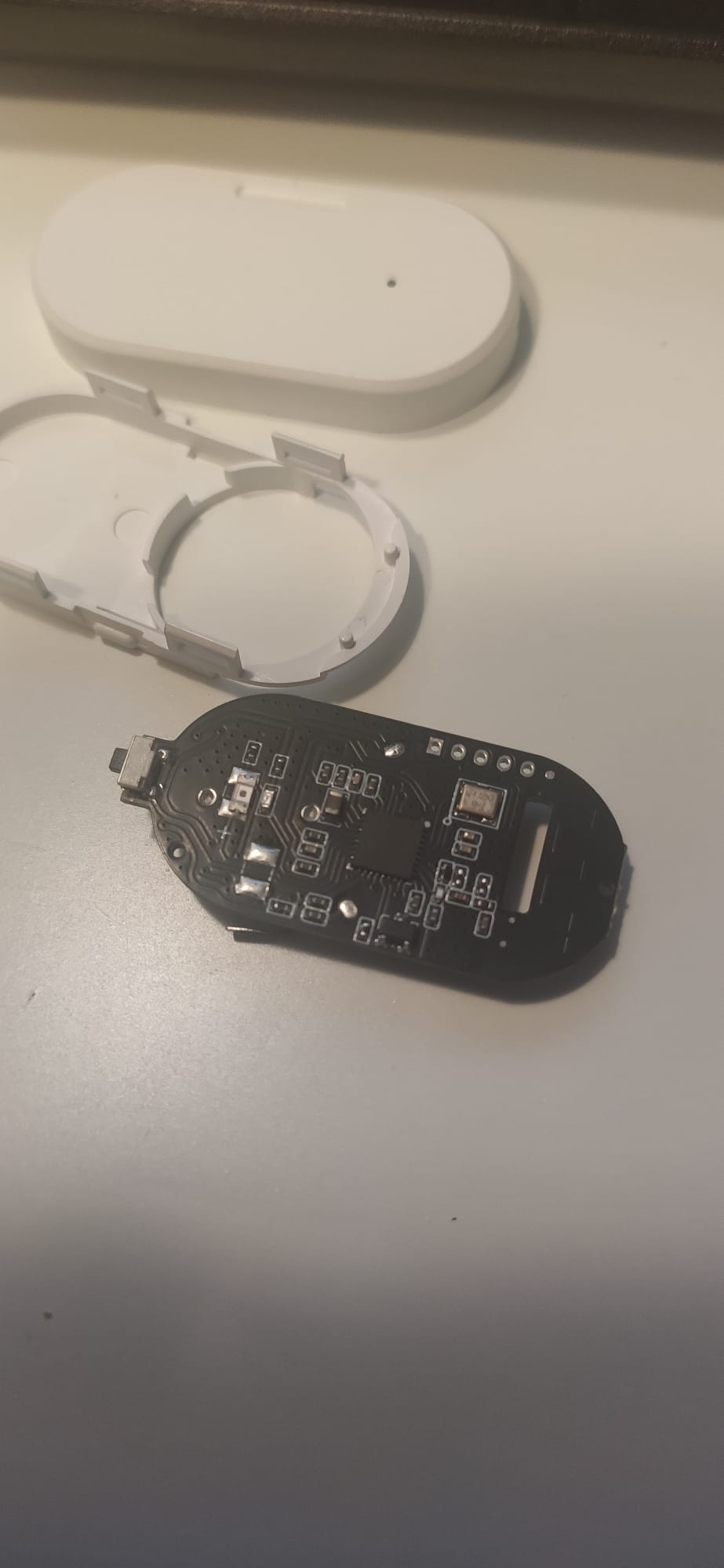

After your mention i orderded this one, because when i checked the link in the startpost won’t work (it seems to be fit). But can you place a picture or tell me where to solder the cable
I can only recommend the Aqara, no experience with other sensors. But what you could try as well is the non-soldering method some people in this thread used. They just placed the sensor in the case at the place where the original board was.
You have a door sensor that uses a hall effect sensor rather than the more basic reed sensor. You can still modify these but it’s a little more effort (see here or here).
It’s probably worth doing the non solder method like parrel suggested.
Thank you, I will check your posts. I still hope to here from @peggleg how he fixed it with his mentioned sensor.
It fits perfectly, but because of the magnetic on the the top of the flip causes that the flip is attracted to the door sensor, so it flips not easily anymore. And somehow he got it working, so I am curious.
