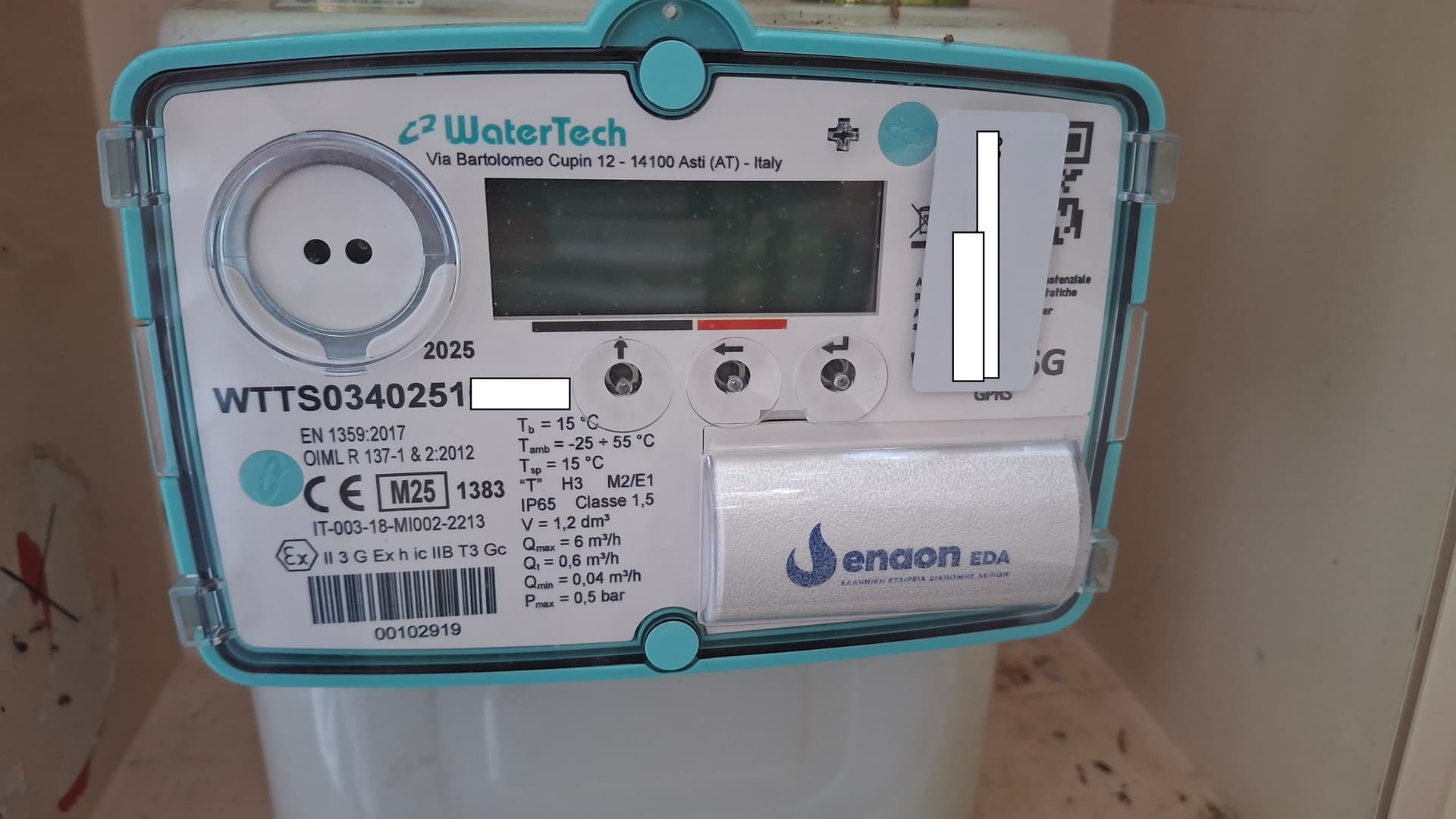

Last but not least, we also have the smart Gas meter shown below:
Can anybody help on the type of plug required to connect ESPHome to the meter and which component could be used, with or without addition of extra hardware?

As for the gas meter, I asked if anyone knows the kind of connector (and/or interfaces) is required to connect to it and retrieve similar information (consumption etc.)

Many ir-ports are programmable to output pulses/data/nothing. Yours has two windows. So likely the cable connects to that.
