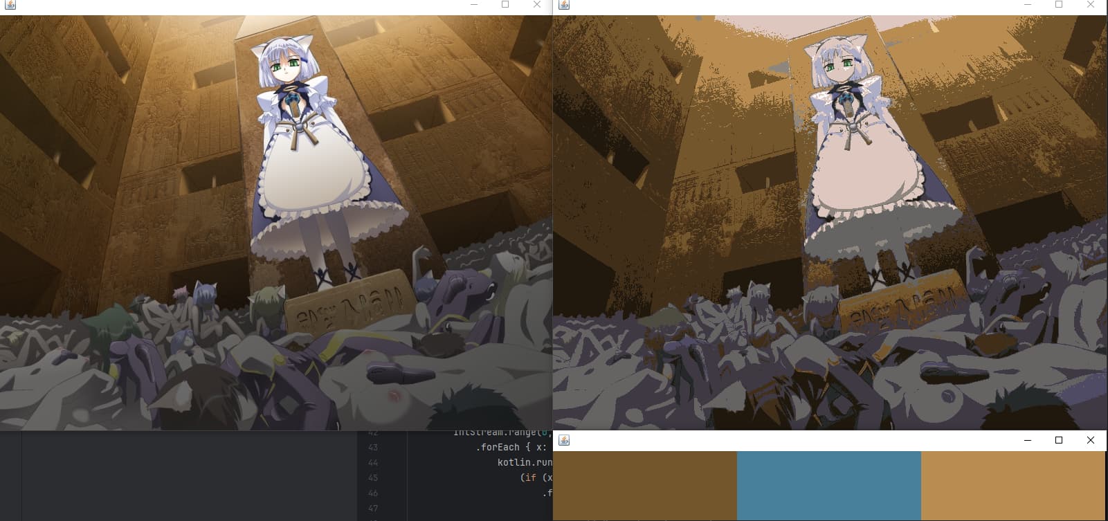

For my computer lightshows, I have previously implemented a dominant colour finding algorithm from a paper, looks like this;
This paper used LAB colour space since was better for human colour perception or whatever. For emissive light sources, L*u*v* colour space is supposed to be better, so I’m thinking to implement it like that instead of LCH.
Any strong opinions on this? Would you guys need this to be configurable? Now is the time. :slight_smile:

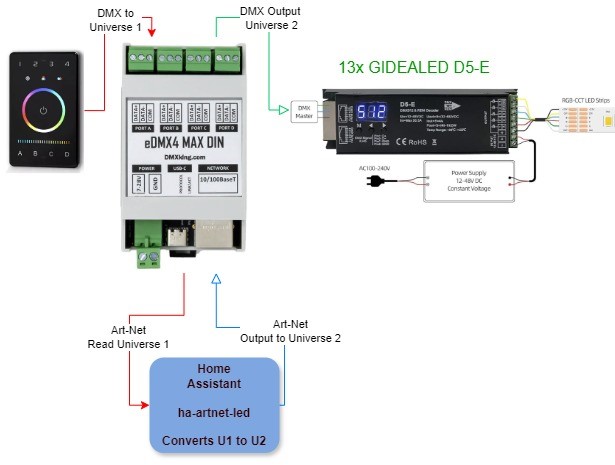

Your UB5 is unable to control more than 4 light zones. Besides this, it will repeat itself over the entire universe. This means that if you put your lights and this controller on the same universe, your 1st and 5th light will be the sane, your 2nd and 6th, etc…
The only way you can have control over more than 4 light zones locally (without HA’s involvement), is with multiple UB5’s on separate universes (option A).
Alternatively, if local control isn’t mandatory, option B lets you read your UB5, and enables you to do whatever you want with this data, such as turning on specific light zones. Option B holds that your DMX Input and DMX Output are on separate universes (because of this repeating problem).
The sACN priority system is for merging signals on the same universe. With option B (=non-local control), this isn’t necessary since you need to be on separate universes anyway. With option A (=with 4 UB5’s), this does matter.
I don’t have an ETA on sACN 2-way, but sACN with priority will probably be done somewhere this year. At least this way, you should be able to override the data that your UB5 is spewing out (but don’t yet get the state inside HA).

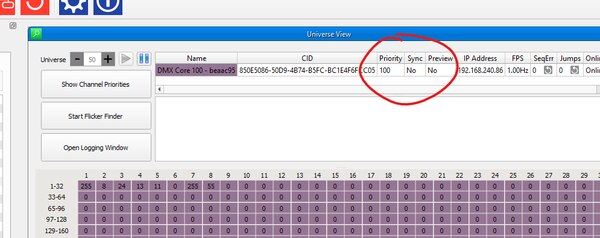

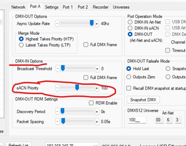

I spoke to the owner of DMXking, he says we just control sACN Priority on the DMXking device input port, like in the screenshot. He said sACN always has a priority built into the protocol, the only issue would be if you hardcoded it in the add-on.
sACNview…
I do like Option B if I understand it… Are you saying your add-on reads DMXking device to “grab” the UB5 output going into ‘Universe 1’ and converts that into commands for ‘Universe 2’?
Yes, that looks right! :slight_smile:

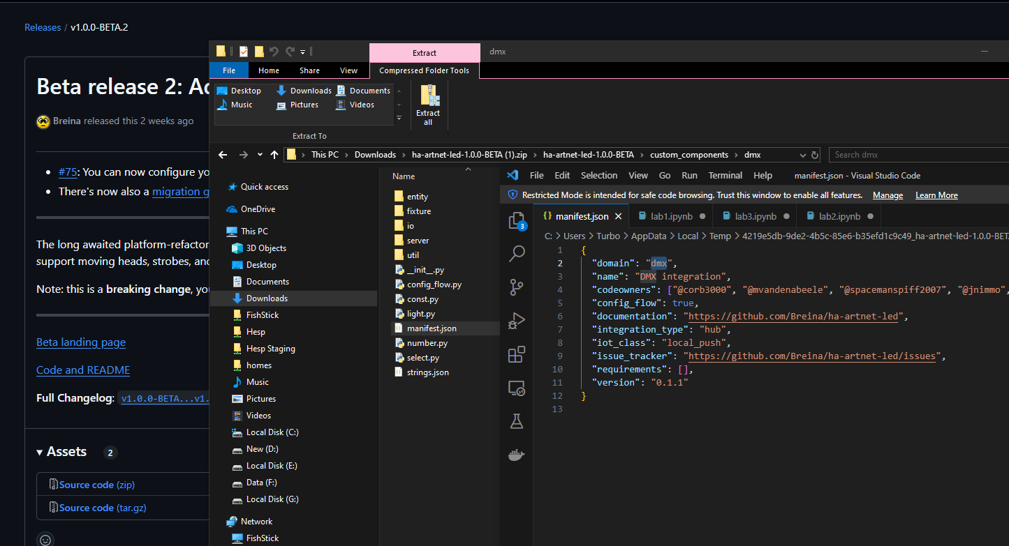

It looks like the source code zip for the Beta-2 release artifacts on Github is pre-refactor. It still has the old artnet_led manifest and the wrong directory structure. I checked further and it looks like the wrong branch is being tagged.
No that’s just you. :stuck_out_tongue:

Option B: put HA in between the UB5 and your lights. This would connect the UB5 to an Art-Net Node’s DMX input, the other lights to that node’s DMX output (thus at least 2 DMX ports), and HA connected to the Art-Net in/output. This way you are able to read the input from your UB5 and use it for automations, whilst still being able to control your lights through HA.
