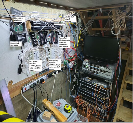

No update yet on 16bit. I’ve been working on infrastructure in my Structured Wiring Center. Basically moving from proof of concept to deployment, but haven’t tackled the 16bit dimming yet.
What I have done is a Power-over-DMX on Cat5e system using passive PoE (Mode B) injectors so I don’t have to run separate DC power to the D5-E drivers. Inside each D5-E a jumper wire connects pins 7/8 to GND and a Schottky diode connects 4/5 to V+. Pins 1/2 carry the DMX signal. The hacked drivers can run off PoD or the normal power connection.
I got a pile of ceiling recessed CCT pucks and connect the D5-Es to the LED strings inside. The PoD voltage varies depending on the fixture. 6" pucks from Lowes need 41V. 4" pucks use 34 volts. Strips generally use 12V and panels use 24V. So there are four power supplies, five PoE injectors and four DMX splitters with a patch panel so I can mix 'n match voltage DMX King outputs on a per fixture string basis.
The main limitation is electrical code compliance. Each injector is limited to 100W total. That would be five 6" pucks total across the eight injector ports. Fuses on the power supply outputs enforce this.
This is the panel without the final power supplies but everything else. The supplies themselves will be enclosed.

So it’s DMX right now, but that’s really a bridge until I can deploy true PoE powered Artnet LED drivers. Technology moves so fast it looks like that may happen much sooner than I expected. I have yet to find any residential-class (i.e. inexpensive) units so I’m going DIY. I may even have some prototypes going in the next month or two. I can use the same PoE RP2040 MCU I use in my wall switches to drive dimmable MeanWell CC LED driver modules that run off 57V Vin. It’s almost like LEGO blocks now. Single Pair Ethernet can carry 30watts and is multidrop, so that may make sense in some places. But, I’ll keep pure DMX for the higher power lighting.
After I make the switch most of the ratsnest in the picture will go away. Thanks to the HA/Artnet integration however I think the migration will be pretty smooth.

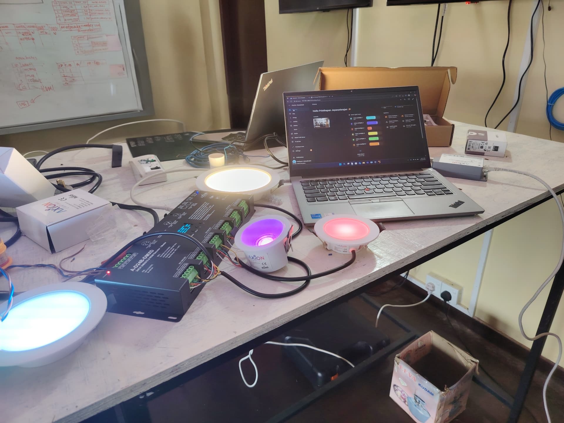

I’ve tested Axion DMX Controller with the integration. Everything works fine. In order to ArtNet work with this DMX controller set the ArtNet Universe to 1. I’ve also managed to contact the manufacturers regarding the DMX controller. They said for now only one Single DMX Universe will be controllable via this Controller. So, if anyone is using this DMX controller with this integration it will work.

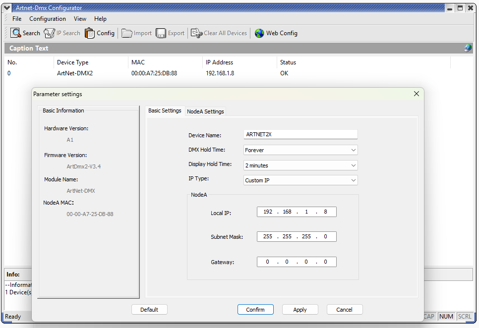

Installed a Artnet device, gave it a IP adress and i can test it from my computer. 1 DMX ledpar was installed. So far so good.
Now i am trying to use the HA Dmx integration.
Followed all the steps that i found in the HACS Art-net LED Lighting for DMX

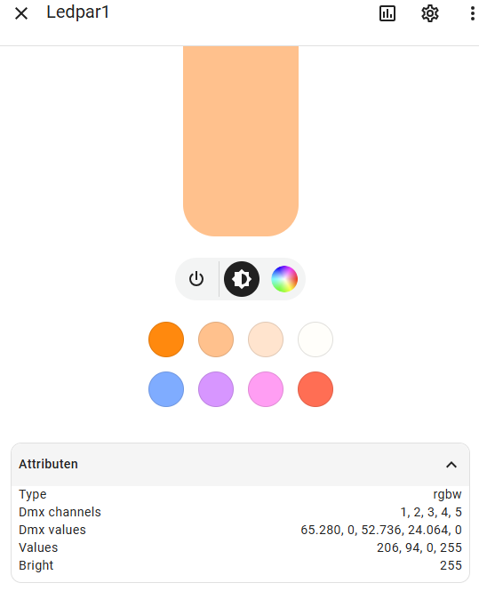

Finaly i succeeded to conect my Artnet Device tot HA and ca now see a entity i created.
But, this Ledpar does not respond the way i want.
The DMX device has 6 channels
1 dimmer
2 strobe
3 red
4 green
5 blue
6 programms
how can i put this in my configuration yml file?

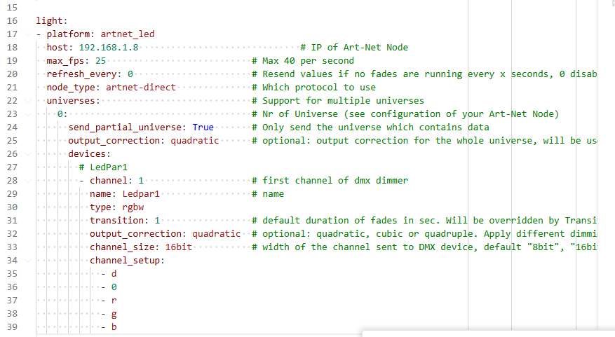

This is what i tried.

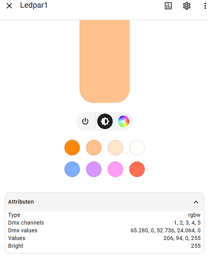

and this is the result
but as mentioned, the collors i choose are not the ones i see on my device
Who can help me out?
And solved… partly…
It seemed that the Chanel _Size: 16bit was not the correct choice. When i put that on 8 bit the Ledpar responded as expected.
So now i have my RGB and the dimmer working .
