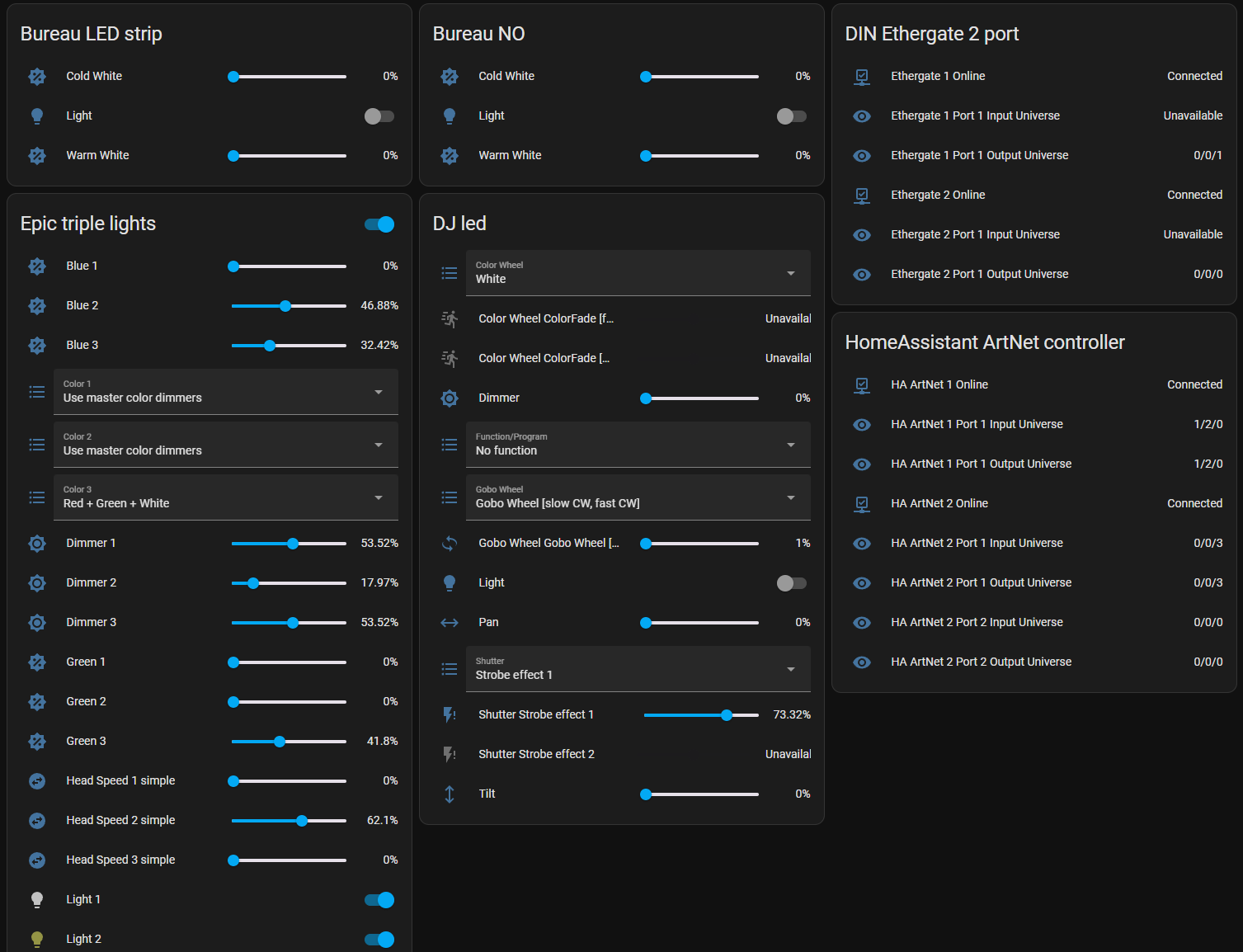

The current live version only supports lights because of the limitations of the old fixture definition format.
This is supported in the BETA however. It’s much more flexible with that you are able to define. Besides the lights you have now, you get additional number entities per channel, which adds your strobe.
Example of how it could look:

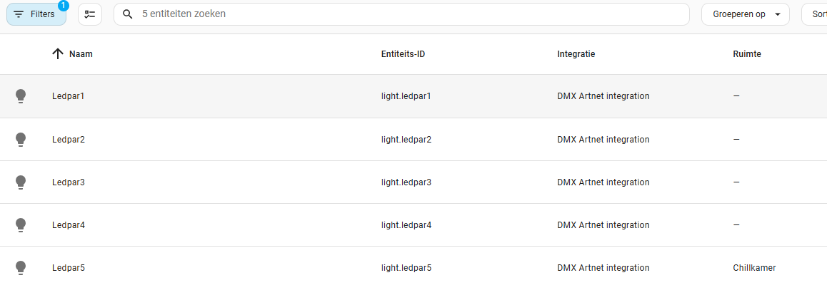

I added a new device but is isn’t showing in the Artnet items or as a new entity.
started HA again, cleared front cash, so what else can i do.

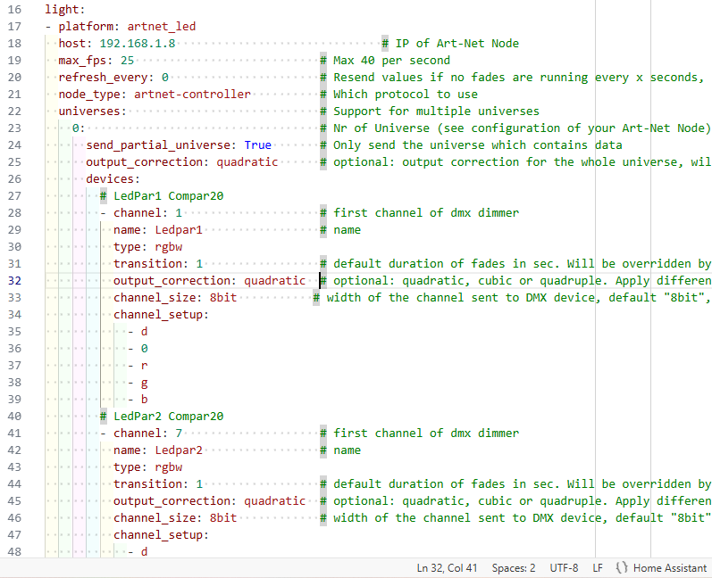

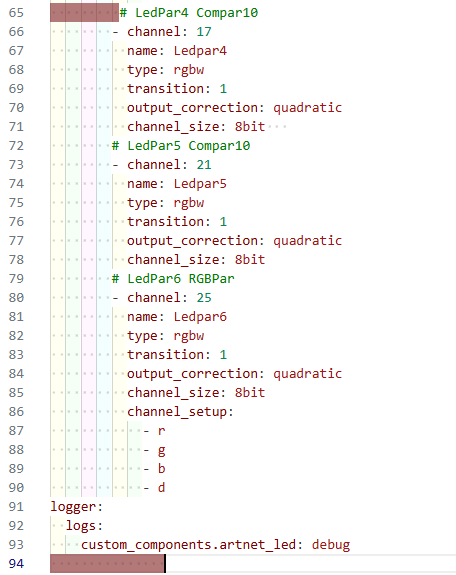

here is the code
and this is what i see so the last device is not shown

This does look correct. After a restart, your new entities should appear. Does anything show up in your logs?

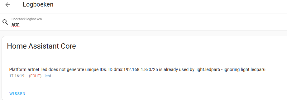

Breina, thank you to take time to look into it.
If i search in the logfile for the Par6 it is not shown. Is there something else I have to look for in the logfiles?
HA has been restarted a few times but no result.
Is there something else I have to clear first? I think I use the right method to clear the cache but are not certain. Is there a way to check?

Then restart. Search the logs for artnet_led, check ‘Show raw logs’, then you’ll get all the logs that we’ve got. Surely it’s got to say what’s wrong.

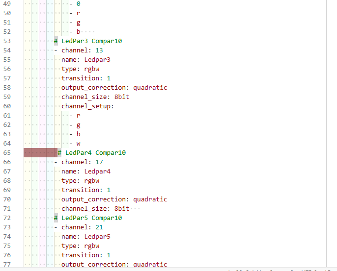

resulted in this error
This is strange becouse as you can see in the yml file the dmx channel for ledpar5 is set to 21 instead of 25.
I changed this on the ledpar6 device and in the configuration to channel 30 and now it is recognozed in HA as the entity ledpar6.

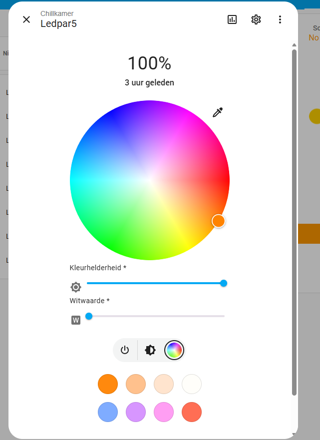

the ledpar 4 and ledpar5 are both Ayra Compar 10 devices, both set to a 4 channel DMX setup.
Dimmer - Red - Green - Blue.
But the ledpar5 shows other collors than picked in HA on this lightcard
The ledpar4 is ok.
I don’t see a difference between the 2 devices.
Anny suggestions to fix that?
