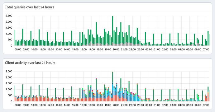

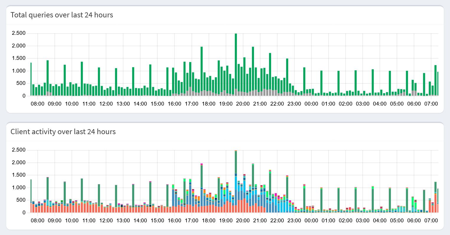

This is happening nearly every (full) hour 24/7 (UDP port 53 to the gateway, redirected to the internal DNS Server (Pi-Hole)).
