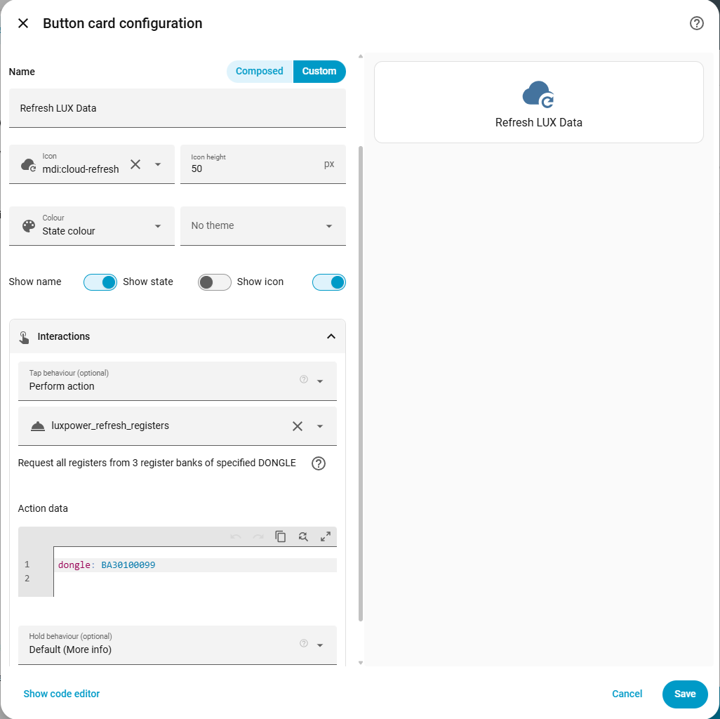

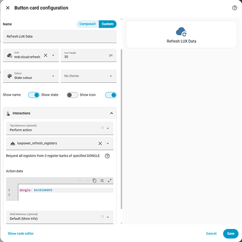

The yaml for the refresh button card is this:
show_name: true
show_icon: true
type: button
tap_action:
  action: call-service
  service: luxpower.luxpower_refresh_registers
  service_data:
    dongle: BA30100099
  target: {}
entity: ""
icon_height: 50px
icon: mdi:cloud-refresh
name: Refresh LUX Data
show_state: false
Does that help, it's greek to me!
The data should be
dongle: BA30100099
And the domain is luxpower and the action is luxpower_refresh_registers
Pete, Thanks for that - it seems to work.
