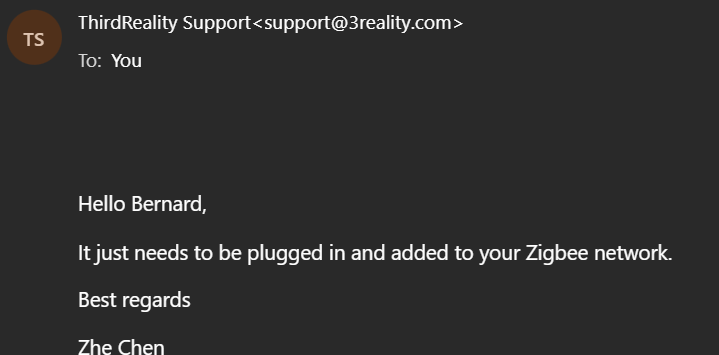

From Thirdreality support:
I would go by the official response you posted from Third Reality support.
I have their model 3RSP019BZ. It’s only on at 7pm - 12am, but even when it’s off all day, it always shows up as a Router in the ZHA Virtualization map.

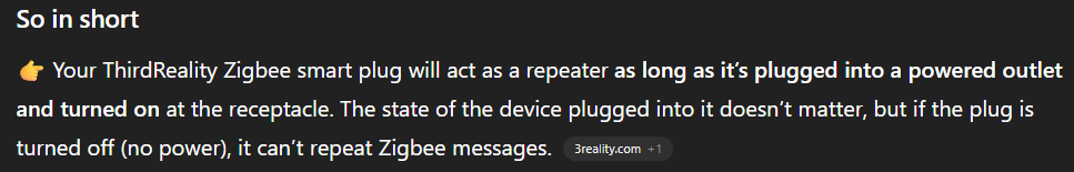

This is from ChatGPT. It says plugged in AND turned on to act as a repeater.
you are misunderstanding chatgpt. no device can repeat w/o power and in the gpt responce turned off = no power. That is not how we interact with the devices. As long as a repeating zigbee or zwave has power… plugged in or hard cabled… it has the ability to repeat. As long as the zigbee / zwave repeating device is is paired to a network it knows what to repeat.
If you have a repeating zigbee / zwave device that is not behaving like this… it is faulty. full stop.
We still have to be smarter then AI :man_shrugging:t3:
I completely understand, it says plugged in AND turned on though. Two separate actions. I understand how it works and you obviously understand how it works. I’m not sure why you’re not seeing the inaccuracy here.
This should help you see it for yourself. turn the device on/off all you want. you should see it’s still repeating in the UI.

I explained that I completely understand that it works (after pairing) by just plugging it in. It does not have to be turned on, just plugged in. Read the quote from AI again, it plainly states that it needs to be plugged in AND turned on to act as a repeater. It is obviously wrong.
Let me try again, the incorrect info from ChatGPT, which is what prompted this thread:

If you happen to have an outlet which is controlled by a wall switch, which used to be common in some places in the US, then that switch needs to be turned on for the smart plug to work as a repeater. Same as if it were a smart bulb in a switched light fixture.

Uh, I don’t take everything AI says was factual. Which was the reason for this post to begin with, and why I confirmed the facts with Thirdreality support. (See previous post).

No, it says it needs to be turned on at the receptacle.
That means the plug input, not the output.
In the US, that means any wall switches controlling the outlet need to be on so the plug is provided with power.
In other countries, there are switches built into the plug receptacle which do the same thing. Google “UK power socket” & you’ll understand what the AI is trying to tell you.

I didn’t, that’s why I sent email to Thirdreality support who clarified the issue. See my previous post.
