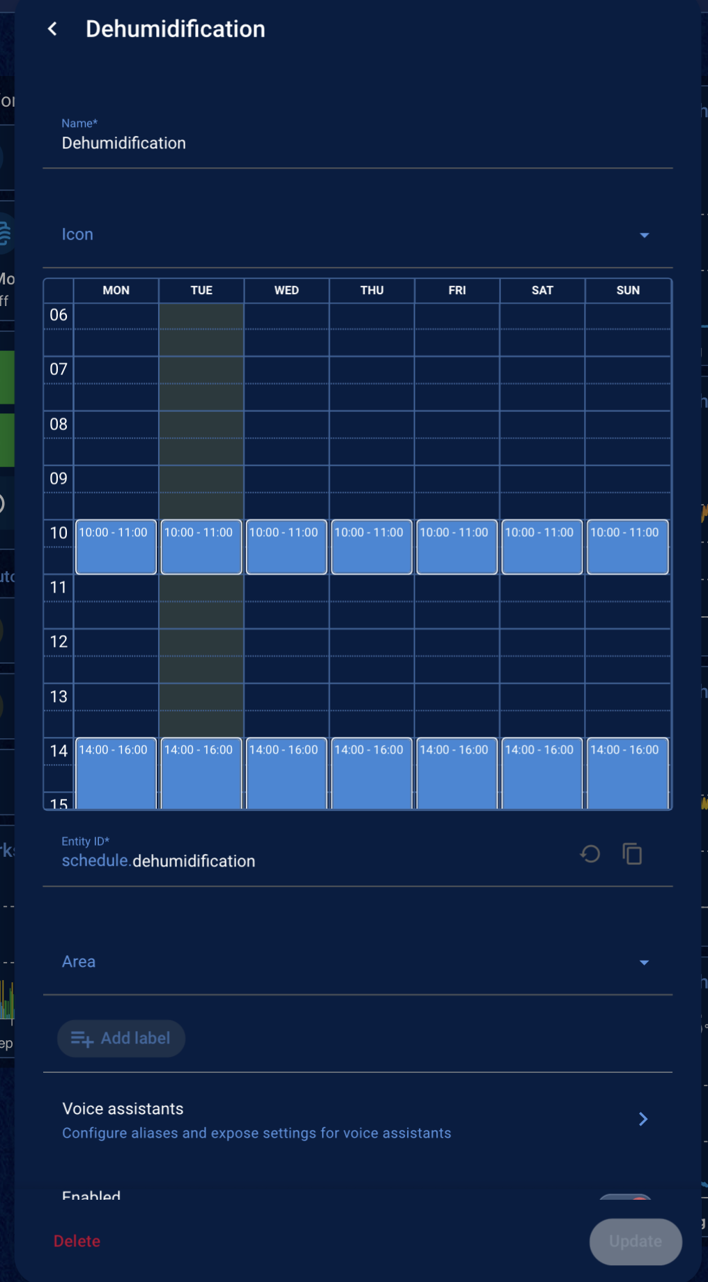

For example, I have quite a complicated automation that keeps an eye on my hotwater tank temperature and sets it to come on so that it is ready for a specific time. I am able to have two timers for each of the day of the week, all with different times.
I would have no idea where to start without using Node Red.

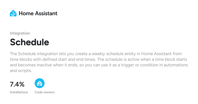

Set up a weekly schedule helper with the times required (multiple times available per day). Trigger when the schedule changes state (on or off) make your heater switch follow that state in the automation actions. Use temperature numeric state conditions if required.

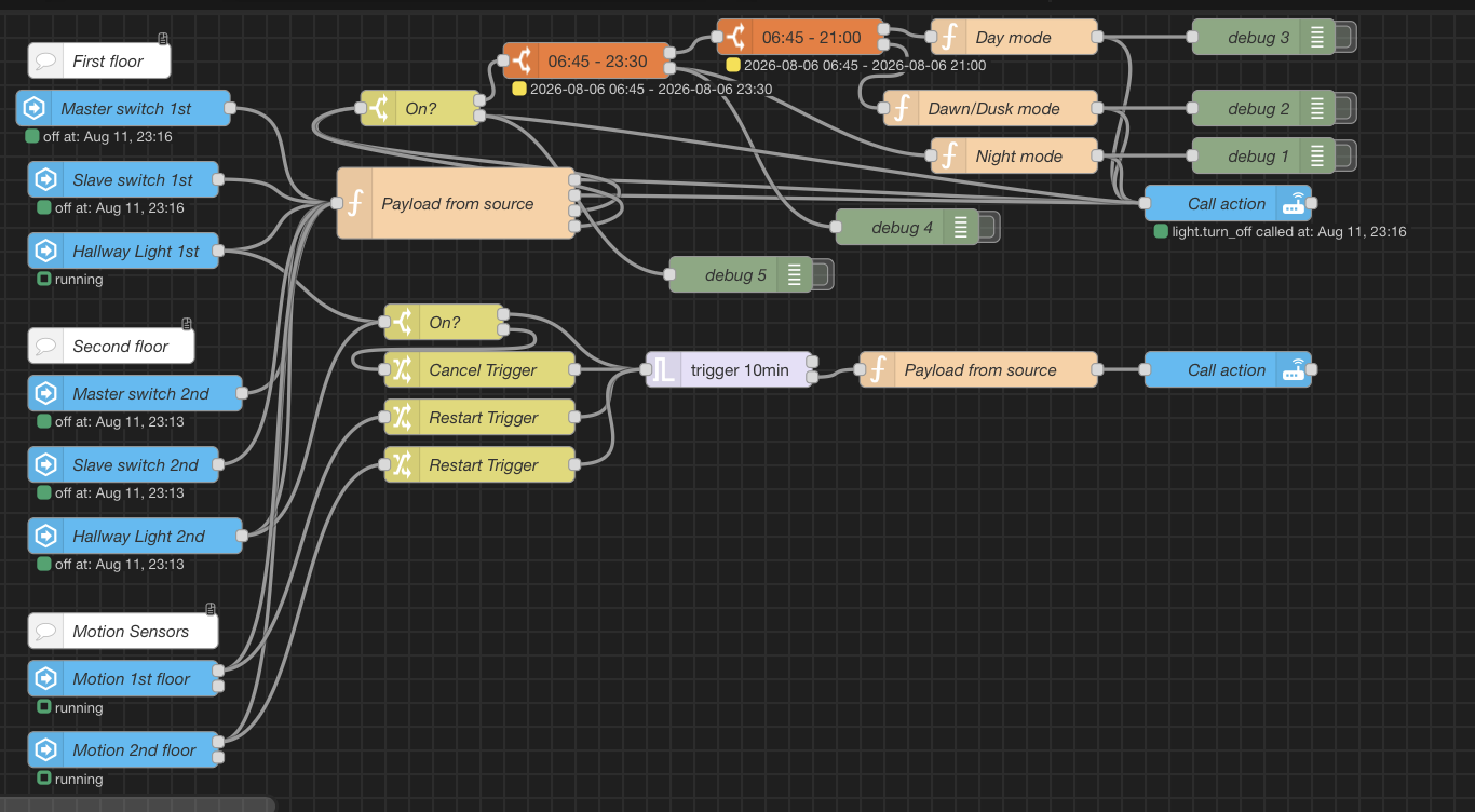

I use a single flow to control my lights based on motion in toilets and hallways; (2 toilets, 2 hallways), and it uses specific time windows to set a specific brightness (i hate to be blinded if i need to pee during the night); i guess I could transport it to HA, but I don’t think I would understand it anymore… (also because it does quite a lot by (re-€using the entities name)

FML, I did not know this existed. That can simplify quite a bit of my trigger/condition logic I think.
