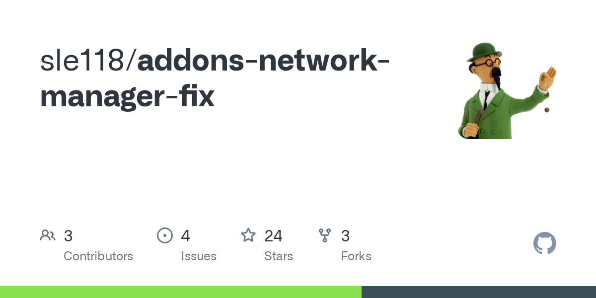

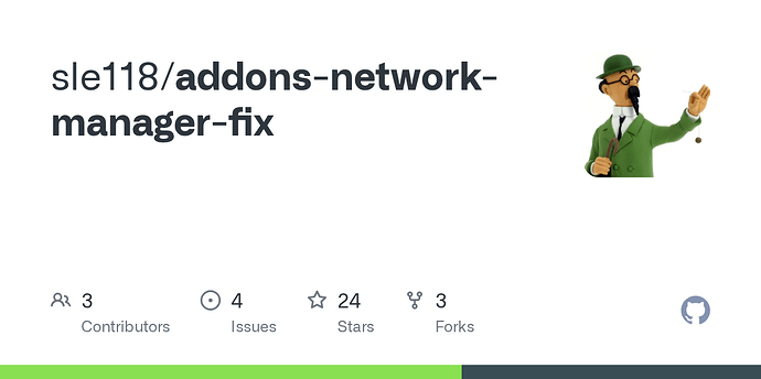

Looking into it further. Initially I used this APP to address the issue.
Of note, it appears there is a cli command that HA added since per this issue that supercedes the need for the app:
That "official solution" is news to me, and my "network manager fix" app is showing lots of
[08:10:26] INFO: no changes needed for enp0s18 (Supervisor enp0s18)

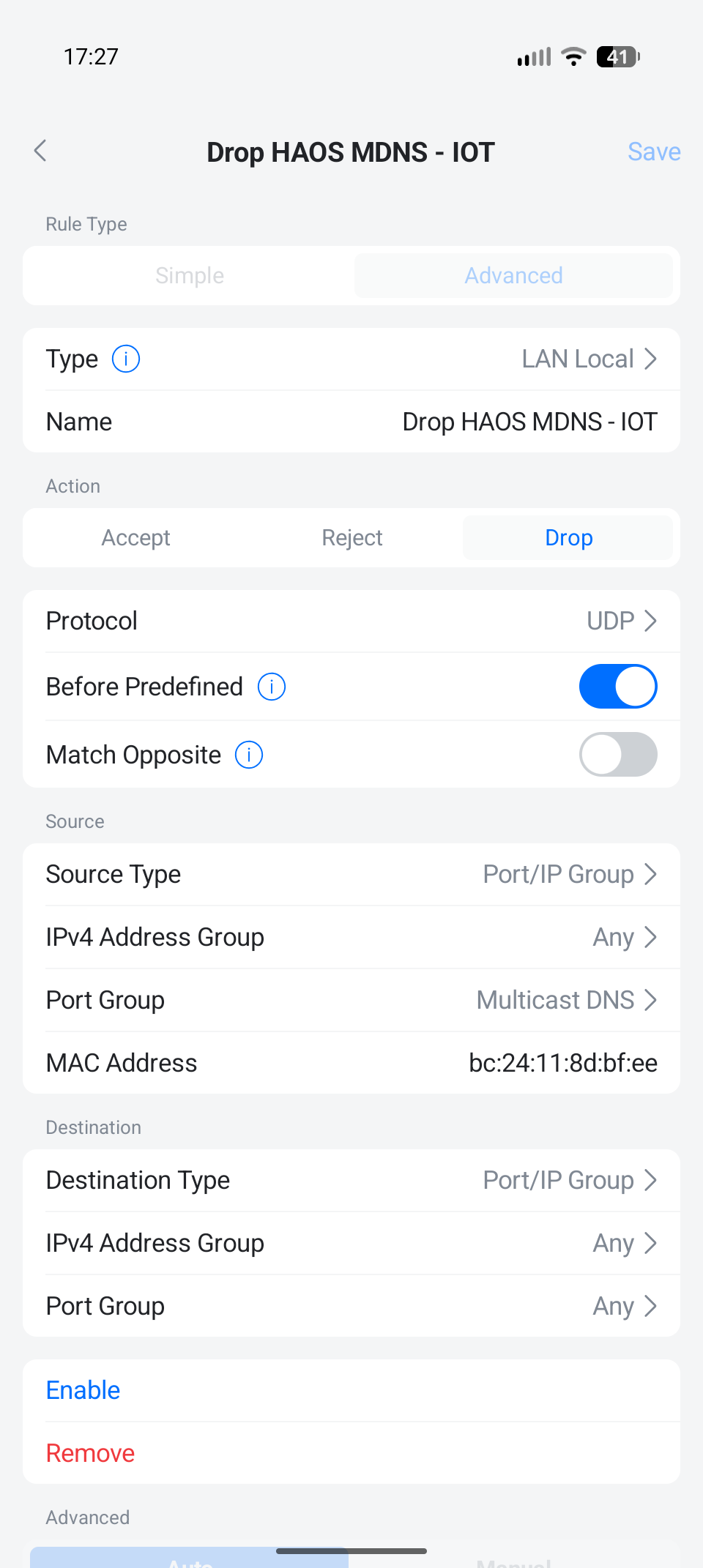

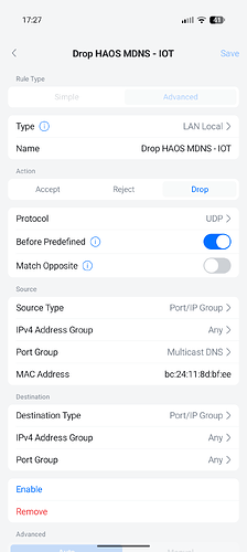

I just double checked firewall rules and while I have some set to block mDNS from the HA MAC address, they are disabled, so I'm not actually sure what "fixed" it at this point.

Firewall rules have no effect on Multicast.
It is like trying to empty your leaking row boat with a pair of tweezers.

No kidding. I was pretty sure it worked at the time, but then disabled them because it was causing some other issue down the road. Would it have made any difference if they were set up like this, on the LAN Local area?
