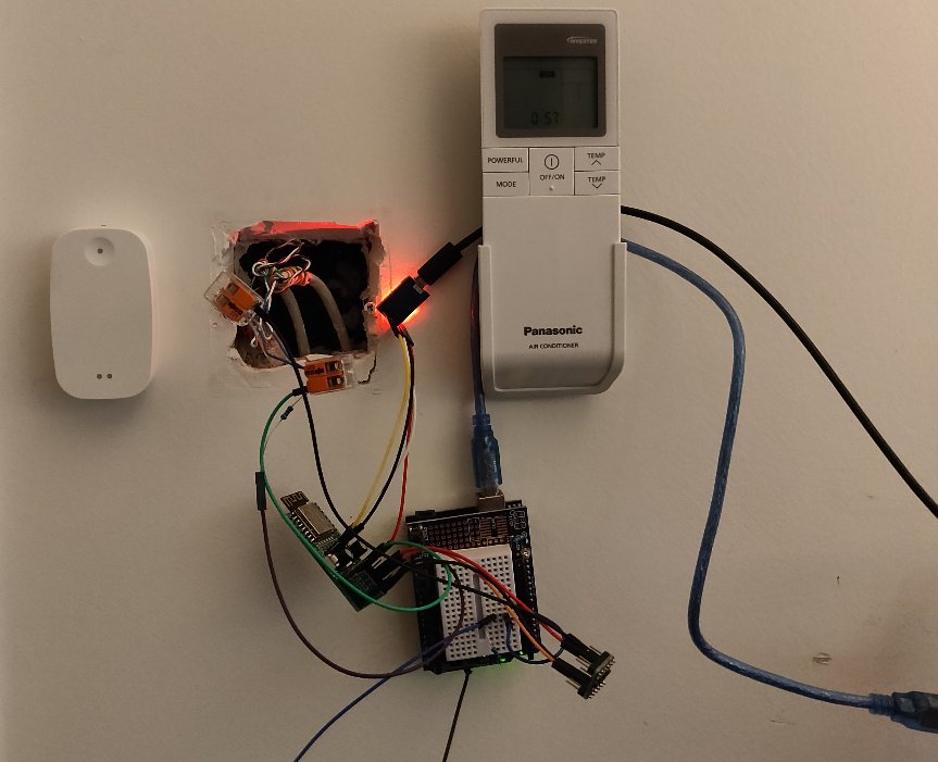

So far I have discovered (based on the work of wriswith):
The Dobiss button bus is just a Dellas 1wire bus (as expected), where all of switches are identified by a DS2411 (or possibly DS2401) Silicon Serial Number chip.
Closing the switch contacts somehow connects the chip to the bus, so they only appear on the bus if a switch is pressed.
This is different from what I thought initially (that all devices are some kind of GPIO chip, always on the bus), so when I was trying to get my ESPHome code to work, it never discovered any devices, since the bus is empty
I also needed a 1k pullup, not the 5k typically mentioned.
Due to this architecture, I think a custom ESPHome component will be needed, but I have good hope that should allow a Pico/ESP8266/ESP32 with a CAN bus adapter and a 1k pullup to replace the role of the master relay box.
My end goal is to have the basics (switch → relay) embedded in the single device, and have it work independently of HA, but still expose every individual user action to HA, so more complex automations can be done in HA instead.
