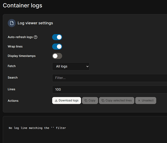

no log output:
only no IP address & Port numbers show on the Portainer:
