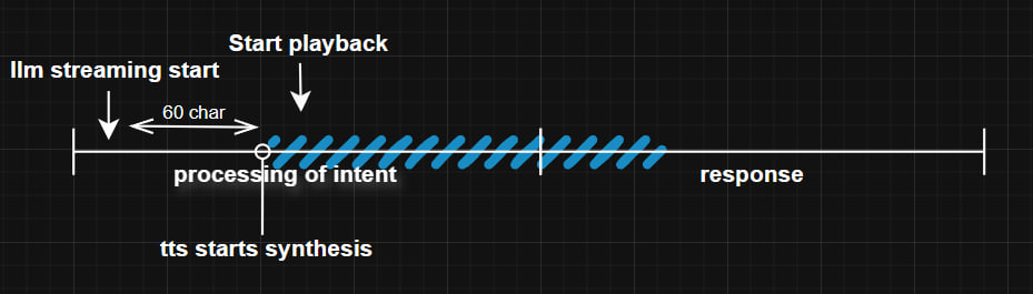

The diagram shows the expected behavior of the system. Try making a request in the web interface window first . There’s nothing new here compared to the previous version of HA, you’re just checking if Piper is running in streaming mode.
If everything works, repeat on the satellite. With new updates, it works in an identical way…

Streaming is primarily implemented for interaction with LLM (especially with local ones that do not have high token generation speeds). Ask the LLM agent to tell you something long and you will see that the voice response begins during the token creation process (see the diagram above).
Streaming is not enabled for short phrases (less than 60 characters).
