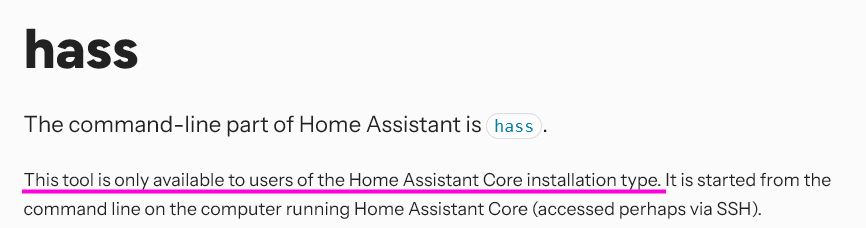

Documentation Updates
Before I create a Github issue from the ‘Provide Feedback’ link.
hass documentation link: https://www.home-assistant.io/docs/tools/hass/
Is the documentation relating to the CLI command hass still relevant? If it is not, I’ll submit a feedback but I wanted to make sure I am not missing something?
~ # hass --help
-bash: hass: command not found
~ # hass -h

If you have a supervisor and add-ons you are not running a core installation. You are running either Supervised or HA OS.
Your HA CLI reference is here: Common tasks - Operating System - Home Assistant
Is hass supposed to be run in the HA container itself or in the HAOS host? From your output I am guessing you are at the OS or supervisor level and some commands might need to be executed in the core container.
Some info found on GitHub - home-assistant/operating-system: 🔰 Home Assistant Operating System
Home Assistant Operating System uses Docker as its container engine. By default it deploys the Home Assistant Supervisor as a container. Home Assistant Supervisor in turn uses the Docker container engine to control Home Assistant Core and Add-Ons in separate containers. Home Assistant Operating System is not based on a regular Linux distribution like Ubuntu. It is built using Buildroot and it is optimized to run Home Assistant. It targets single board compute (SBC) devices like the Raspberry Pi or ODROID but also supports x86-64 systems with UEFI.
Neither.
It is only available for core installation types. They do not have containers or the Home Assistant Operating system. They are the HA core only run on a Linux system as a service. This installation type has been removed from the documentation as it will be unsupported after the next major release. The hass page has been overlooked for removal.
Ok check, thanks!
Aaah… that’s what I was missing. I was thinking HAOS was Core but that’s not the case. Thank you unmuddling that in my head! Glad I ask here rather than create an unnecessary doc feedback.
