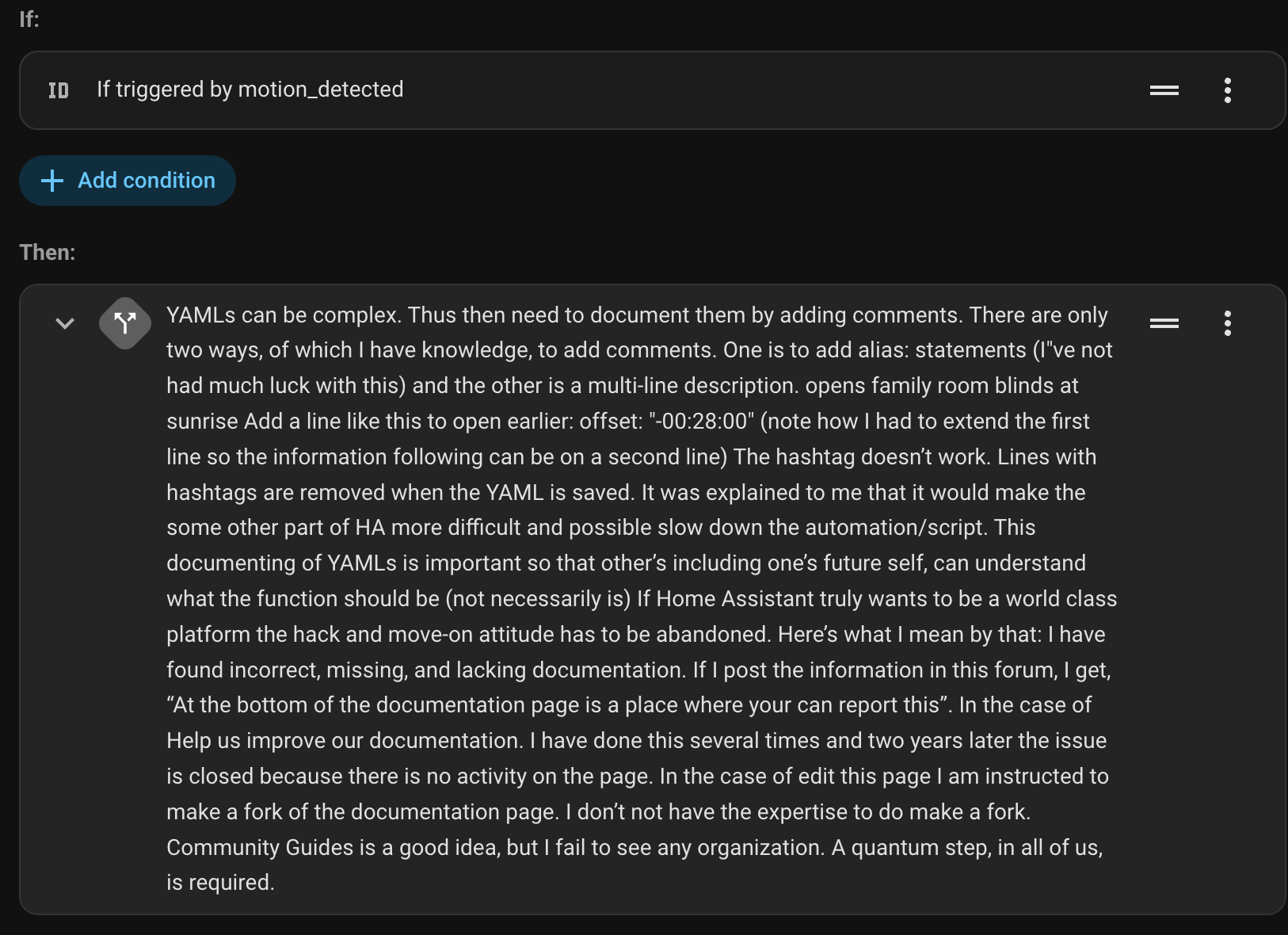

YAMLs can be complex. Thus then need to document them by adding comments. There are only two ways, of which I have knowledge, to add comments. One is to add alias: statements (I"ve not had much luck with this) and the other is a multi-line description.

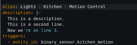

description: >
  opens family room blinds at sunrise                                    eol
  Add a line like this to open earlier: offset: "-00:28:00"
(note how I had to extend the first line so the information following can be on a second line)
The hashtag doesn’t work. Lines with hashtags are removed when the YAML is saved. It was explained to me that it would make the some other part of HA more difficult and possible slow down the automation/script.
This documenting of YAMLs is important so that other’s including one’s future self, can understand what the function should be (not necessarily is)

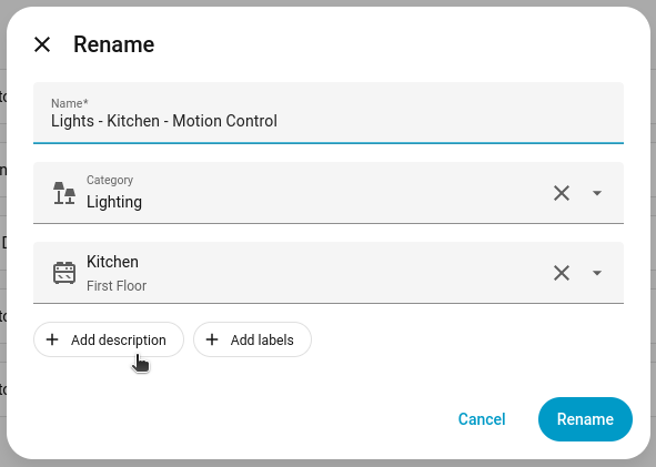

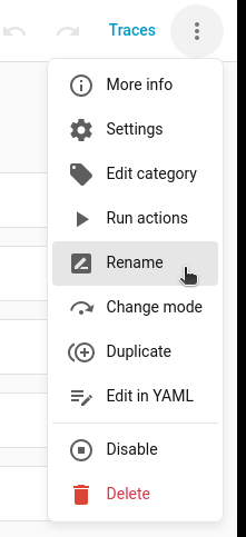

Use the Rename Option
Choose “Rename” from the breadcrumbs menu:

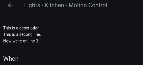

Select “Add Description” if there isn’t a description yet…

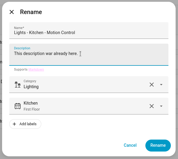

Or use the “Description” field to edit existing description:
